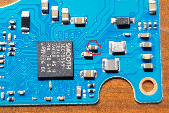

Hello friends of the HDDGuru forum, greetings to all !!!
I would like to know if any friend here on the forum has already encountered this problem, this ST4000LM024 after a few months of use stopped working, there is no clicking noise, but it has a continuous sound that gives the impression that the motor wants to spin but him can't!!!
I did the basics so far , I cleaned the 3 motor contacts both on the logic board and on the hdd case , I reassembled but the same thing continued , I made some measurements , one of them was measuring the motor coils , it seems to me a brushless motor in the triangle topology because it only has 3 terminals and the resistence gave exactly the same value of 2.0 ohms for de possibles combinations of mesurance, then i belive this motor is OK , then I went to measure on the logic board for try find something with problens of a short in the Driver IC of the Motor, to my surprise both measuring the resistance of 3 terminals of the connector on the Motor in relation to ground and measuring the resistance between the connector terminals all of them showed practically a short circuit (0.5 ohms)!!!
Could someone tell me if this is some peculiarity of this Driver Smooth by ST made for Seagate or if I really am facing a burnt IC ???
I would be very grateful for any help!!!
Follow photo below ( visually the Motor Driver CI has no signs of burning )

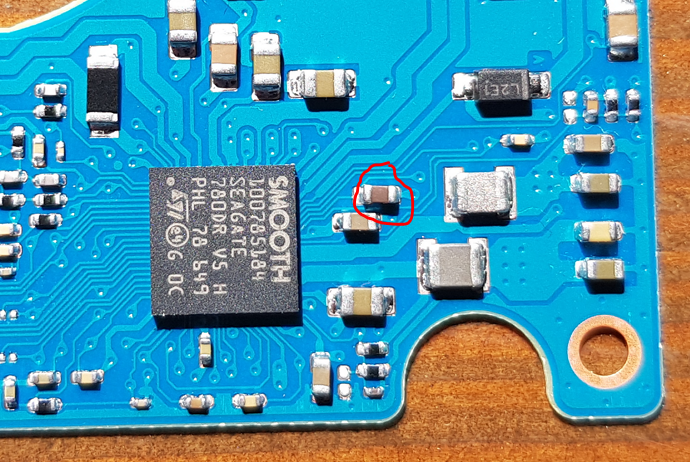

 Post subject: Re: Help me with ST4000LM024 ( Motor Conector Short )
PostPosted: April 28th, 2023, 14:02
Posts: 4753
Just measured a similar PCB and the motor contacts are shorted, the marked cap stores enough charge to keep the low side output transistor gates active, thus grounding the motor contacts. This is quite normal, your problem is probably stuck heads.

The output stages of the motor controller have a pair of MOSFETs on each phase of the motor. These are connected as a half bridge. I expect that there would be residual charge on the MOSFET gates, and this would turn on the D-S channels. If you let the PCB sit for a while, the gate charges should bleed off and the phase resistances should then go open circuit (I would think).
Hello friend, exactly that happened, I was measuring right after turning off the board, but even letting it rest for a few hours the mosfets were still connected, only after I went to each capacitor on the board and unloaded them did the motor connector pins rise the resistance above 100Kohms, so apparently the Driver is OK !!!
