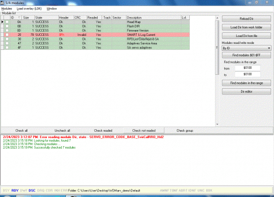

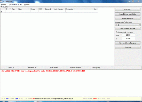

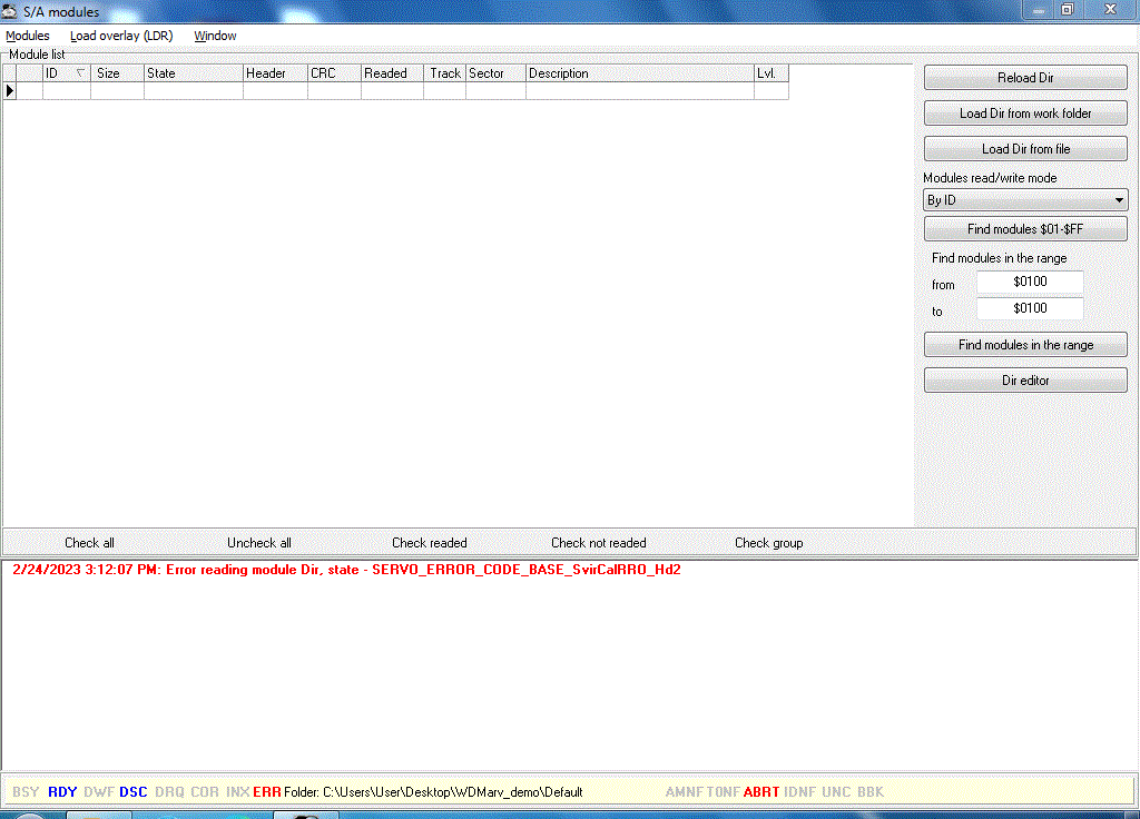

Here's what it's like when I just opened the S/A modules window with the donor HDD:
File comment: Displayed SERVO_ERROR_CODE_BASE_SvirCalRRO_Hd2

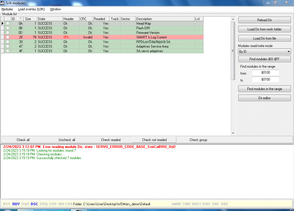

Here's what it's like after checking for ROM modules:
File comment: Like patient HDD, module 20 is highlighted red.
 Post subject: Re: Alternative ways to reflash ROM with SA-generated module
PostPosted: February 24th, 2023, 22:54
Posts: 16960
The donor is not functional, either. I can't understand why it's only reading the same module 0x20, though (the other modules are in the ROM). Can you upload module 0x20?

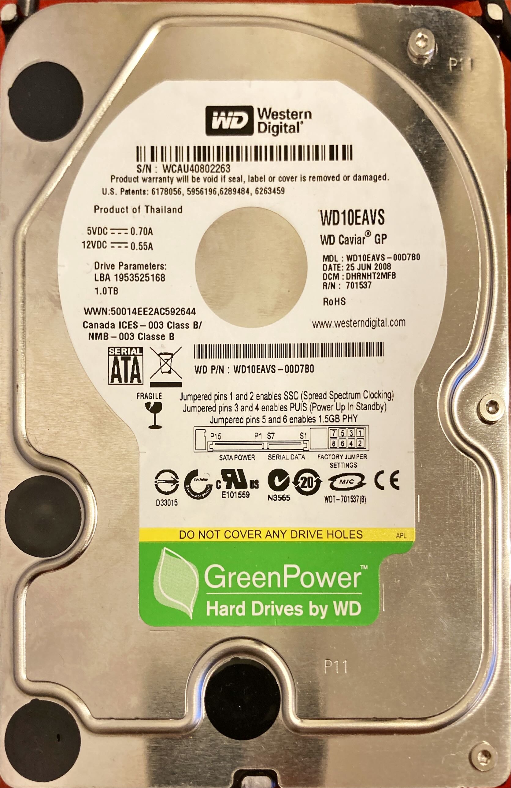

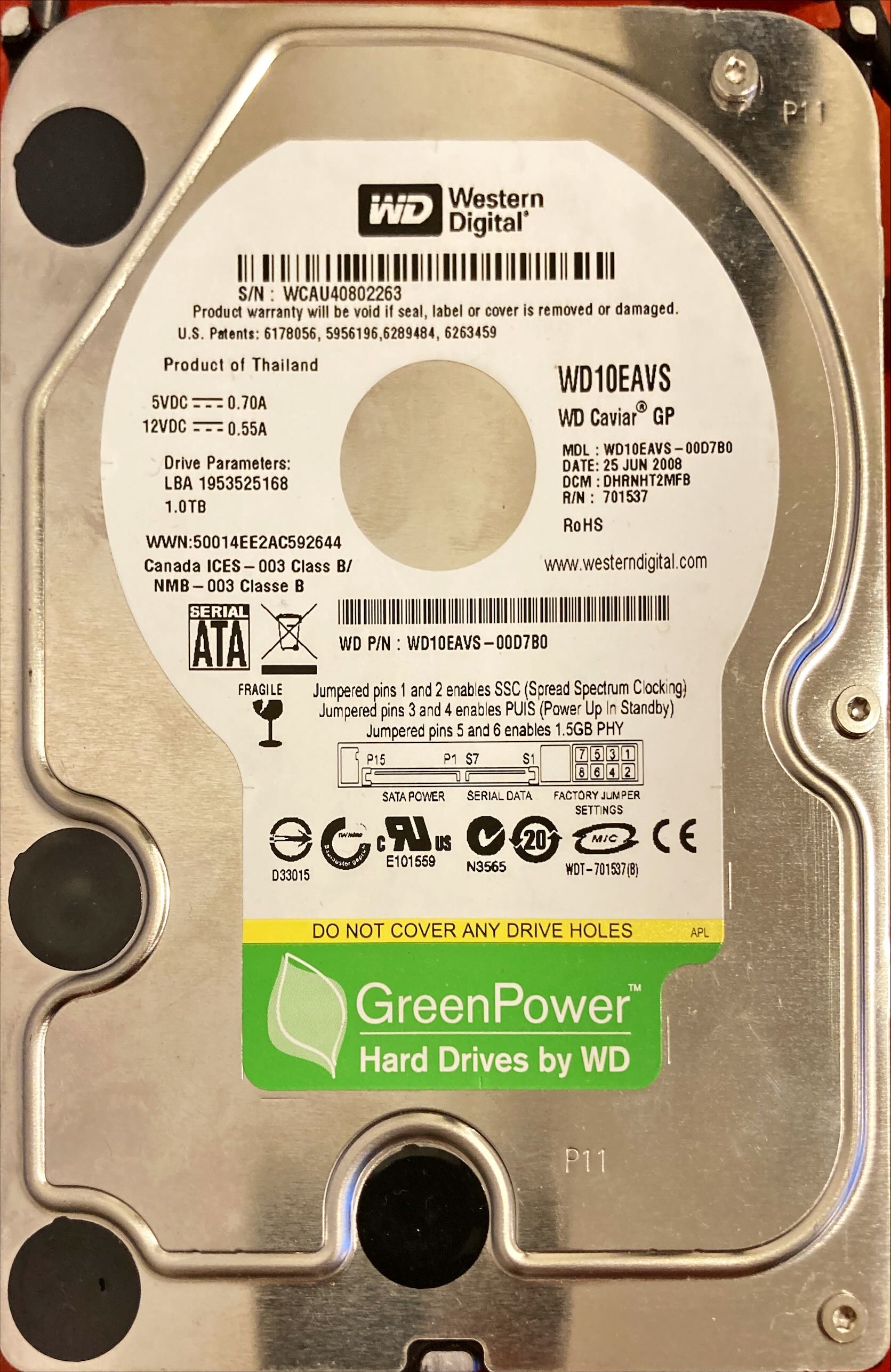

I recently obtained a functional donor HDD with working heads:
File comment: Functional Donor HDD

0x20 is the SMART related module on the PLATTER and you won't be able to read it with heads that don't read the platter or if other modules are not properly loaded.
Please do outsource this drive to a reputable data recovery firm if data is needed.
Continuing to "play" with it will kill it for good (if the head swap didn't kill it for good already).
The 2 links that i posted is to explain how to gain access to SA on drives with BAD SA but with working heads.
That SMART module is on the platter and if the heads are gone it will not be readable and it would be the least of you problems.
If you follow the procedures on the links and heads are still working you should be able THEN to read the modules on the platters including that 0x20 one. But if heads are bad it won't work.
You are not supposed to get that module at all if you can't get the others on the platters as well.

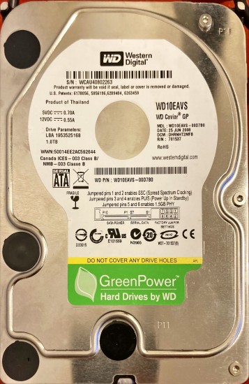

I see, however, I am doing HDD repair more like a hobby side project. I cannot afford to outsource any professional data recovery firm even if the facility is nearby. I am prepared for the outcome where I am unable to successfully repair the HDD. I recently obtained a new donor HDD, and tested and verified that it has functional heads.
File comment: Donor HDD
S/N: WCAU40802263
MDL: WD10EAVS-00D7B0
DATE: 25-JUN-2008
DCM: DHRNHT2MFB
R/N: 701537

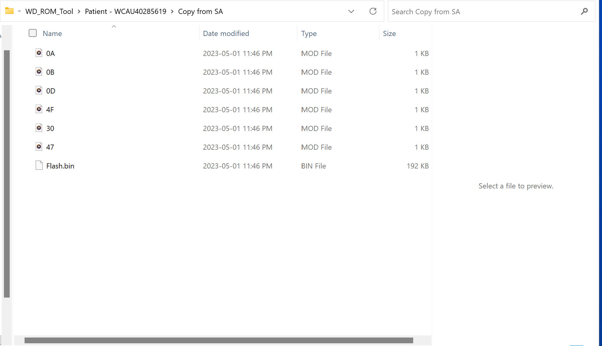

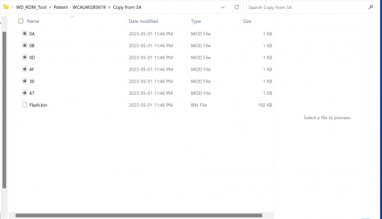

When I obtained the modules from WDMarvel, this is what it looks like:
File comment: Screenshot of folder content
This is what I attempted so far on another computer with a new folder location and after renaming the .mod files:
Microsoft Windows [Version 10.0.22621.1555]
(c) Microsoft Corporation. All rights reserved.
C:\Users\ostkk>J:
J:\>cd WD_ROM_Tool
J:\WD_ROM_Tool>wdROMreg.exe
This program regenerates a WD ROM using SA modules 0x102, 0x103, 0x104, 0x105, 0x106, 0x107 and 0x109.
The user must specify the source directory for the SA modules and the name of the ROM output file.
The program will look for SA file names and extensions such as 0109, 109, .rpm, .mod and .bin.
Usage:  WDROMREG dir=module_dir_path[\] romfil=rom_file_name
Example1:  WDROMREG DIR=C:\downloads\wd\firmware romfil=ROM.bin
Example2:  wdROMreg dir="d:\wd firmware\" ROMFIL="ROM 1.bin"
J:\WD_ROM_Tool>wdROMreg dir="J:\WD_ROM_Tool\Patient - WCAU40285619\Copy from SA" ROMFIL="WCAU40285619.bin"
SA module 0x102 not found -- program aborted.
SA module 0x102 found at 102.mod
SA module 0x103 found at 103.mod
SA module 0x104 found at 104.mod
SA module 0x105 found at 105.mod
SA module 0x106 found at 106.mod
SA module 0x107 found at 107.mod
SA module 0x109 not found -- program aborted.
J:\WD_ROM_Tool>
Since the program is looking for [0]10# (e.g. 0109.mod/109.mod), what is module 109? Is it a .mod file or is it a different file type instead?
