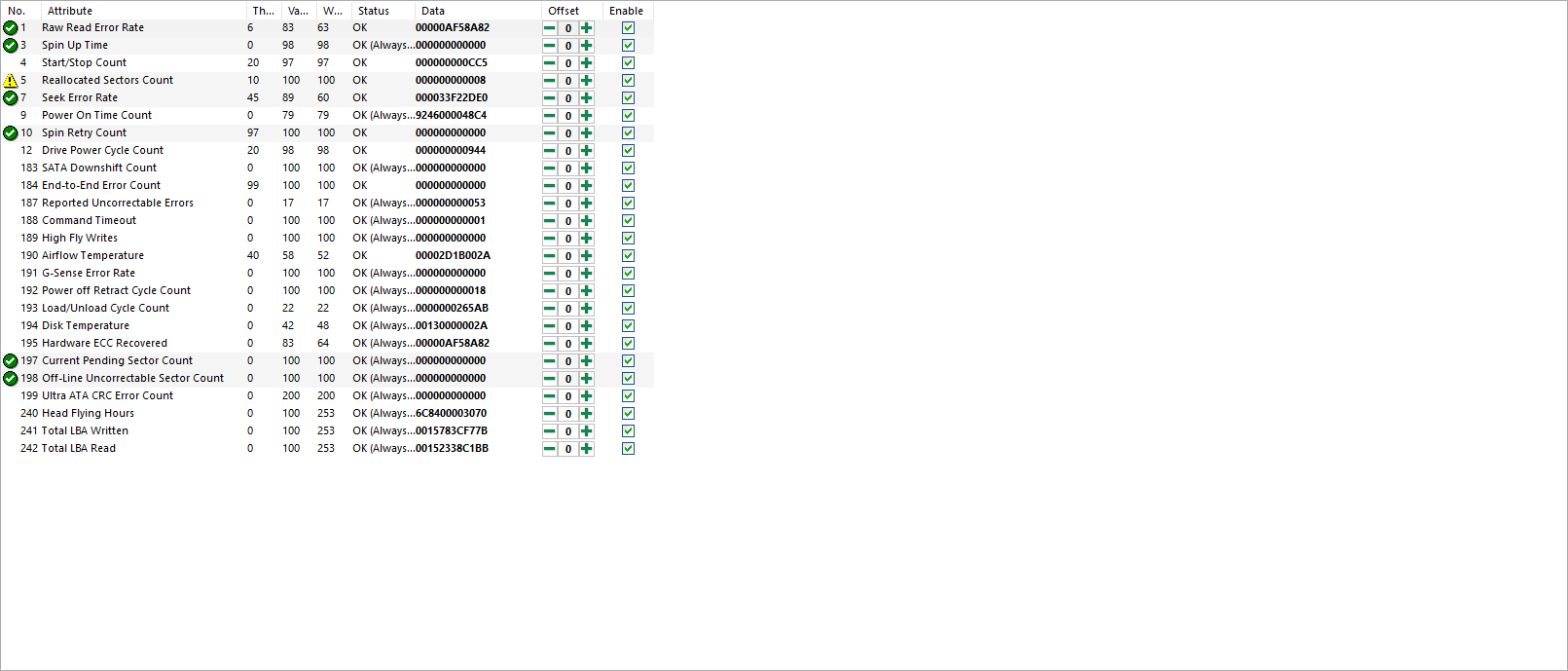

Did anyone ever come across this:
RAW value for attribute 05 is decreasing over time after initially increasing while subjected to a surface scan using Victoria.
Drive is a ST2000DM008 which is SMR if I am not mistaken.

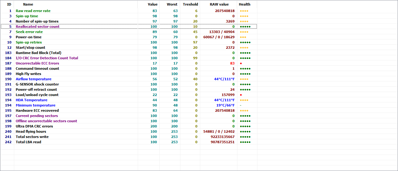

SMART one hour later
I am guessing / it almost seems like initially reallocated sector is 'unmapped' from spare and reassigned by the translator? Could this be what's happening?
