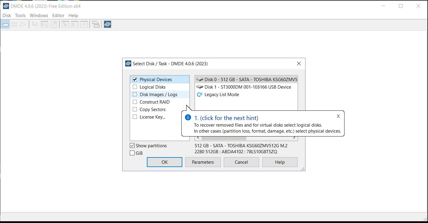

Thank you. I could not figure out how to run it in my Debian based Linux. So I will try the windows version. Thanks Again.

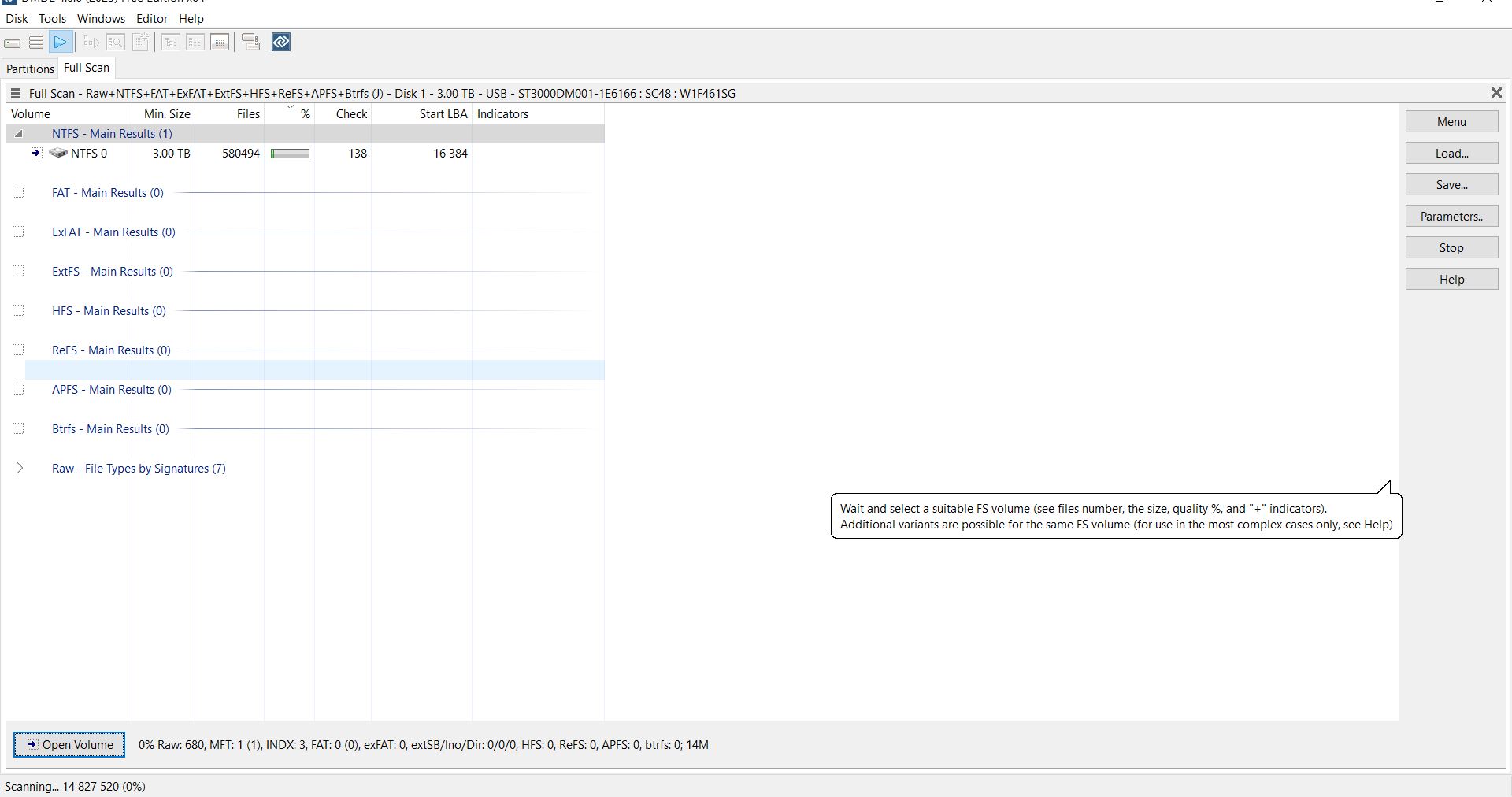

Actually, the software appears to be pretty powerful but perhaps not user friendly / newbie friendly. I am running it in windows. I hope on the correct part of the disk (it had some advice about that) I selected all file types.
attached screenshot is what it looks like
 Post subject: Re: mods how long does it take to be vetted ? my post please
PostPosted: December 31st, 2023, 19:30
Posts: 17230
In the initial Partitions tab, you should have seen your original NTFS volume. D-clicking that volume should have presented you with your file/folder tree.
Was the NTFS volume damaged? There would have been a 4K indicator of some kind, and the Indicators column should have shown "EBCF".
It looks like you initiated a full scan. This should not have been necessary, unless the file system was damaged.

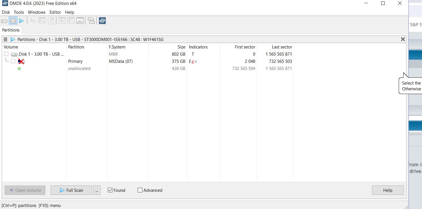

Attached is a screenshot of the initial screen after rebooting PC, powering down and back up the USB external drive (it is attached by USB).
I do no know what I am looking for or what to do.
Should we move these responses to the thread that I started for this issue even though nobody has or can help, apparently, it has been ignored.?
This thread was just begun to see how long it would be before that thread would get posted. I am really anxious, to get this solved.
Either there is data on the disk that is being hidden, so to speak by the block size change that you mentioned (somehing like block size change) or the disk has no data and I can format it.

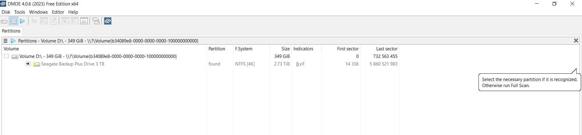

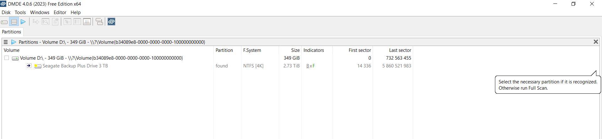

i moved further along... by one step I think. Here is a screenshot of where I am at:
which I believe is the stage you described where the HDD directory is shown. please see attachment. There is a previous response or two with screenshot
PostPosted: January 1st, 2024, 13:32
Posts: 17230

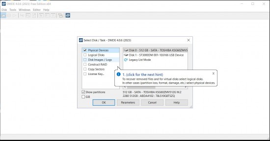

After you select Physical Disk 1, what is the first tab that appears?
Something like this ...
https://web.archive.org/web/20230522151849/http://www.users.on.net/~fzabkar/DMDE/DMDE_Elements-8TB_Partitions.jpg

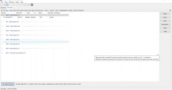

PostPosted: January 1st, 2024, 19:55
Joined: December 31st, 2023, 16:53
Posts: 13
Location: west coast us

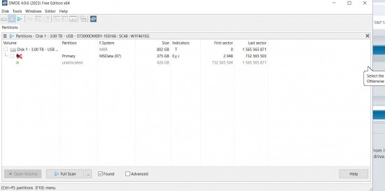

Thanks again.
are either of the attached screenshots what you are asking for ?

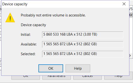

PostPosted: January 1st, 2024, 20:39
Posts: 17230
Now you've stuck the drive in an older USB enclosure that is affected by a 32-bit LBA limitation. That's why the reported capacity is 800GB.
    3 TB - 2 TiB = 800.98 GB
https://www.google.com/search?q=3+TB+-+2+TiB+in+GB
PostPosted: January 1st, 2024, 21:15
Posts: 13
Thanks again,
That is all that I have to try to read the drive.
I just don't know if there's any data on it or not. I'm not sure what my next step is. Do I need to buy another USB kit to attach it to?
Can we tell if there's any actual data on it at this point?
PostPosted: January 1st, 2024, 21:26
Posts: 17230
Attach the drive to a SATA port inside your computer.
Two of your previous screenshots indicate that there is an NTFS volume, but you won't be able to access all the data with this old USB enclosure.
