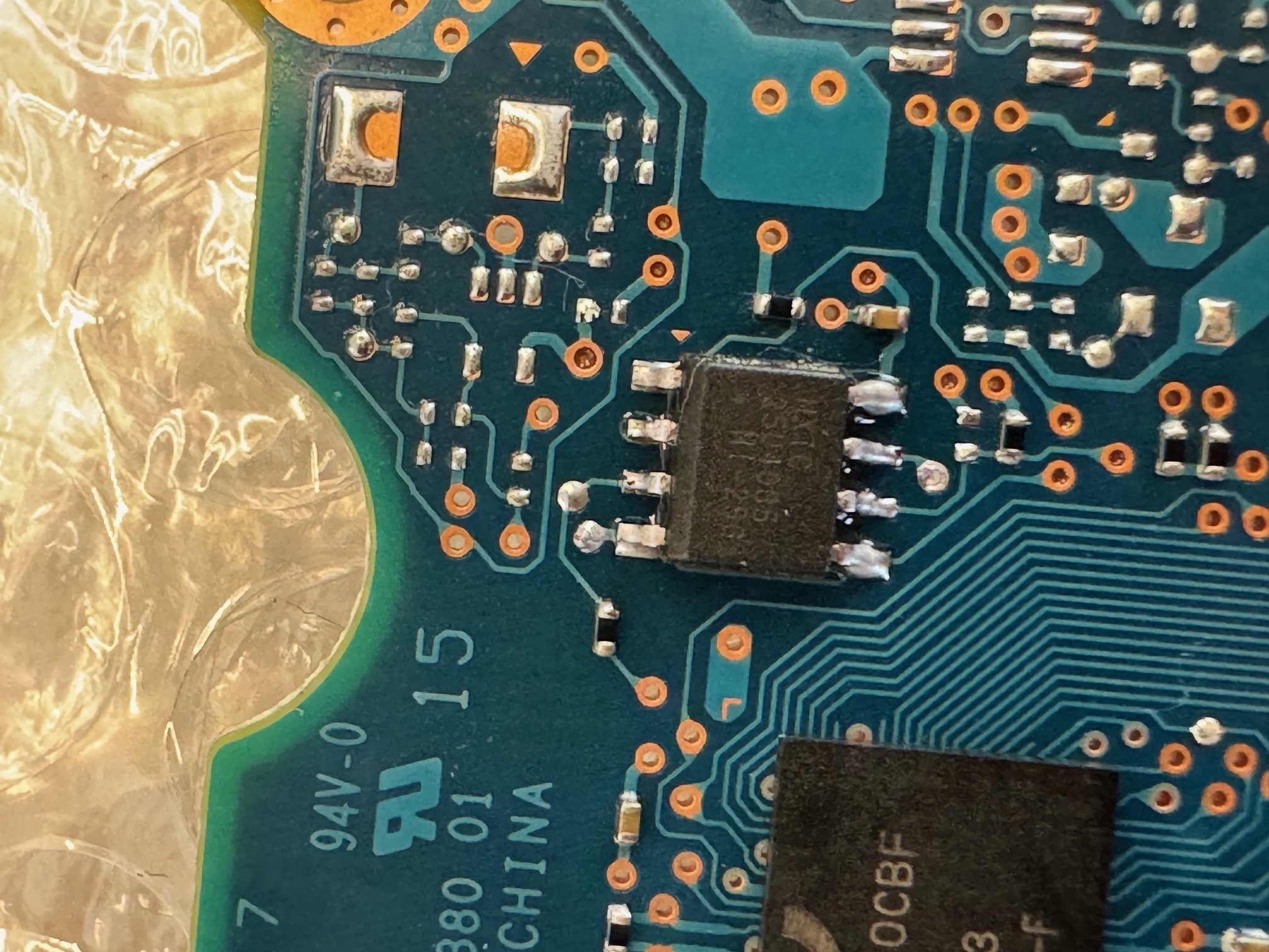

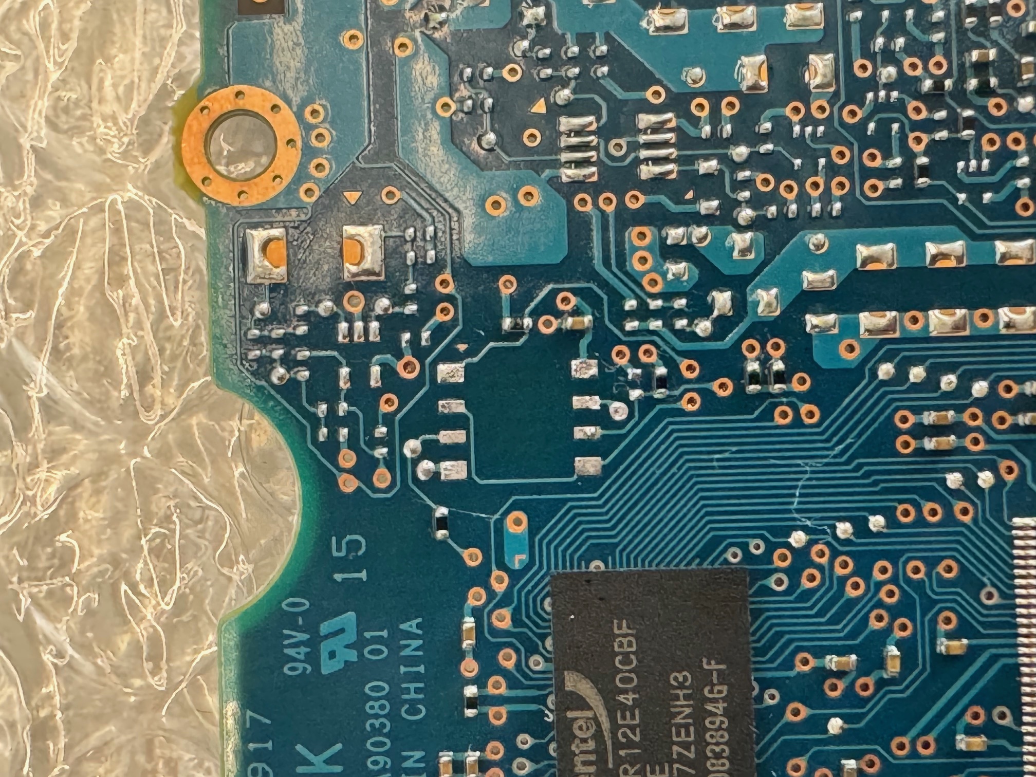

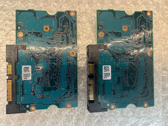

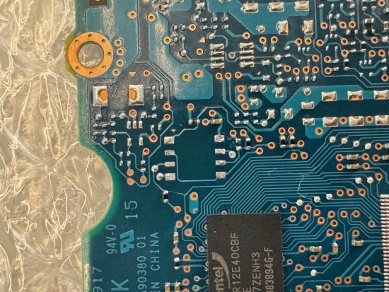

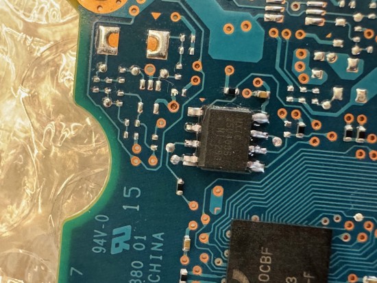

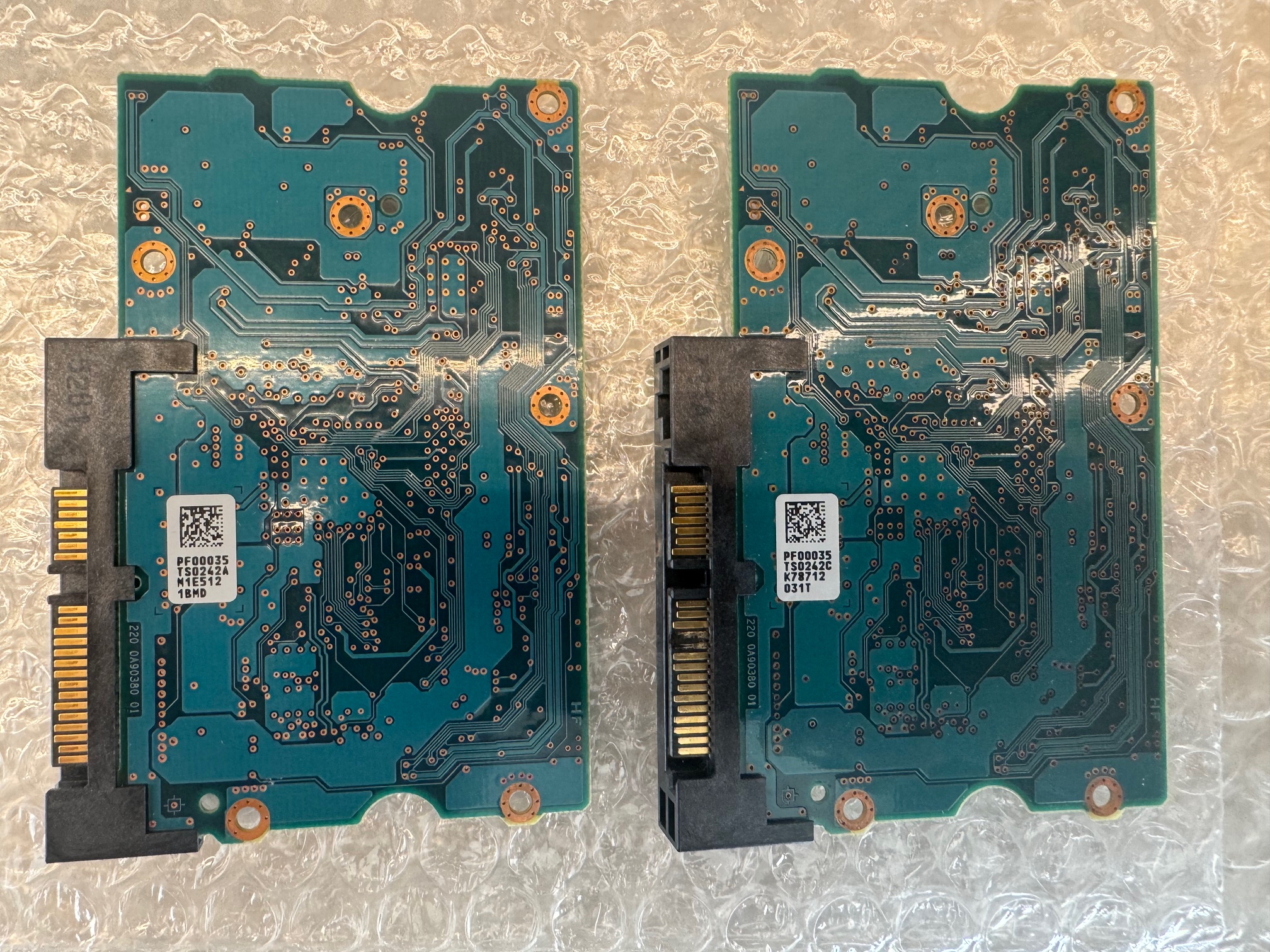

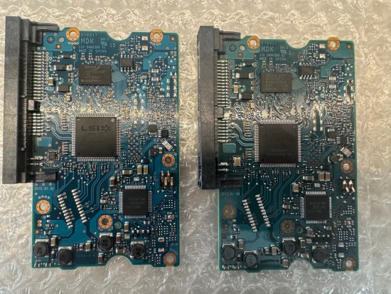

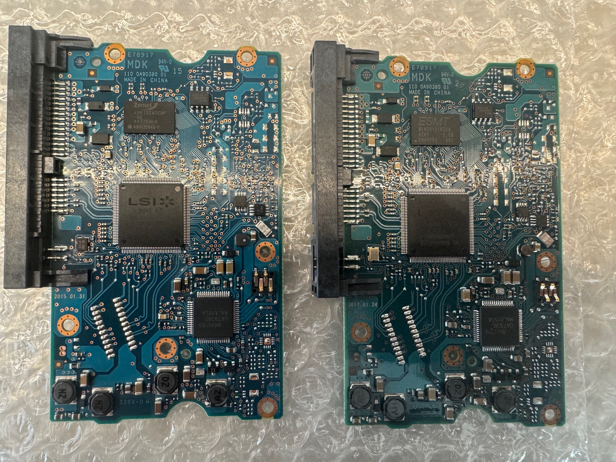

second donor board in, now with same numbers... I changed the eprom, cleaned everything but the thing wont spin after plugging it in... Whats next? Maybe the motor is burned?

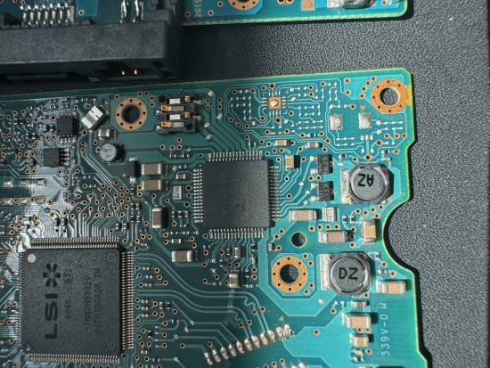

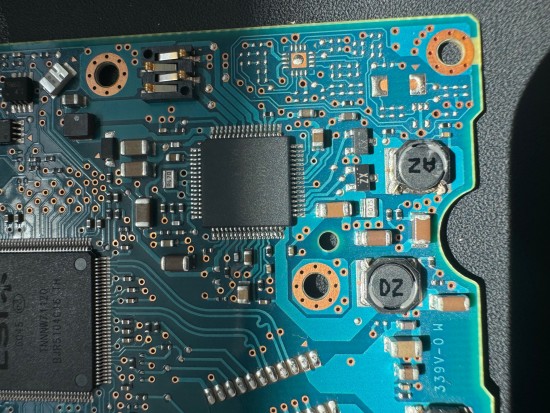

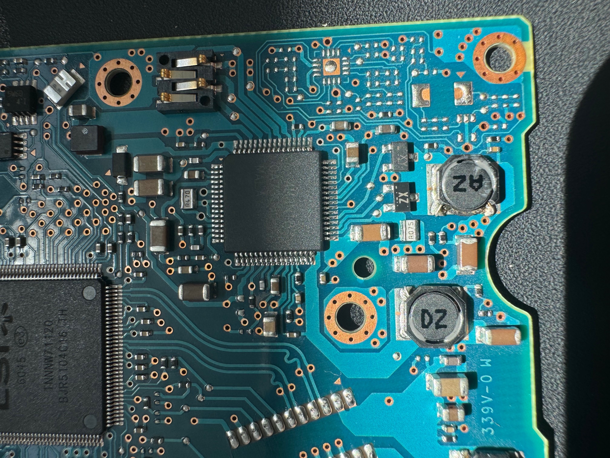

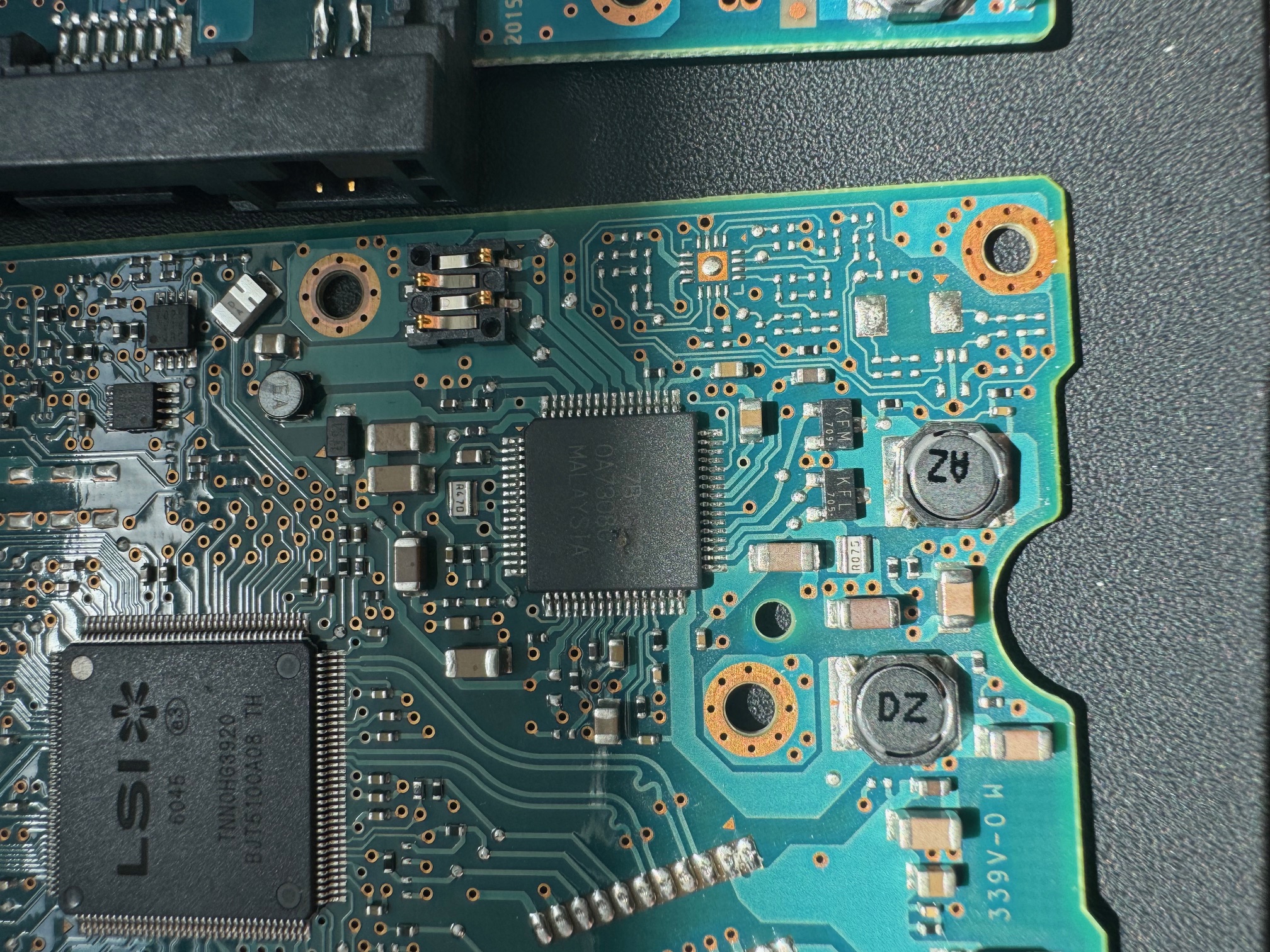

one thing that I noticed on the new board, is that one of the components seem damaged? Its the component on the far right that says "AZ"

Update: I double checked the EPROM pins that I soldered and did a continuity test to the next contact. One of the pins wasn't soldered properly so after fixing this, bingo, the HDD turned on and I was able to see the data and now its being transfered!
