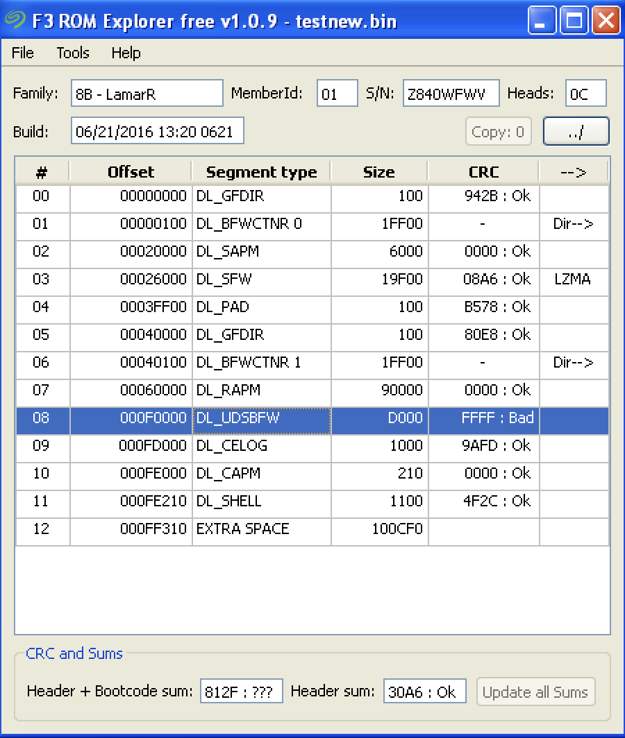

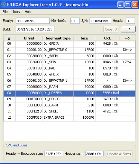

@fzabkar Many thanks for your help :cool:
How did you find the bit-flip? I used your STROMfix_2 but received 144 possible bit flips.
I did the patch you calculated and DL_RAPM seems now good.
HDD does spin-up but sectors cannot be read.
Please look at DL_UDSBFW. If I compare it to other firmware (see attachment above), it only contains 0xFF in patient's firmware.
Can I take it from other firmware?

DL_UDSBFW is usually empty. I think you have a different problem.
My tool gives a lot of possibilities, but most can be quickly excluded by examining the surrounding data. If you paste the data in the code block into Notepad, and switch off wordwrap, you will see that the bad bit is quite obvious.

I now patched DL_UDSBFW from identical donor fw to patient fw -> hdd spin-up and sectors readable now :beer:
I will see if dumping of hdd mounted as read-only will work without errors. I will let you know in some days..
Note: I also found out, that DL_RAPM is saved a second time in the EEPROM as backup.
