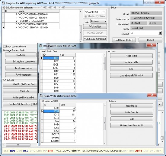

Hdd WDC WD10TMVW-11ZSMS4 with USB PCB 2060-771761-001
ROM Size: 256KB
MRT not ID but WD Marvel tools identify model and its size with USB PCB
I can save modules which are in RAM (Static files ) but can't read any modules from Platters getting "SCSI error 00000000".
so tried in SATA PCB
2060-771692-005 ( 512KB) and 2060-771692-005 (256KB) both clicks and spin down.
also tried 2060-771692-006 that also click and spin down
By USB PCB no clicks and Head reads some imp modules from platter to RAM but SATA PCB clicks and spin-down.
any solution?
