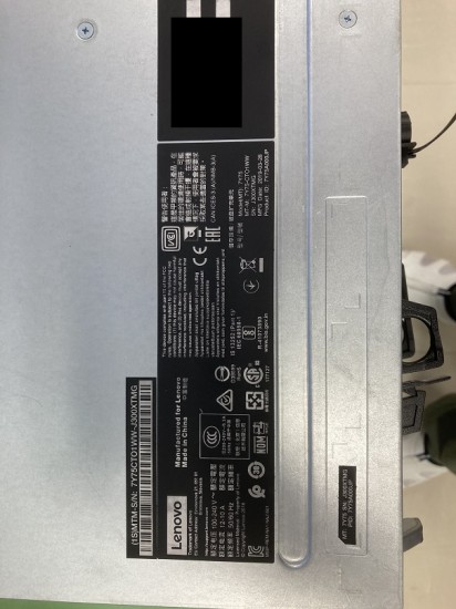

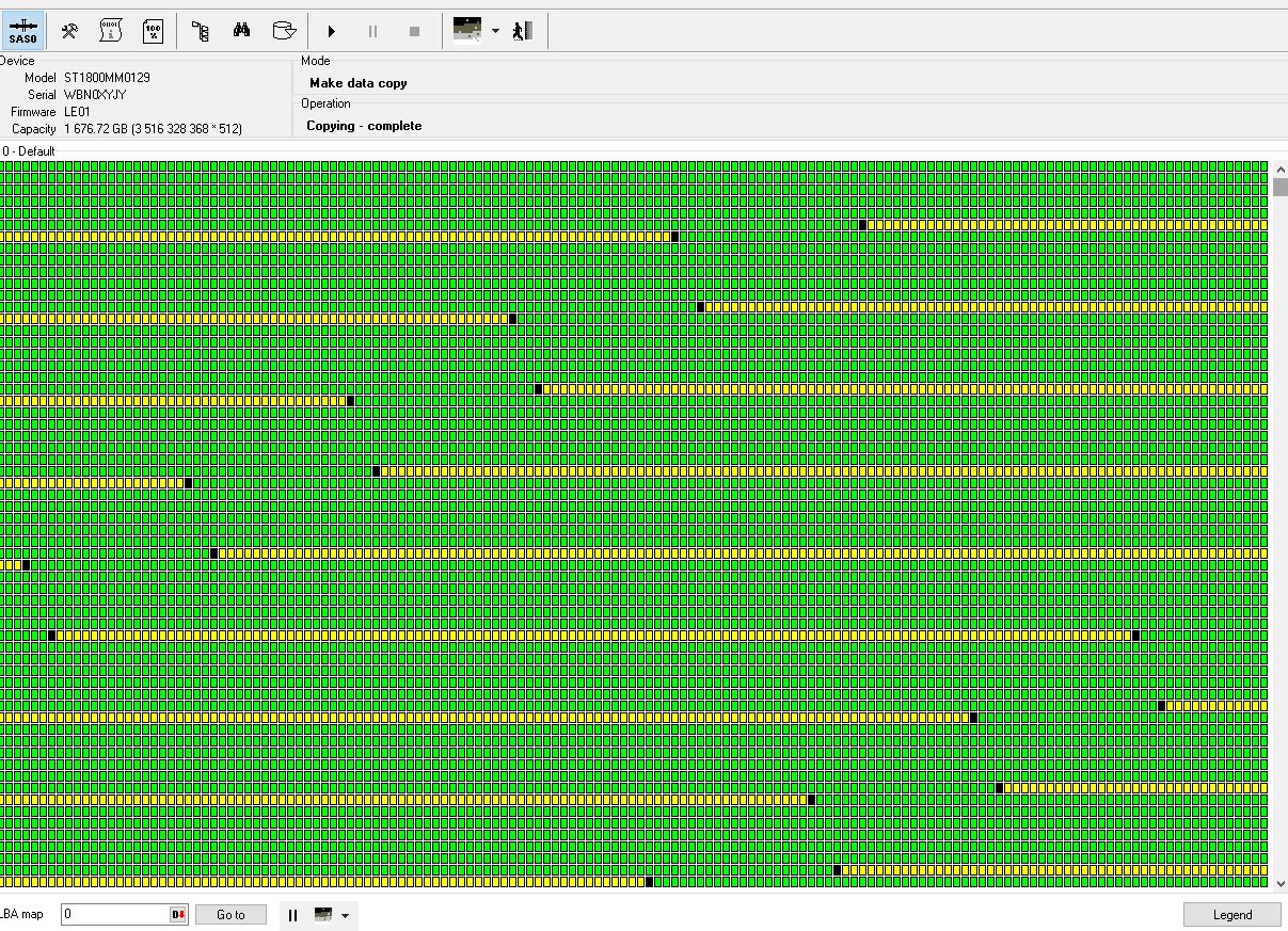

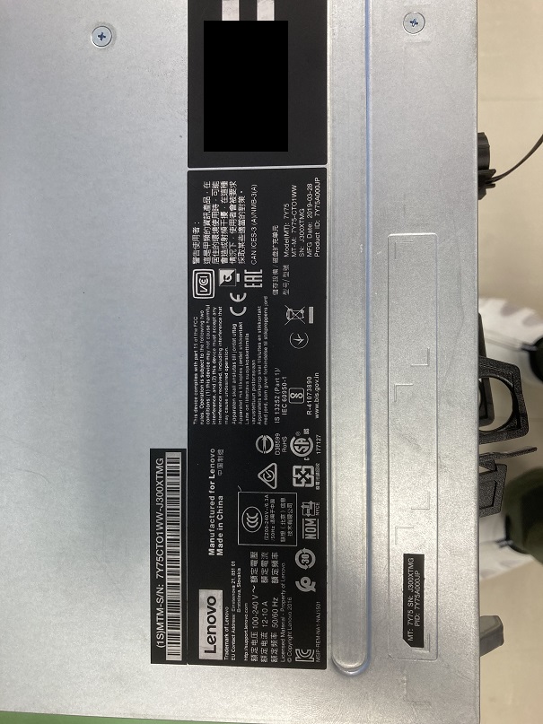

we are working to SEAGATE ST1800MM drives used on LENOVO SAS enclosure. it has 9 drives and made RAID6. We are checked these drive and 2 drives has format corruption error, and other drives look OK.

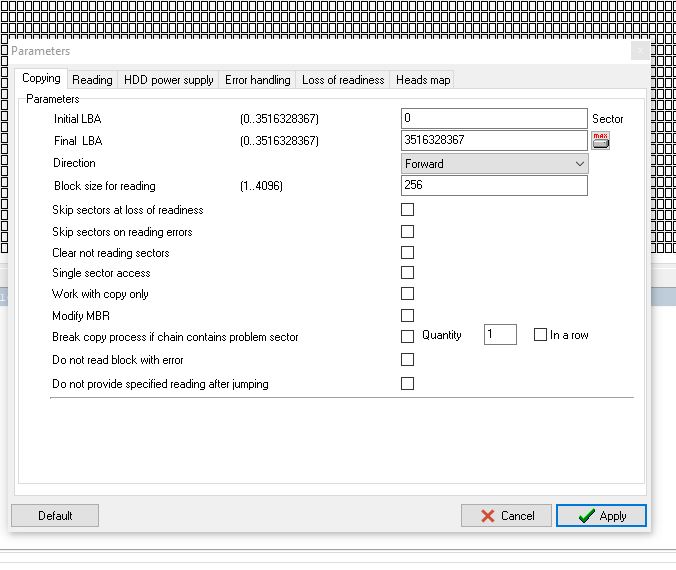

So We made PC-3000 DE image but whole drive respond error contentiously, We did not have chance of this problem before. We guess that DE problem and asked ACE TS due to DE wrong, and same time we checked it on DD on linux, its same situation.
its not result of reading software, We guess.
Anybody has same situation before?
Thanks,
A1 Data Inc.
M Ogata
File comment: Lenovo enclosure

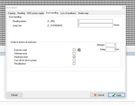

File comment: DE Error

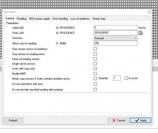

 Post subject: Re: ST1800MM read is wrong
PostPosted: June 12th, 2024, 3:53
Posts: 4816

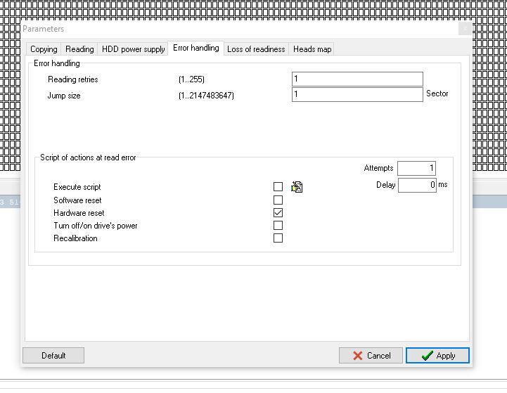

set skip to 1 to see whats in the yellow area

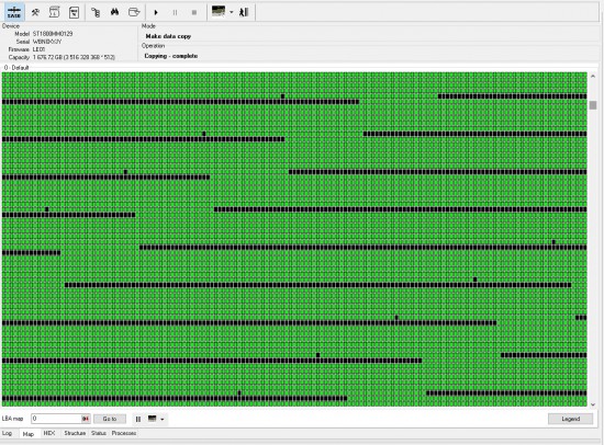

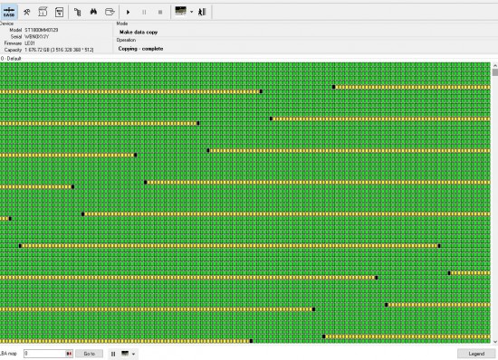

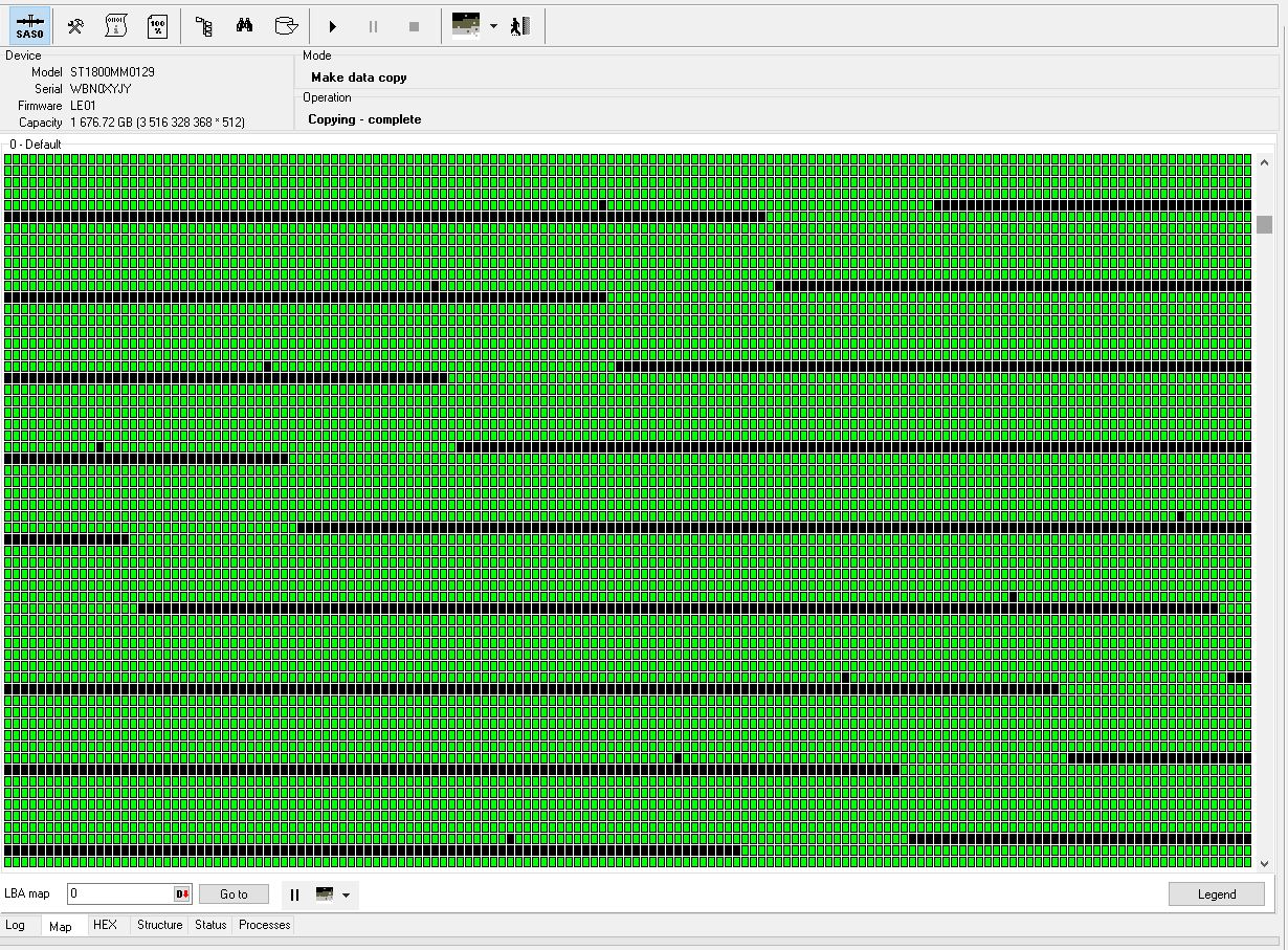

Please look to attached photo.
File comment: DE ststus2
File comment: DE status1
File comment: Error 1 Sec
