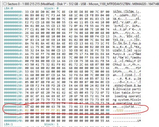

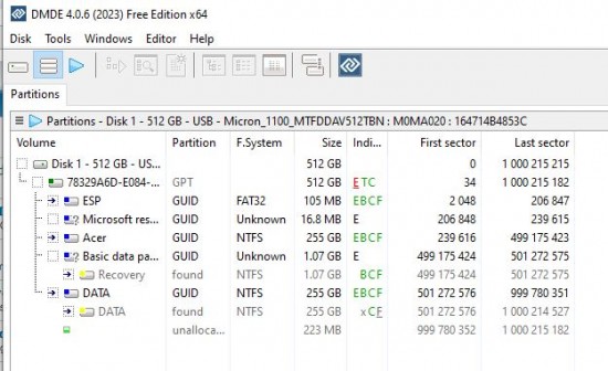

 Post subject: Delete partion in DMDE - Can't boot anymore
PostPosted: June 15th, 2024, 5:51
Joined: April 20th, 2017, 7:28
Posts: 130
Hello
my 512 GB SSD was splited in two partionn C and D drive. As I was runnig out of space, I decided to delete D. I couldn't do it with Windows Disk manager interface so I used DMDE.
I took the drive out, I put it into a SSD -> USB enclosure, I opened DMDE, selected the external drive and I delete the DATA partion. When doing this, is ask me if I want to make a backup and I agree.
I've put back SSD but PC doesn't boot anymore. I've put the SSD back to enclosure, load the saved file but doesn't work. There's a red E on DMDE. It seems to indicate a entry error in partion. I don't know how to fix it.
I've read some post on redit asking to insert back partiton, I 've tried but didn't help. I've attached a pics of the drive how it looks currently and backup from DMDE. It should be probably easy to find the right command but I don't want to mess up more.
Sam
dumpback.zip [1012 Bytes]
Downloaded 195 times
DMDE_problem_deleted_partition.JPG [ 52.22 KiB | Viewed 4345 times ]
 Post subject: Re: Delete partion in DMDE - Can't boot anymore
PostPosted: June 15th, 2024, 12:03
Posts: 17342
The protective MBR partition metadata are missing from the end of sector 0.
Offset(h) 00               08
000001A0  67206F7065726174 696E672073797374  g operating syst
000001B0  656D000000637B9A 734633E900000000  em...c{šsF3é....
000001C0  0000000000000000 0000000000000000  ................
000001D0  0000000000000000 0000000000000000  ................
000001E0  0000000000000000 0000000000000000  ................
000001F0  0000000000000000 00000000000055AA  ..............Uª
See Fig. 1:
https://thestarman.pcministry.com/asm/mbr/GPT.htm
 Post subject: Re: Delete partion in DMDE - Can't boot anymore
PostPosted: June 16th, 2024, 4:53
Joined: April 20th, 2017, 7:28
Posts: 130
Thank you very much, this is a great site to understand the structure. What would you recommand to expand/shrink/delete W10 partition, DMDE or something else ?
 Post subject: Re: Delete partion in DMDE - Can't boot anymore
PostPosted: June 16th, 2024, 4:58
Posts: 1323
I prefer gparted for that sort of thing - but make sure you have an image before doing anything, don't work live on a drive - accidents happen.
 Post subject: Re: Delete partion in DMDE - Can't boot anymore
PostPosted: June 16th, 2024, 11:14
Joined: April 20th, 2017, 7:28
Posts: 130
Thanks, I did it with Gparted, perfect.
 Post subject: Re: Delete partion in DMDE - Can't boot anymore
PostPosted: June 16th, 2024, 11:29
Posts: 17342
I think the solution in DMDE was probably to toggle GPT On/Off. This would have reset the protective MBR.
 Post subject: Re: Delete partion in DMDE - Can't boot anymore
PostPosted: June 16th, 2024, 11:35
Joined: April 20th, 2017, 7:28
Posts: 130
I've tried that but didn't work. I did it manualy.
Boot_problem_DMDE_update_sector0.JPG [ 145.27 KiB | Viewed 4201 times ]
 Post subject: Re: Delete partion in DMDE - Can't boot anymore
PostPosted: June 16th, 2024, 12:50
Joined: April 20th, 2017, 7:28
Posts: 130
BTW, any suggestion for a backup software who could backup daily my SSD 512 GB (Document and Desktop) to my WD 1TB SATA installed on same computer ? Or Sync tool... but something really easy.
 Post subject: Re: Delete partion in DMDE - Can't boot anymore
PostPosted: June 16th, 2024, 14:01
Joined: April 2nd, 2024, 3:40
Posts: 167
Location: on lifes edge
samstown wrote:
BTW, any suggestion for a backup software who could backup daily my SSD 512 GB (Document and Desktop) to my WD 1TB SATA installed on same computer ? Or Sync tool... but something really easy.
Maybe easeus to do backup? Not sure if its free and how to use it tho...
 Post subject: Re: Delete partion in DMDE - Can't boot anymore
PostPosted: June 16th, 2024, 14:28
Posts: 1323
samstown wrote:
BTW, any suggestion for a backup software who could backup daily my SSD 512 GB (Document and Desktop) to my WD 1TB SATA installed on same computer ? Or Sync tool... but something really easy.
Have a look at syncthing
 Post subject: Re: Delete partion in DMDE - Can't boot anymore
PostPosted: June 17th, 2024, 3:13
Joined: April 20th, 2017, 7:28
Posts: 130
Thanks. I've checked and syncthing is good to sync local PC with remote. To Sync internal HDD on same computer, it's not really designed for this. so I took https://freefilesync.org/download.php
