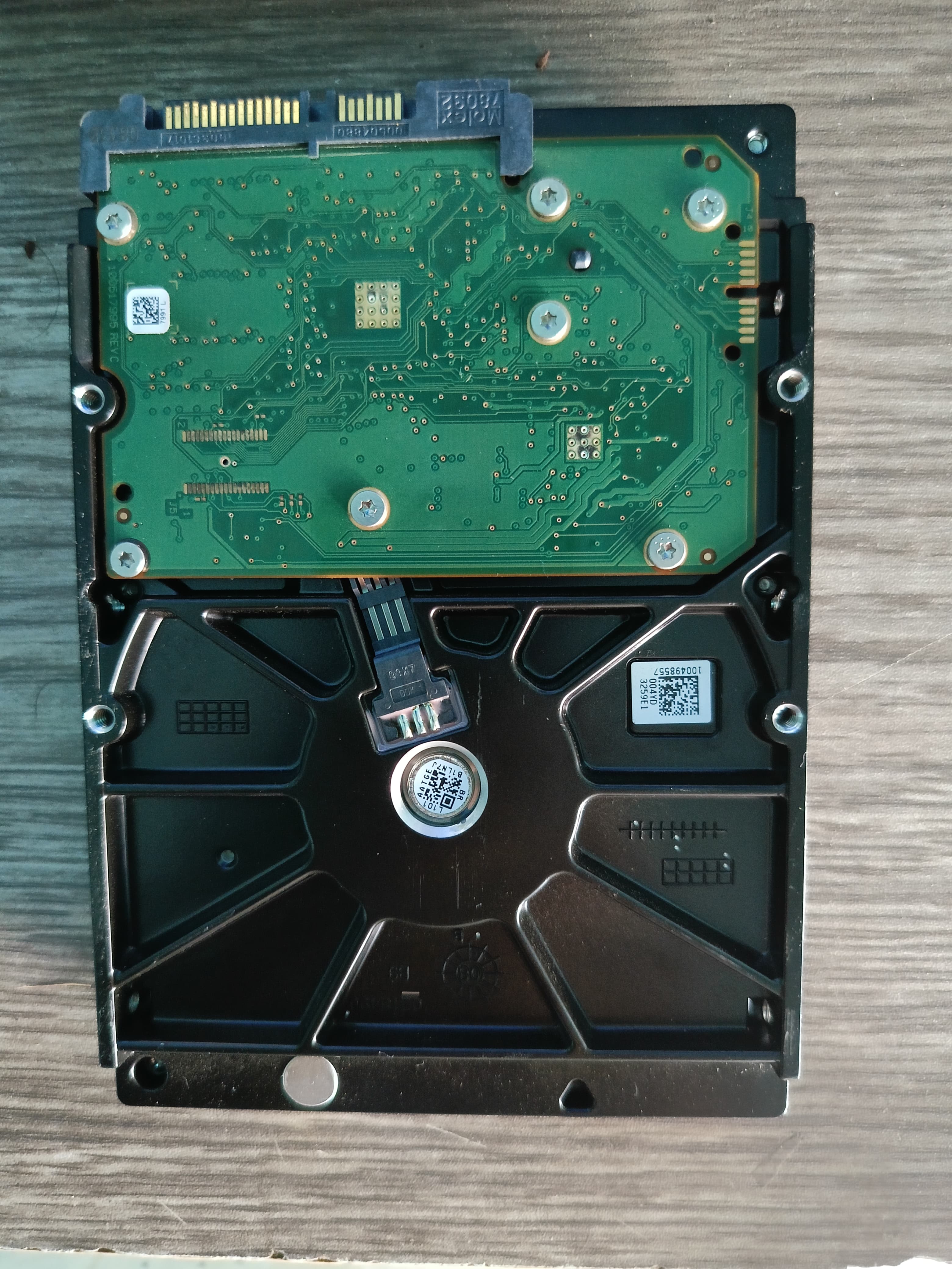

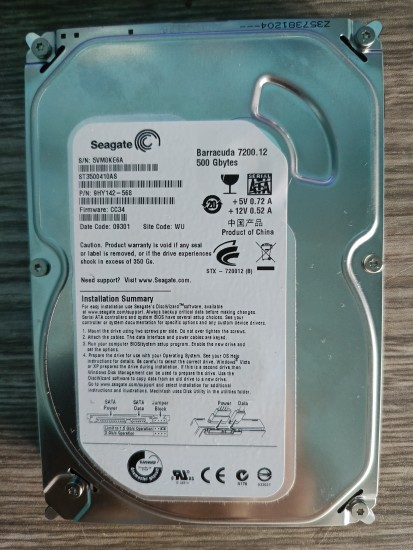

Hello Friends,
I have below Image Hard Disk. It is detected show correct Model number and size. in disc managment it shows raw partition. when I use hddsuperclone to create image, speed is 24-30 kb/s with lots of slow skip. after that i start terminal and connect this hdd on terminal i post terminal log below.
Rst 0x10M
(P) SATA Reset
PASS
RW: Error processing Performance Parameter File: 203C
No Phy: Staggered spin bypass
ASCII Diag mode
F3 T>

i want data and i haven't any professional tool. sombody guide me how to speedup disc image creation fast. i anybody need more details regarding terminal commands i will post here. I safely backup sys files of 1b,93,28,35 without any crc error. I apply also congen command but not success to speedup image creation.
Thank You,
Zaid Kagzi
The problem is probably not the software, but the degradation of the heads/surfaces/both.
What does SMART look like for this drive?
This message is not important.
If the disk reports the correct ID and access to the entire LBA (beginning - end), everything is fine on the module side as well.
To try to speed up the imaging, you should disable some of the service functions in module 93.
The problem, however, lies with
