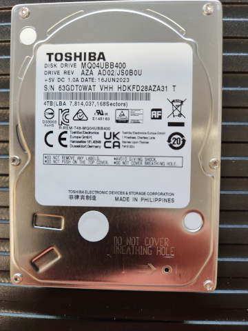

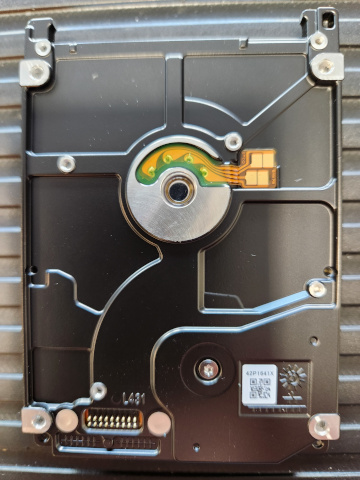

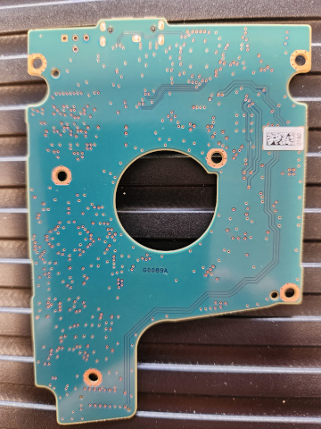

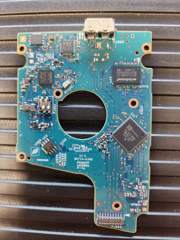

Does anyone know of a compatible SATA PCB for the Toshiba MQ04UBB400 USB External HDD to use for recovery?
Pics are attached.

I expect that MQ04ABB400 would be the equivalent SATA model.
PCB # G4311A ??
https://recuperodatos.com/sites/default/files/webform/donantes/03836-PCB.jpg

That's right, 4311A is the SATA equivalent.
