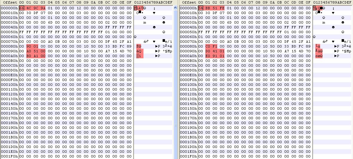

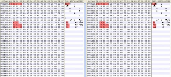

HaspHL wrote:
0x1000 - 0x1007 might be (?) some kind of checksum (which I dont know how its calculated)
0x1000 - 0x1003 must be A checksum of that sector only
but still don't know how it's calculated
