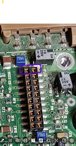

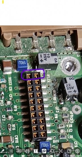

I'm a little confused about your spindle motor measurements. Normally there would be one common terminal and three phases (windings). The phase-to-phase resistance should be double the phase-to-common resistance.
Can you measure the resistance between the two pins in the HDA header, with the PCB on and off the drive? I believe these are the VCM pins.

I measured resistance between the two pins in the HDA header(two pins in the violet circle from your picture)
It was measured 11.8 ohm in any kind of situation(with the PCB on and off the drive and working and broken PCB).

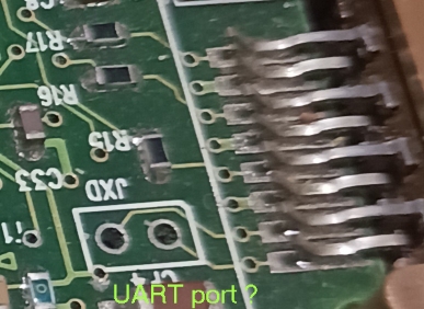

That said, I don't know why your replacement PCB is not spinning up the drive. Can you hear any sound if you place your ear against the drive?
I don't know whether your model has a UART port, but you could investigate it.
How to connect a terminal adaptor on a Samsung drive ?
https://www.hddoracle.com/viewtopic.php?p=432#p432

I'm guessing that this is the UART port.
