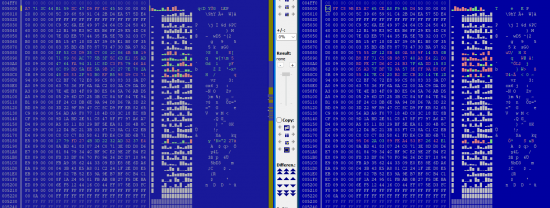

So, he handed me 3 identical drives. For starters, I found a dead flash memory. I used another driver as a firmware donor, and, as I have no experience hacking HDD firmware, this is where I bumped:

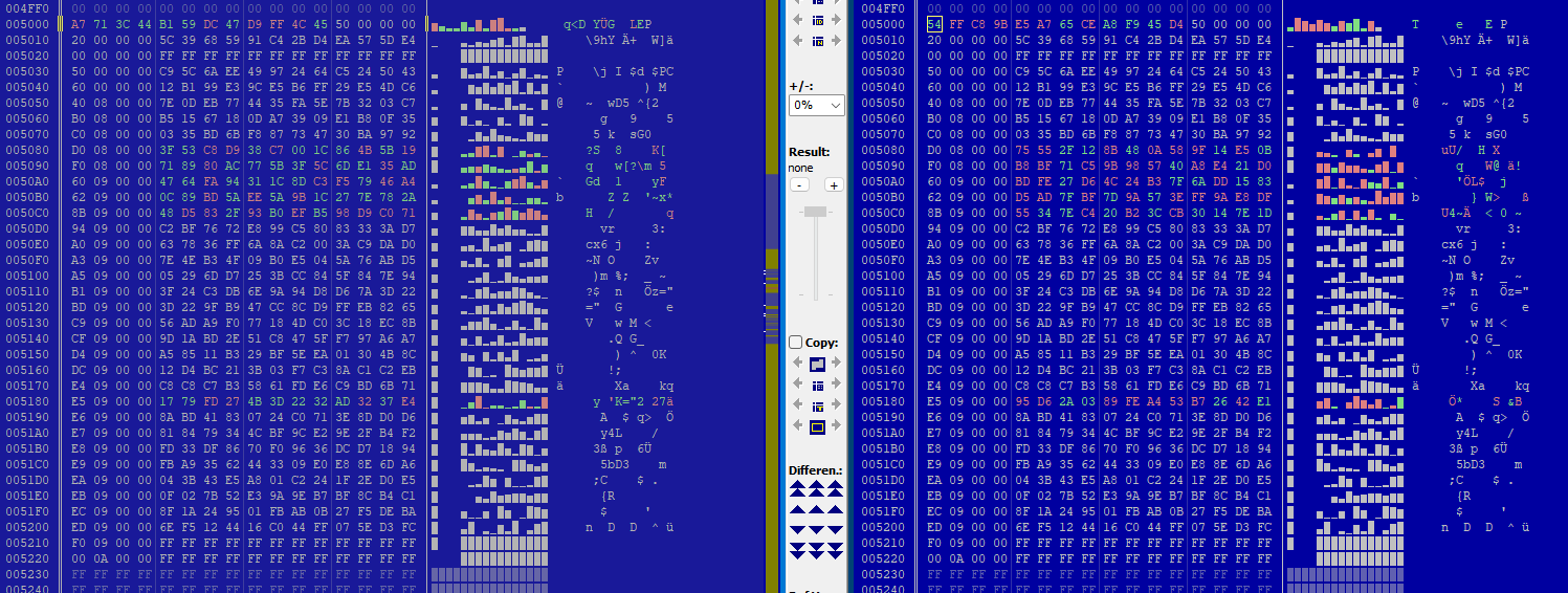

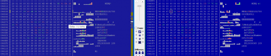

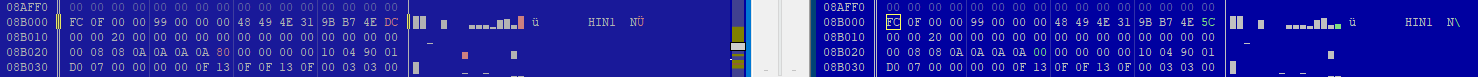

This looks like a CRC or Checksum table. From 0x5010 to 0x5220, the first 4 bytes at left indicate the address inside the firmware, followed by a 12-byte string, or hash. I assume it's some kind of checksum calculation, after all, I found different information in three different firmware but the same 12-byte string:
As you can see, even with two different values, the line 0x5060 that points to this part of the code at 0x80B000 is the same in the 2 firmware.
At the address 0x5000, the string starts first, then, the address. I am guessing, this is the checksum of the checksum table.

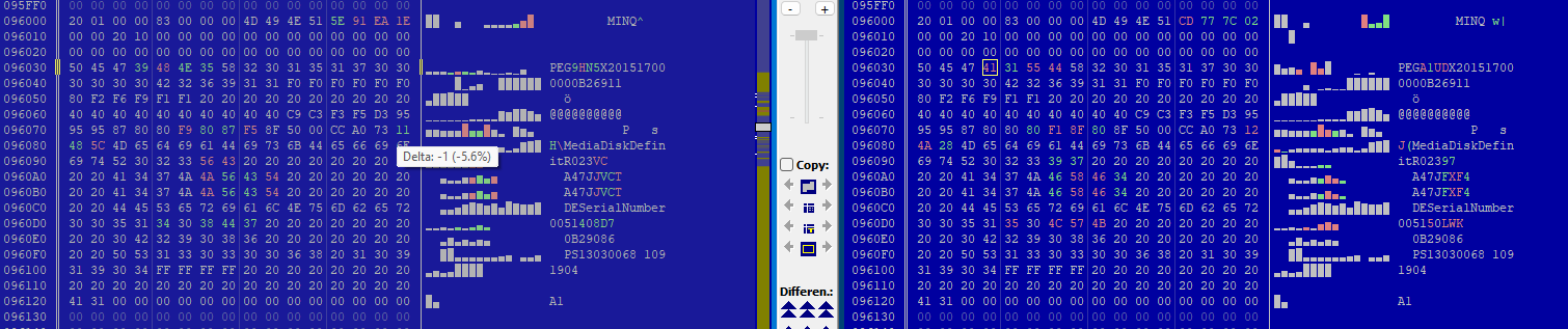

That said, let's understand my doubt:
Those are the serial numbers from the HDD (PEG9HN5X20151700) and the serial numbers from the head device (0051408D7), which I know by reading the HDD stamps. But, when I edit, the HDD won't exactly work. It gets recognized but doesn't respond correctly to any SCSI command. The same happens when I change the firmware of working drives. sg_scan finds the drive, but I can't do anything. sdparm -al returns all parameters as it was, but I can't modify them.
I tried to replace the checksum of the line 0x50A0, to one that matches the working HDD, but, In this case, the HDD wasn't recognized at all.
I tried to run arm microcode from the firmware packs I downloaded from DELL and HP, but they don't have this table, or anything like a checksum calculator inside. I assume this is calculated at the factory.
My gold question is: Does anyone know how to calculate those CRCs? Or I'm gonna have to swap the disks between the drives?
