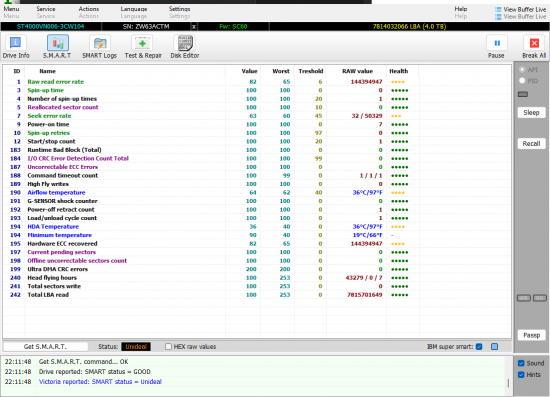

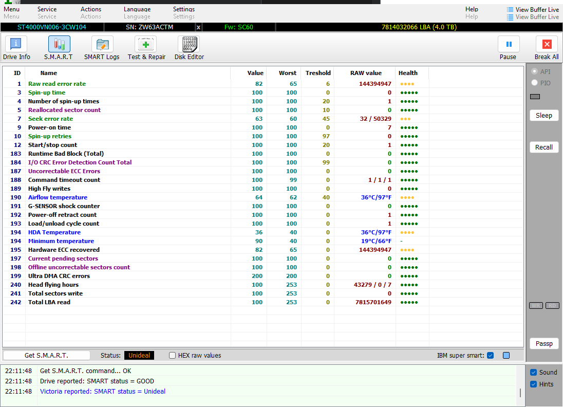

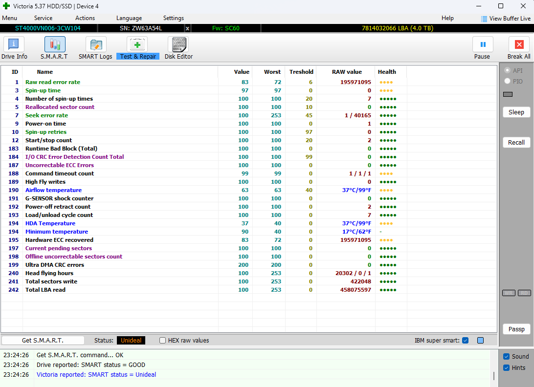

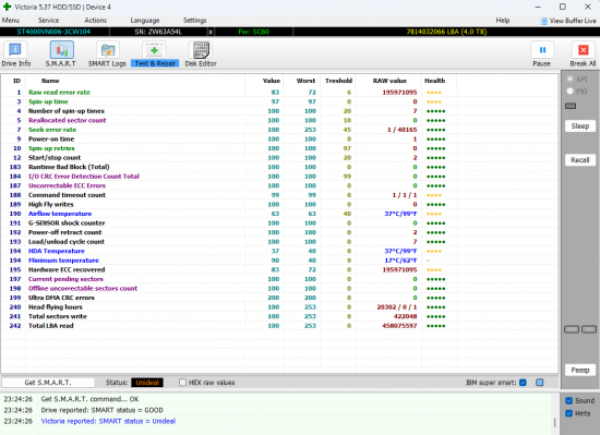

I have just purchased 2 x Ironwolf drives from Amazon direct and am running a surface scan with Victoria HD 5.37. One has finished and I have started the second, takes about 7 hours odd. I have shown the SMART pictures to Grok3 which has said the high Raw read rate maybe a cause for concern on new drives and I should contact Seagate for clarification. Before I do this and look silly I would like to flail myself to this forum for opinions on these 2 new drives and the read rate.
See attached pics.
Thoughts? :D

The only thing that would concern me is the Command Timeout attribute, but it only reports one "slow" sector. The actual number of seek errors is 0, and those read "errors" are actually just sector counts. I've provided you with Seagate's own specification documents. They explain the numbers better than I can.

https://www.disktuna.com/seagate-raw-sm ... ertertest/
Someone on another forum found the above which converts Seagates big scary numbers into sense.
