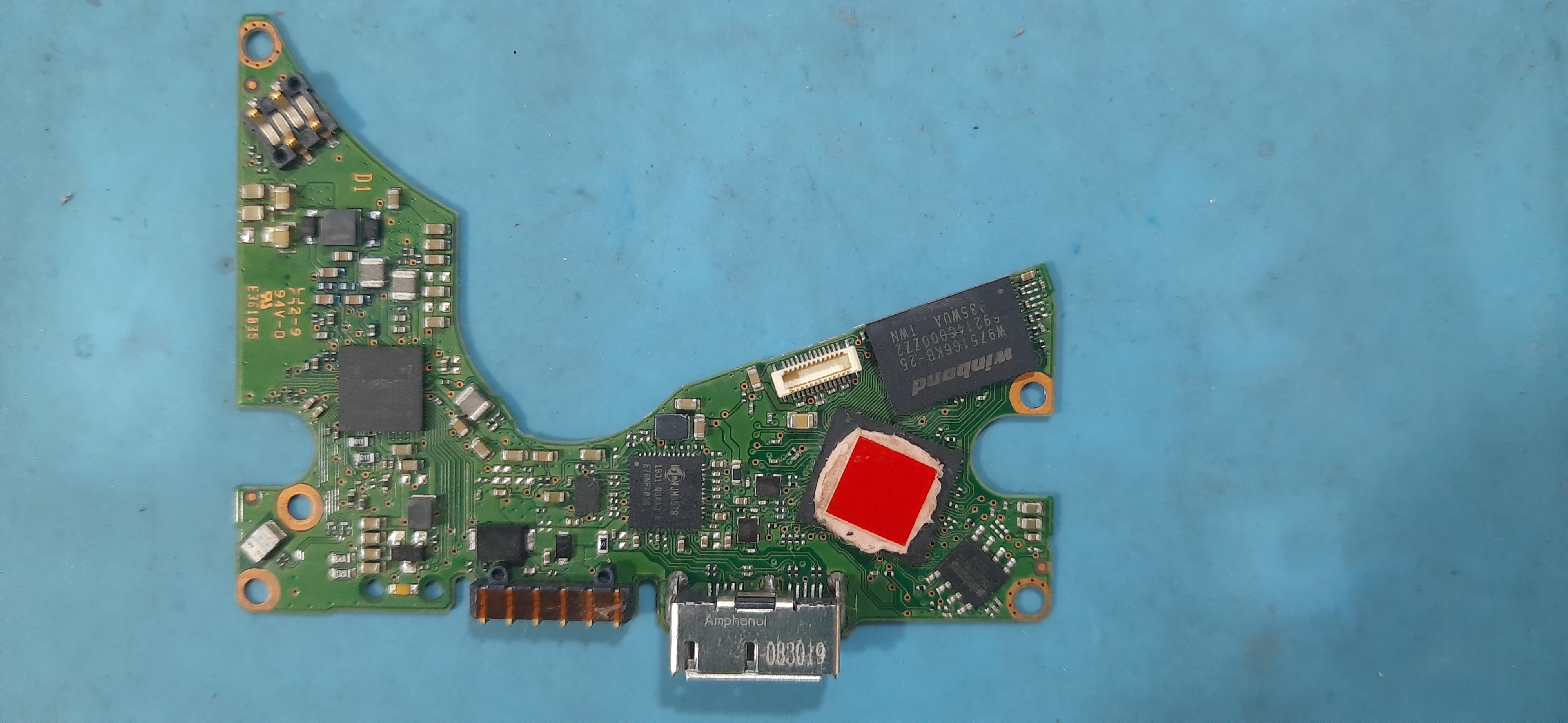

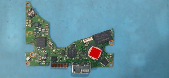

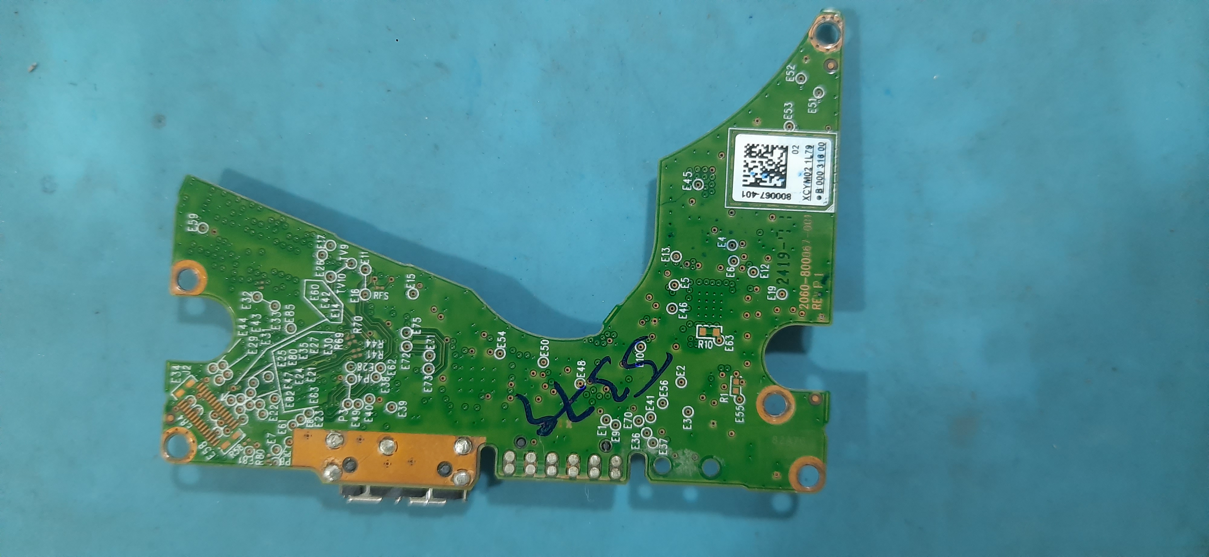

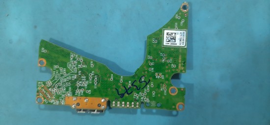

Hi every one and hello fzabkar sir kindly help me fix the pcb its 800067 2TB WD Charger problem is no power at all i have posted the pcb pic pls help
 Post subject: Re: Kindly help me fix this pcb 800067
PostPosted: March 14th, 2025, 5:28
Posts: 4816
check the component marked with 'S', it should be shorted (fuse) and the diodes near it, they should not be shorted.
PostPosted: March 14th, 2025, 5:46
Joined: July 11th, 2018, 10:55
Posts: 43
Component marked with S is short and near diodes are not
PostPosted: March 14th, 2025, 5:51
Posts: 4816
as a next step, measure voltages on 'S' and the inductors near the motor controller while supplying power through the usb connector and post results

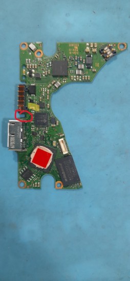

PostPosted: March 14th, 2025, 16:30
Joined: September 14th, 2023, 8:43
Posts: 62
Location: Kentucky USA

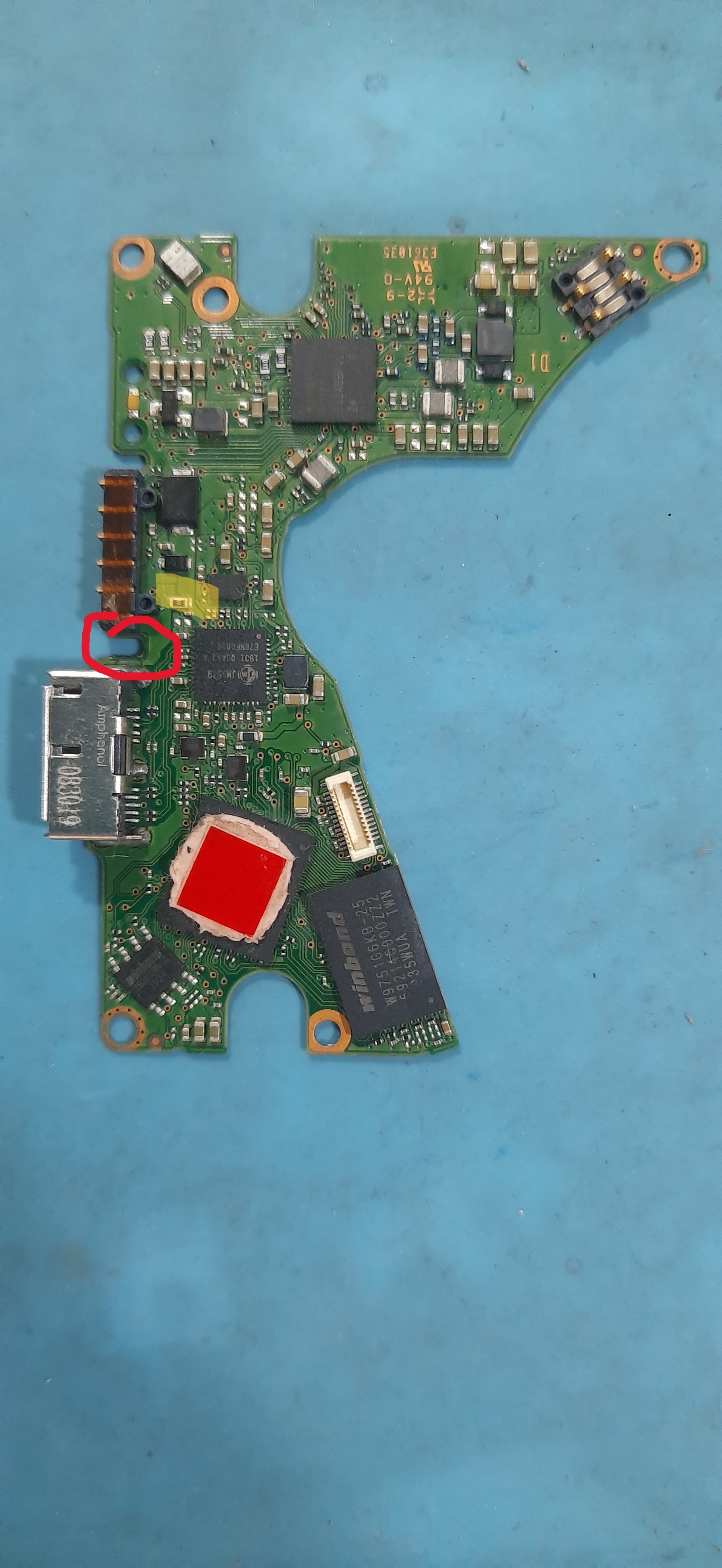

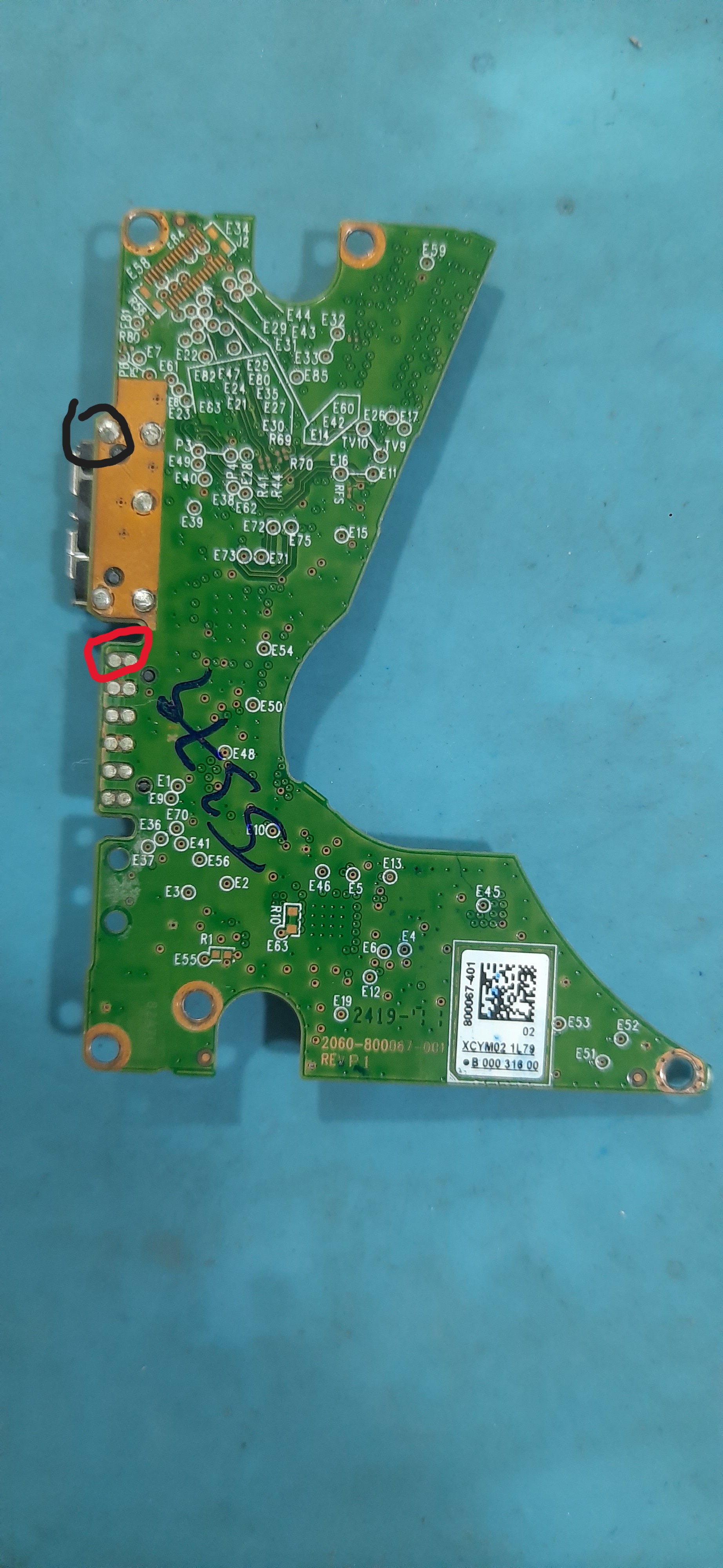

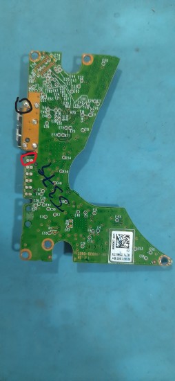

I assume you've checked TVS diode and the fuse?
Looks like the power trace is cracked. Circled on the top down view.
Try to solder power to the point I circled in red on the back side view, ground to the black circled spot.
If the board is not cracked, the fuse marked S I've highlighted, sometimes those have cold solder joints, I've managed to fix a few of these boards by just putting some flux and hitting that fuse with hot air to reflow it.
