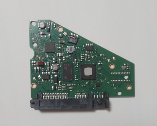

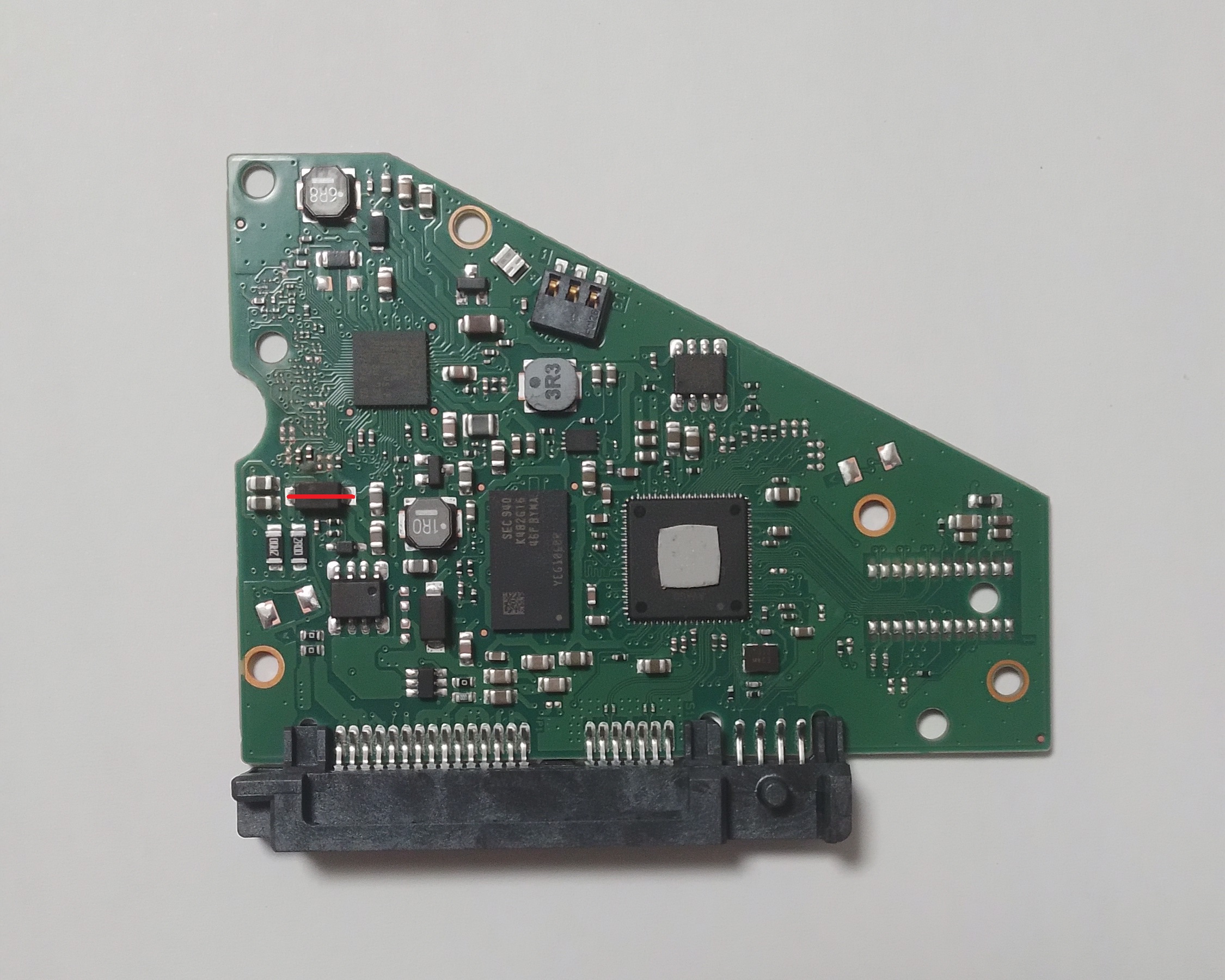

Seagate 8tera hard disk is not recognized even when plugged in.
pcb is 100815597 revd
The 12v diode in the picture comes with a short. Will be replaced.
If there's anything else you need to occupy, please let me know
Thank you.

Check the small fuses.
Good luck

It's been repaired well. Thank you
