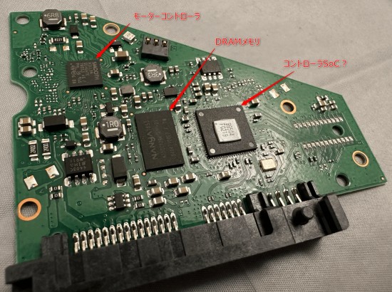

my Segate ST5000DM003 suddenly failed - it doesnt seem to go fully through the Init Sequence.
Symptoms:
- Spins up, Heads move, but acting somehow "abnormally"
- no Connection via TTL, Logic Analyzer on TX shows no activity
- SATA sends requests, but no valid reply at all, its stuck in Identifying the drive
- so of course smartctl would be senseless
After power up, i hear the head assembly moving quite a good bit, but it doesnt do any longer the "harsh" "zig-zag" movement before being ready, as it was before.
Listening to the HDD tells me that the head assembly moves a bit at this moment, but does not fulfill the harsh movement as mentioned before.
For some reasons while trying to identify the problem, the 12V 0 Ohm Resistors and the TVS Diode "failed", causing a short Circuit , so i had to bridge the 0 Ohm Resistors and remove the Diode. Spins up again.
but still the same problem.
No visible damage otherwise. Tried to "reflow" everything a bit with the heatgun, but no success. Of course i cleaned the contacts aswell.
I suppose its a firmware Fail for any reason, since the heads are being initially moved, but at the moment i am clueless whether the firmware is integrated into the MCU or is provided externally.
Or could it be likely that the Platter calibration data is stored externally? Is the 8 Pin Part near the MCU a EEPROM?
Any chance to rewrite the firmware (i have RS232-TTL, an STM32 MCU programmer, the possibility to run some Code on a STM32/8051/AVR/Pi Pico).
Any Pinouts available for the Main MCU?
Attached is a picture form another Site which shows the Main PCB, altrough it provides a larger capacity, it seems to be identical.
Any ideas are very welcome - thank you!
Best regards
Stef

That is all i got. Yes, meanwhile i found out that the Firmware resides in the 16 MBit Chip, but asking myself if the drive Calibration Data resides in there, too. I guess that i have to take the Chip from the PCB and read it, as usually, out.

The flash chip of the HDD contains unique data for each disk. If this chip or its contents are damaged, this HDD is a brick.
If the HDD ROM is damaged, the disk usually does not spin up.
Seagates are diagnosed via the terminal. In your cases, the level is 1.8V(USB-TTL 1.8V).
And not everyone can even do this...:)
https://forum.hddguru.com/viewtopic.php?f=1&t=45269
And yes, they have SWD ARM. But only the manufacturer has the documentation... :(
