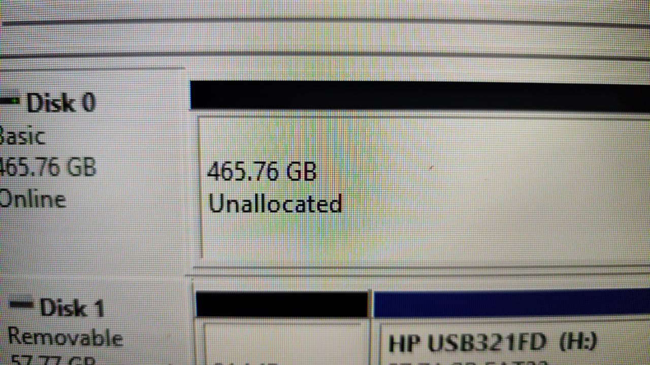

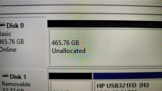

Dear Pepe Sir,
Please see attach pic, When i got hdd it has partial access problem. All sector bad reported by R-Studio. When i apply translator regeneraton command i got Process defect list error. when googling i found that sys file 1B has problem accroding to various forum.

Partial access means drive is able to read user area up to a specific LBA. You say all sectors are inaccessible, ie this is not a partial access problem. Without tools you will likely cause more harm than good, plugging defective disks under windows is a very bad idea anyway.
