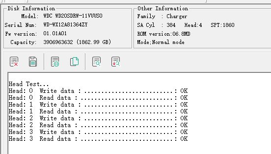

I'm working on a WD20SDRW-11VUUS0 that’s been converted to SATA and unlocked using MRT.

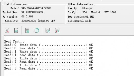

I've backed up all the key modules and performed head tests — everything appears normal.
However, when imaging in Data Explorer, the speed is painfully slow — around 8 bits/sec — with lots of bad blocks showing up. I’m trying to identify the root cause. Could it be:

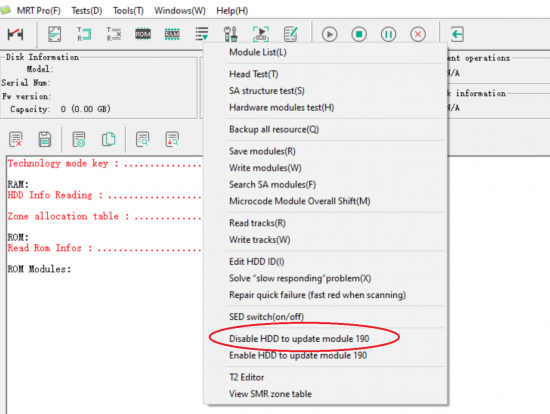

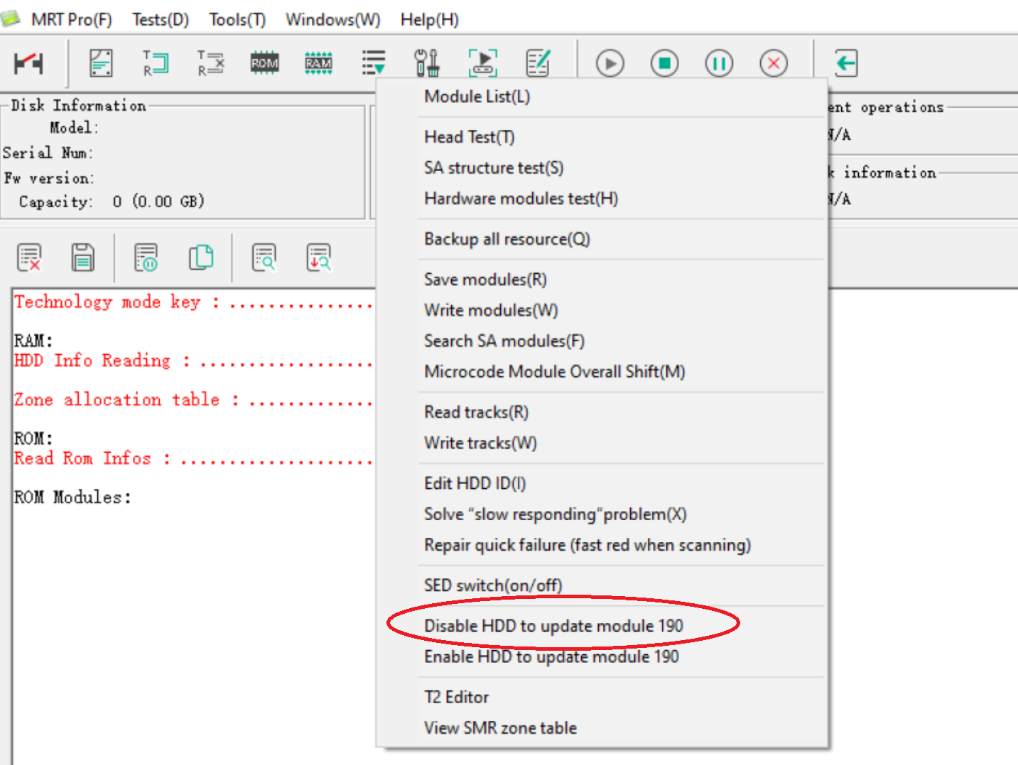

I haven't tried with MRT, but assume that the Disable HDD to update module 190 is the same as Block UA writing with PC3000.
Well I had already tested this option before, but it was exactly the same.

Well this command pass without any error.
About heads, what about mrt head tests without error ?
