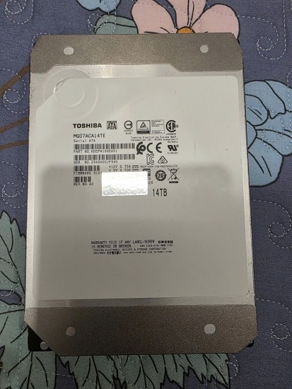

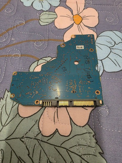

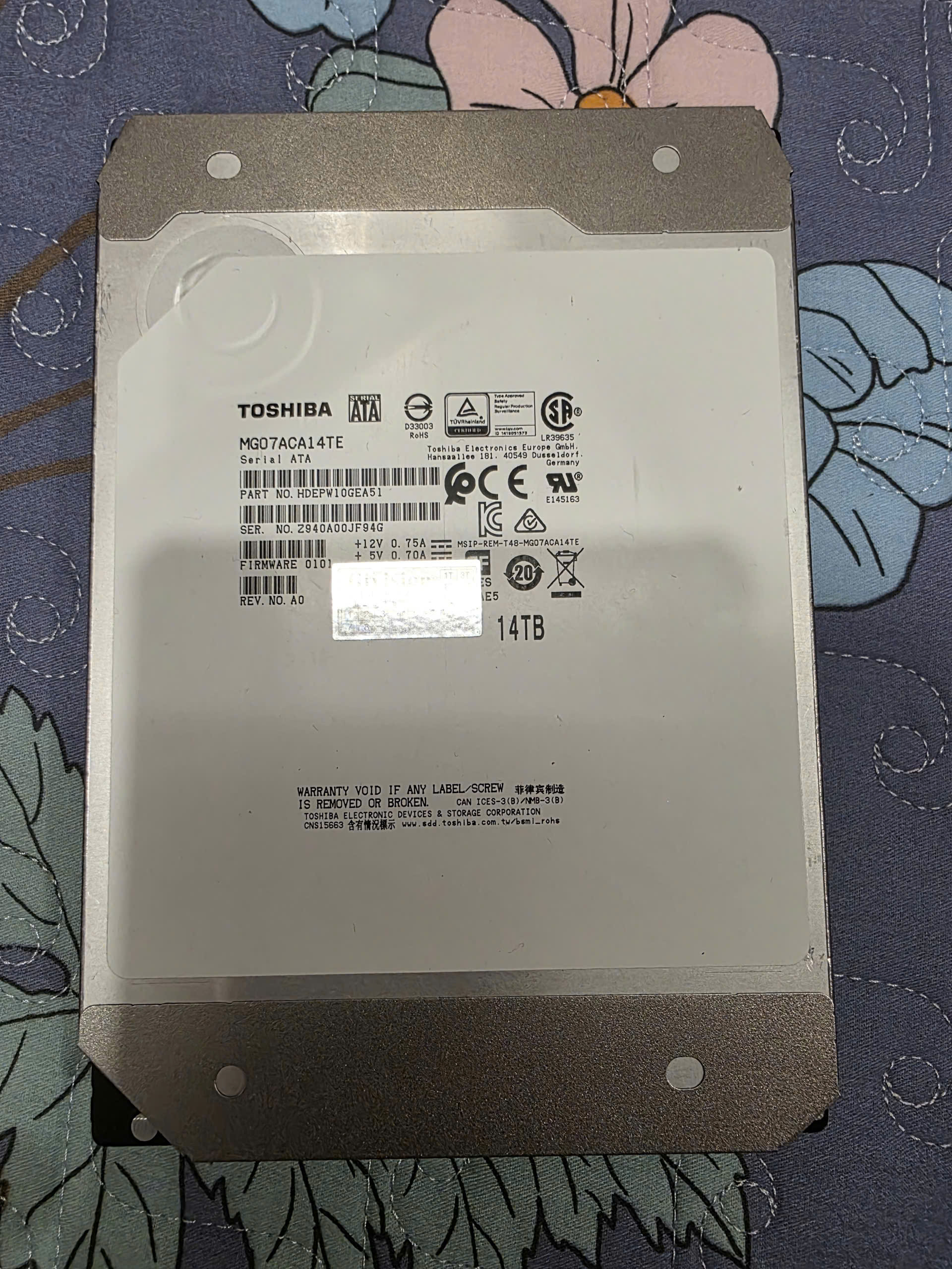

Hi everyone!
I have this Toshiba 14TB drive MG07ACA14TE

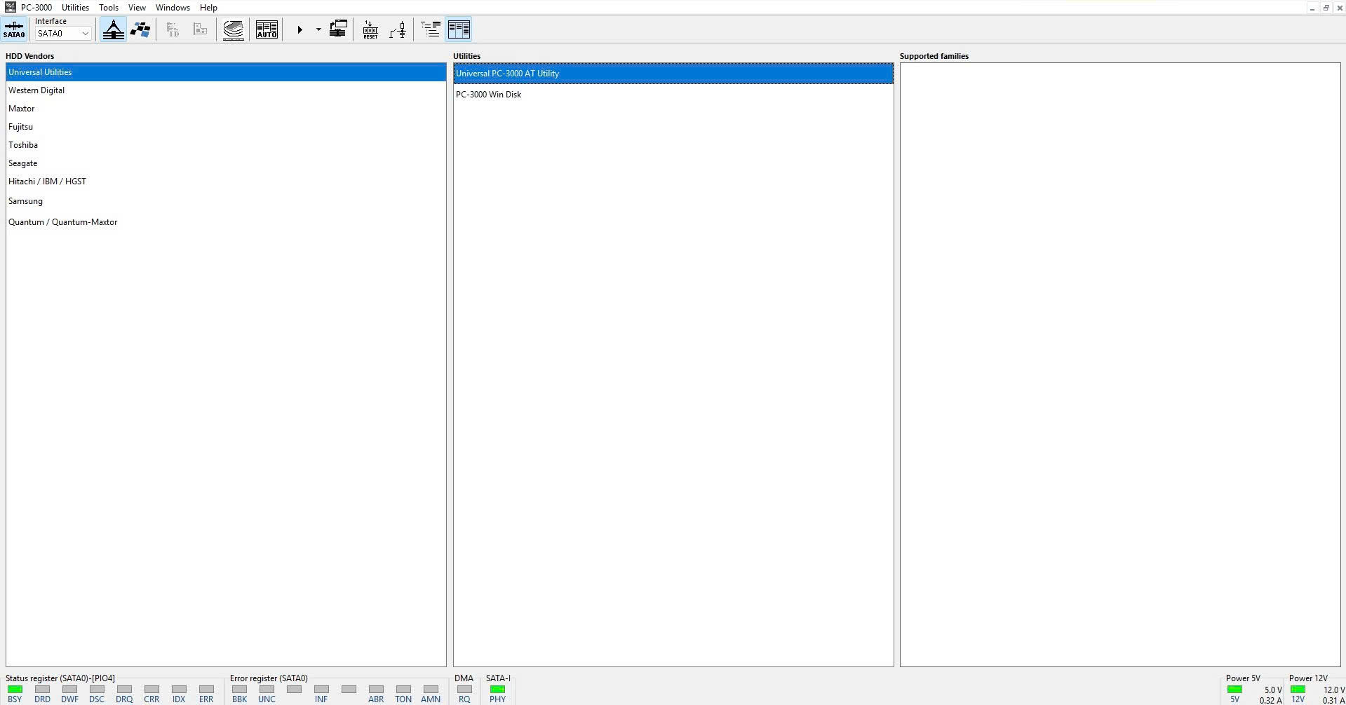

One day powering on the drive. The drive spins fine. Doesn't have any clicking sounds. But doesn't show up on PC
Upon testing in PC3000. The drive is stuck in BSY

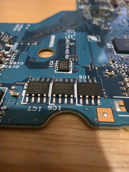

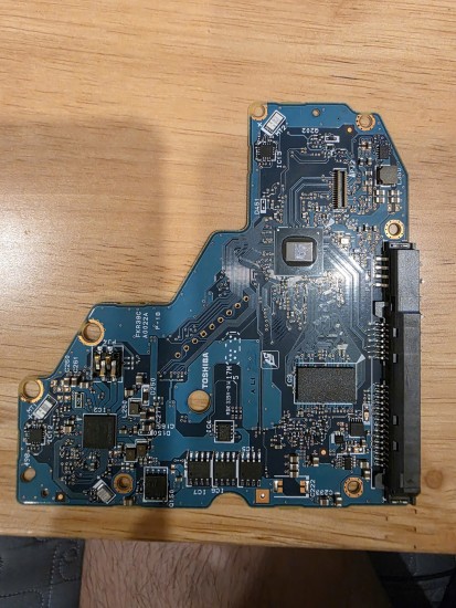

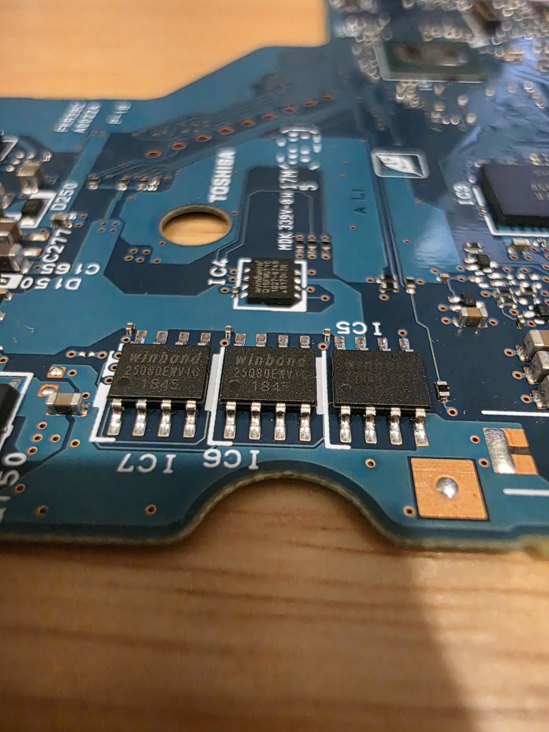

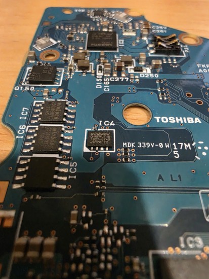

I think it might be something wrong with either the PCB or the ROM
However it has 4 ROM chips and i don't know which one is the main one. Or what are they for

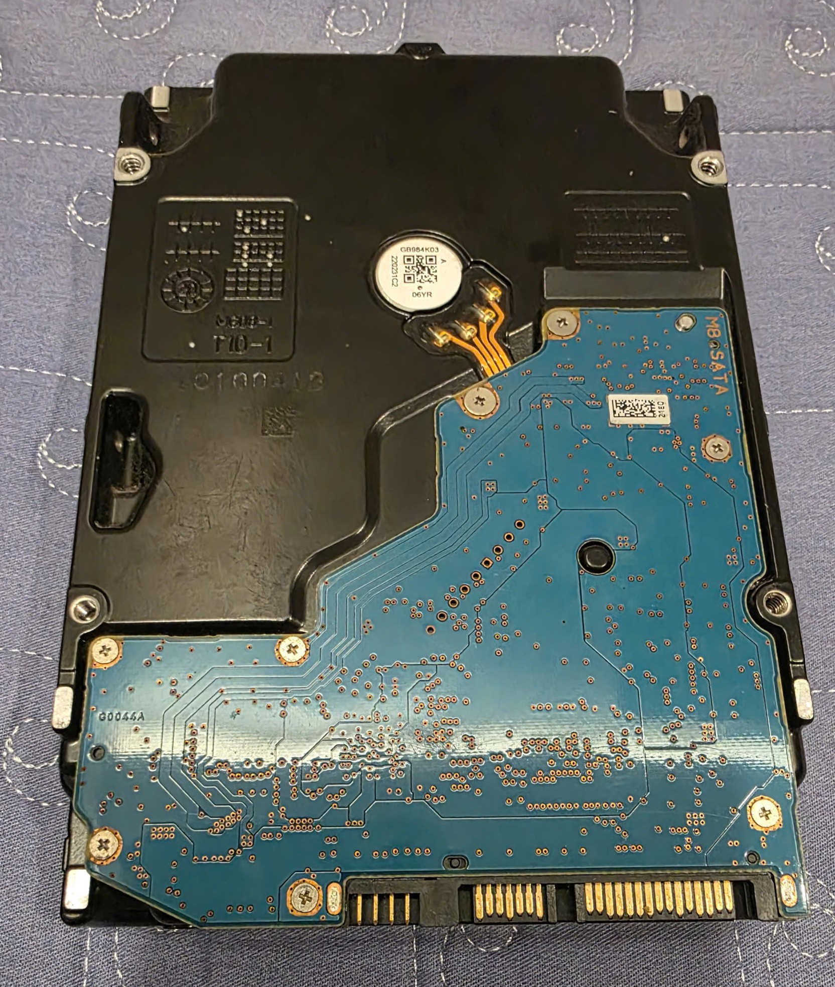

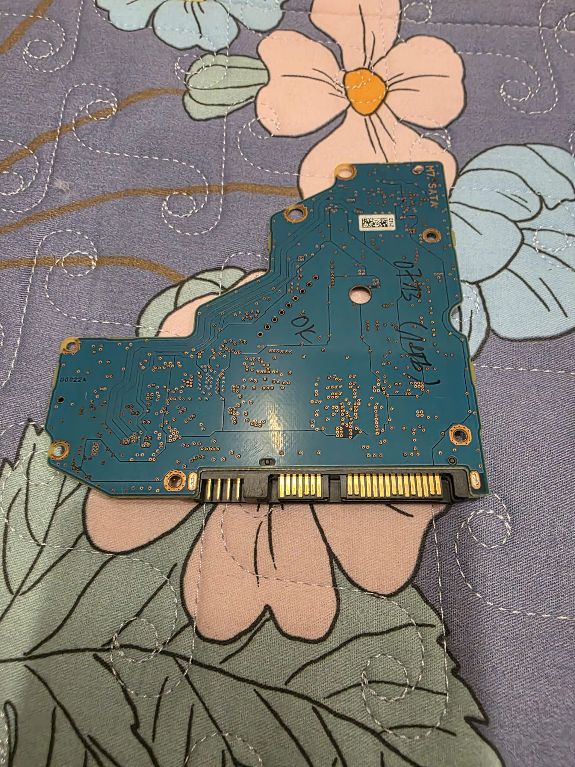

The Original PCB label is G0022A

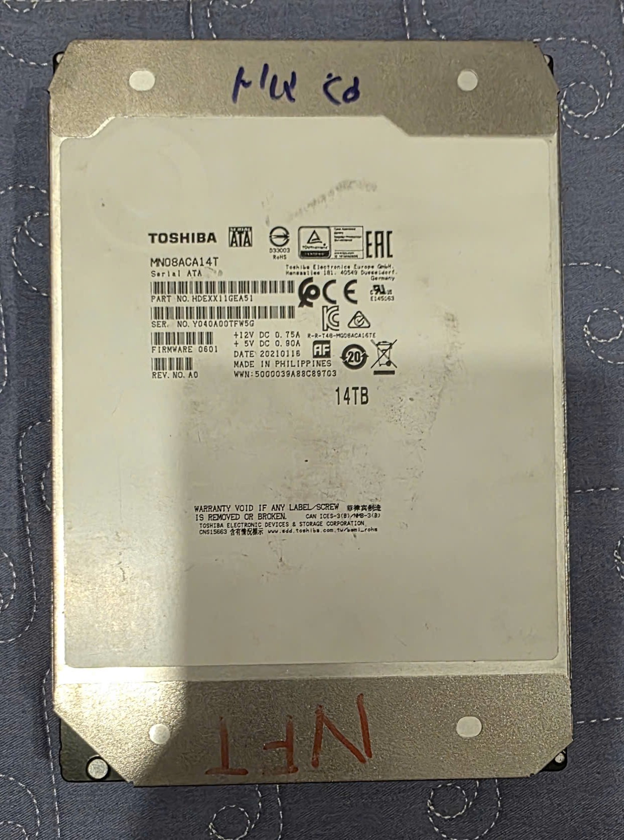

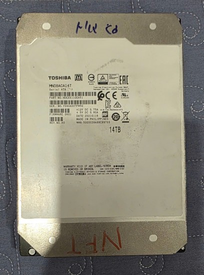

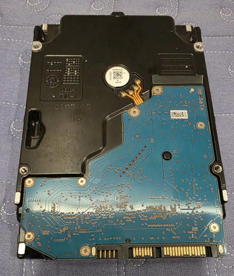

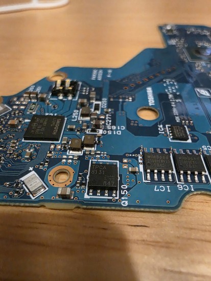

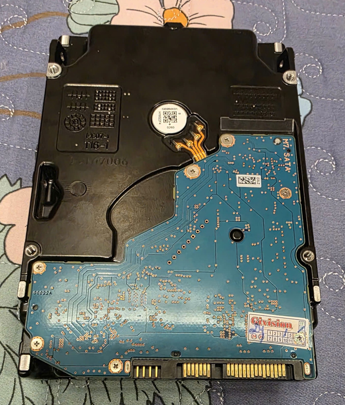

I got my hands on the Donor Drive. Also MG07ACA14TE however the PCB labelled G0044A

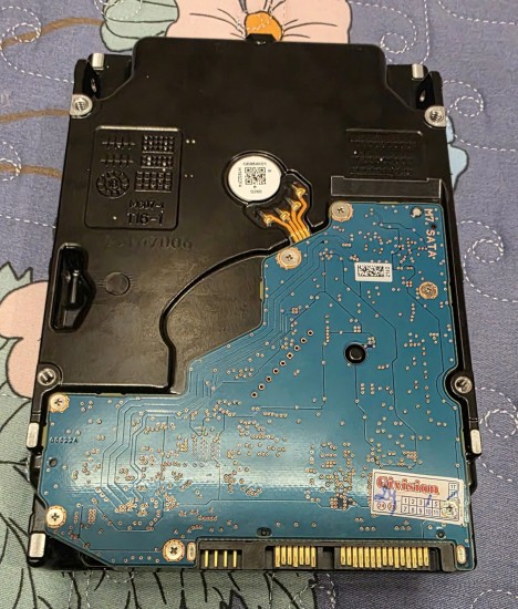

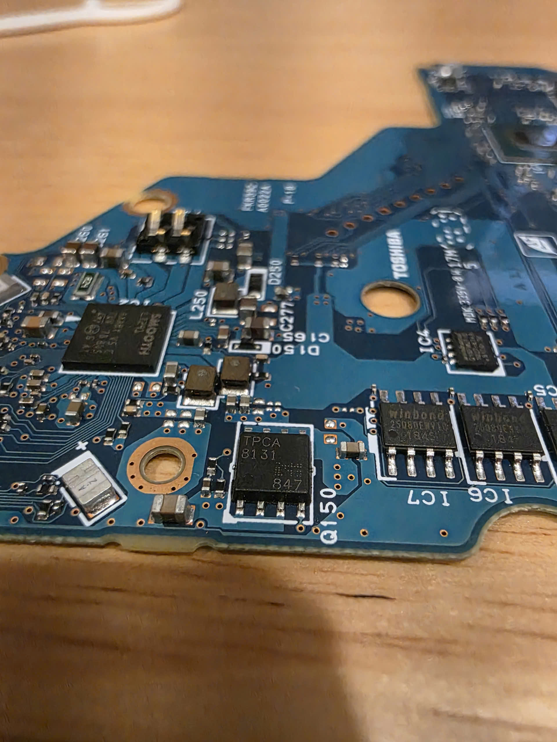

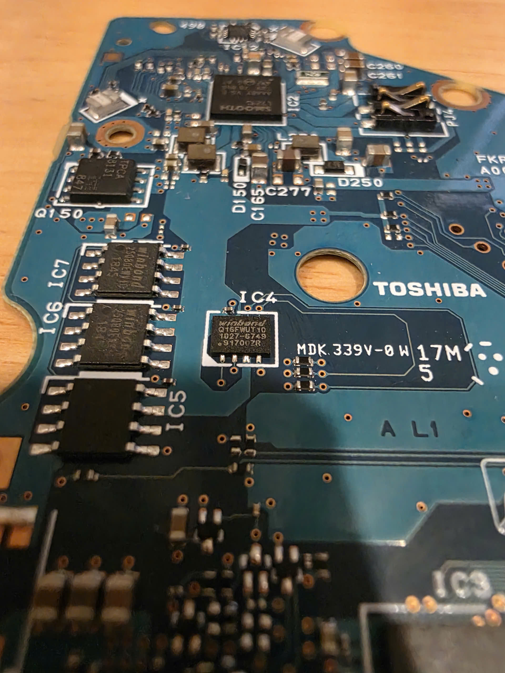

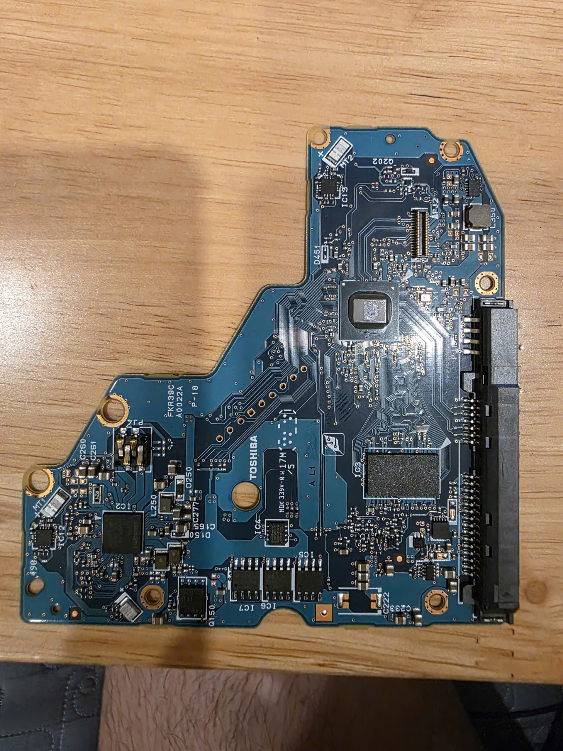

So i got my hands on a Spare PCB G0022A as well

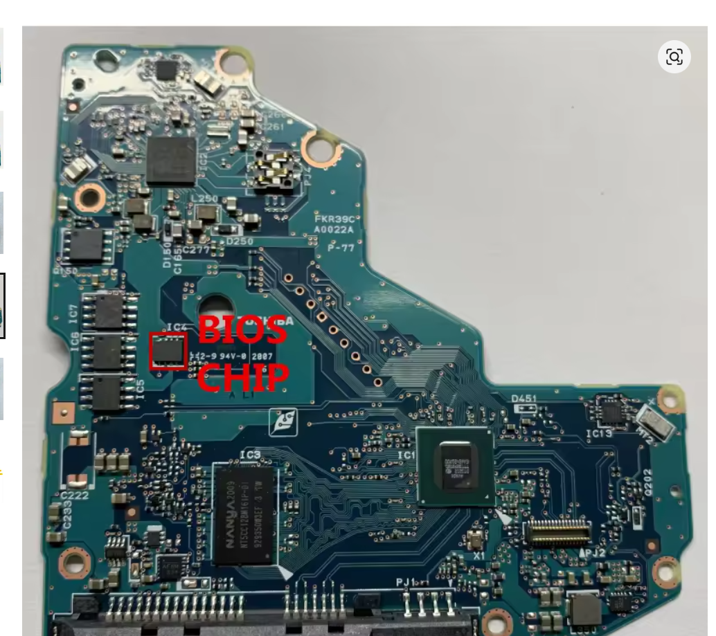

Can anyone help me identify which is the ROM chip?
I will also provide with Original PCB ROM file, Doner G0044A ROM file and Doner PCB G0022A file. If anyone can help me out check the ROM files. Find the difference and fix the Original PCB ROM. Please let me know.
Many thanks!!
 Post subject: Re: Toshiba MG07ACA14TE Stuck in BSY. Maybe need a ROM fix
PostPosted: May 1st, 2026, 13:03
Posts: 16960
I can extract the CPs from the ROM and test their checksums, at least in earlier models.
The additional ROMs appear to be for power loss data protection, although I would have expected to see a bank of backup capacitors.
Pardon me. So which one is the ROM?
PostPosted: May 1st, 2026, 13:55
Posts: 16960

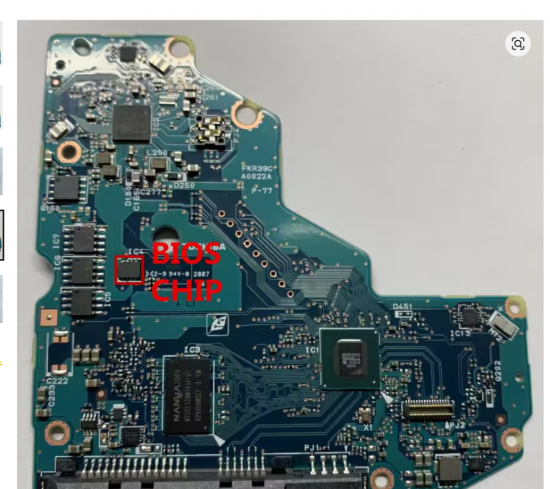

I think it's IC4, probably on both PCBs.
https://ae-pic-a1.aliexpress-media.com/kf/Hfa18982b7eb947d48e7a39c653df0108W.jpg
PostPosted: May 1st, 2026, 14:12
Posts: 203
Location: Vietnam

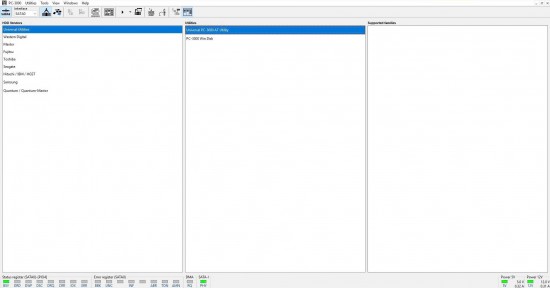

Yeah, you are right
I will read the chip and upload it here tomorrow. Thanks for taking a look for me!
PostPosted: May 1st, 2026, 15:33
Posts: 16960
Your donor is an MN08, not MG07. :-?
PostPosted: May 1st, 2026, 19:00
Posts: 4753
backup caps are absent coz drive can recover sufficient power from rotating spindle i think.
PostPosted: May 1st, 2026, 19:51
Posts: 16960
There is a large unpopulated location for a backup capacitor, but there are several smaller ones in parallel.

This model has a new architecture. The CPs, assuming that's what they are still called, appear to begin at offset 0x100000.
Offset(h) 00       04       08       0C
00100000  53545550 00000000 00000000 10000000  STUP............
00100010  00000000 00000000 00000000 00000000  ................
00100020  9DABAAAF FFFFFFFF FFFFFFFF FFFFFFFF  .«ª¯ÿÿÿÿÿÿÿÿÿÿÿÿ
00100030  FFFFFFFF FFFFFFFF FFFFFFFF FFFFFFFF  ÿÿÿÿÿÿÿÿÿÿÿÿÿÿÿÿ
00100040  5345524E 00000000 00000000 0C000000  SERN............
00100050  5A393430 4130304A 46393447 C01715F0  Z940A00JF94GÀ..ð
00100060  FFFFFFFF FFFFFFFF FFFFFFFF FFFFFFFF  ÿÿÿÿÿÿÿÿÿÿÿÿÿÿÿÿ
00100070  FFFFFFFF FFFFFFFF FFFFFFFF FFFFFFFF  ÿÿÿÿÿÿÿÿÿÿÿÿÿÿÿÿ
00100080  57574E20 00000000 00000000 08000000  WWN ............
00100090  50000399 D8C89AE5 79DF1361 FFFFFFFF  P..™ØÈšåyß.aÿÿÿÿ
001000A0  FFFFFFFF FFFFFFFF FFFFFFFF FFFFFFFF  ÿÿÿÿÿÿÿÿÿÿÿÿÿÿÿÿ
They appear to have a 16-byte header, a body of data, and a 32-bit checksum.
This appears to be the serial number:
           name                        size
00100050  5A393430 4130304A 46393447 C01715F0  Z940A00JF94G....
                data                 checksum
The size dword reflects the size of the data, not the whole CP.
The checksum is calculated so that the sum of all 32-bit little-endian dwords, including the checksum dword, is 0x00000000.
I still have an ongoing medical emergency (not mine), so it will take me some time to write a new tool to extract and verify the CPs.
That said, doesn't the fact that the drive spins up suggest that the ROM is OK? Surely if the ROM was bad the firmware would produce a no-spin symptom?
The area from 0 to 0xFFFF appears to be reserved for a flash loader. The checksum dword is calculated so that the sum of all 32-bit little-endian dwords, including the checksum dword, is 0x00000000.
00000000  5647525F 464C4452 00000000 97000000  VGR_FLDR........
00000010  08190021 00000000 00000000 00000000
          size of loader excluding checksum dword = 0x1908
000000E0  38D09FE5 1EFF2FE1 436F7079 72696768  8Пå.ÿ/áCopyrigh
000000F0  74284329 546F7368 69626120 436F7270  t(C)Toshiba Corp
00000100  6F726174 696F6E20 32303135 00000000  oration 2015....
00001780  D0000098 0050049E 0A5B4546 5553455D  Ð..˜.P.ž.[EFUSE]
00001790  20415653 20566572 73696F6E 20657272   AVS Version err
000017A0  6F722E20 25303858 00000000 0A5B4546  or. %08X.....[EF
000017B0  5553455D 20534153 2D534154 41206469  USE] SAS-SATA di
000017C0  7374696E 6374696F 6E206572 726F722E  stinction error.
000017D0  20253038 58000000 0A5B4546 5553455D   %08X....[EFUSE]
000017E0  20415653 20636865 636B7375 6D206572   AVS checksum er
000017F0  726F722E 20253038 58000000 0A5B4546  ror. %08X....[EF
00001800  5553455D 20444443 20657272 6F722E20  USE] DDC error.
00001810  25303858 00000000 0A5B4546 5553455D  %08X.....[EFUSE]
00001820  20415653 2056616C 75652065 72726F72   AVS Value error
00001830  2E202530 38580000 234910B5 04460868  . %08X..#I.µ.F.h
00001900  23F10CC1 94A42880 47EDCE48 00000000
                            checksum dword
This SEQL area also has a checksum of 0x00000000.
00010000  5345514C 72C49943 00000000 0008F46C  SEQL............
                   checksum dword ?
00010010  10000000 8000FFFF 00000000 010D010D
000110D0  010CFF04 0008F465 0C360000 00000000
000110E0  010D6304 0008F46B 0C360000 00000000
000110F0  00000000 00000000 00000000 00000000
I don't know what this is:
00012F00  00000000 00000000 00BFFE00 00064296
This section appears to identify the firmware in some way. It is absent in the patient.
0001FF00  464D434C 2020414C 46432020 20202020  FMCL  ALFC
0001FF10  71612020 44455432 2D320D0A 436F7079  qa  DET2-2..Copy
0001FF20  72696768 74284329 546F7368 69626120  right(C)Toshiba
0001FF30  436F7270 6F726174 696F6E20 32303137  Corporation 2017
0001FF40  2E30332E 31300D0A 45462F46 452F3045  .03.10..EF/FE/0E
0001FF50  2020533A 30626437 20202020 20202020    S:0bd7
0001FF60  20202020 20202020 20202020 20202020
0001FF70  20202020 20202020 20202020 20202020
0001FF80  20202020 20202020 20202020 20202020
0001FF90  20202020 20202020 20202020 20202020
0001FFA0  20202020 20202020 20202020 20202020
0001FFB0  20202020 20202020 20202020 20202020
0001FFC0  20202020 20202020 20202020 20202020
0001FFD0  20202020 20202020 20202020 20202020
0001FFE0  20202020 20202020 200D0A1A 00000000           .......
0001FFF0  00100000 E0C70A00 EFFE0E00 94C60A00  ....àÇ..ïþ..”Æ..
This is the main code section. It also has a checksum of 0x00000000.
00020000  DC770700 43010000 00240450 1100200E  Üw..C....$.P.. .
00020010  30363031 A4250450 31383235 30363232  0601¤%.P18250622
00020020  00141000 04000100 069A0000 B0040E00
00020030  00000000 00000000 E82A0300 120002F1
000CFFF0  00000000 00000000 00000000 00000000  ................
I haven't worked out what these are:
000E0000  53434844 BC30ADBC 01000200 00000D01  SCHD¼0.¼........
000E0010  4D473037 00000000 53333544 43000000  MG07....S35DC...
000E7FF0  00000000 00000000 00000000 00000000
000E8000  B80BB80B B0040000 00000000 630A0014  ¸.¸.°.......c...
000E8010  46000000 00000000 09143075 F401503C  F.........0uô.P<
000E8100  464D4D47 303706E0 00000000 00000000  FMMG07.à........
000E8110  00000808 A2DB1600 4A563380 280EE3FF  ....¢Û..JV3€(.ãÿ
000EFFF0  00000000 00000000 00000000 00000000
000FBFF0  FFFFFFFF FFFFFFFF 504F4544 01000000  ÿÿÿÿÿÿÿÿPOED....
000FC000  574C4644 01000000 5A820000 02000000  WLFD....Z‚......
000FCFE0  00000000 00000000 00000000 00000000
000FCFF0  574C4644 01000000 5A820000 02000000  WLFD....Z‚......
000FD000  574C4644 01000000 59820000 01000000  WLFD....Y‚......
000FD010  0000037C 4850574C 01068806 006488F2  ...|HPWL..ˆ..dˆò
000FDFE0  00000000 00000000 00000000 00000000
000FDFF0  574C4644 01000000 59820000 01000000  WLFD....Y‚......
000FE000  0B824404 38240100 8D6B0A00 69943202
000FF000  434C4E54 00000021 00000000 FFFFFFFF  CLNT............
These two sections have a checksum of 0x00000000.
000FF010  4D504348 00000008 00000000 B3AFBCAF  MPCH............
size including checksum dword        checksum dword
000FF020  4D532020 00000608 4D532020 08000000  MS  ....MS  ....
000FF030  00000000 000002D8 00000075 05000000  .......Ø...u....
000FF620  00000000 00000000 43010000 70ABD9D7
                                     checksum dword
So from the known parts of the ROM. Everythings seems to be fine?!
