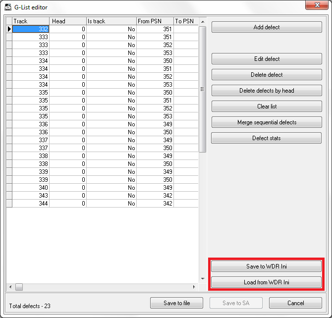

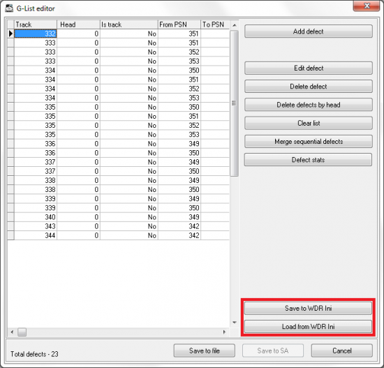

Exactly the same: transfer defects from the g-list to the p-list, run the internal format with a regeneration of the translator. There are some bugs in the program itself or in the hard drive firmware that could cause the p-list to be completely cleared after this, or corrupt the modules on the drive.
If the drive refuses to cooperate, you can manually extract the defects from the g-list, clean it, or restore it from a restore point, export the p-list to a file, insert the defects from the g-list, and then load all this work back onto the drive. There shouldn't be any problems, you can even power cycle the hard drive. And then, as usual, the internal format with regeneration of the translator.
Simply put, you need to replace the p-list on the drive with a manually edited one. The INI file format is very simple. With 90 defects, you can either enter them manually, ask the AI ​​to do it for you, or write a script. There were already ready-made programs for this somewhere, but now it's much easier to ask the AI ​​to create one than to search online. :lol: :lol: :lol:

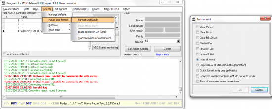

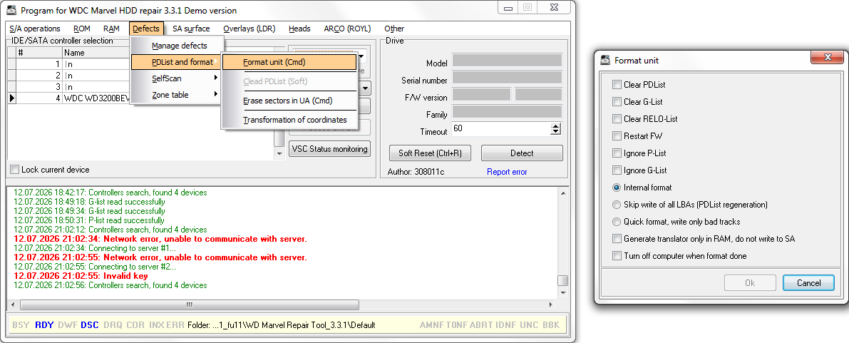

SA surface->Format SA->SA Translator regeneration (ID30) the directory structure for the modules is lost.
Why are you doing this to the service area translator? You need to regenerate the USER area translator. Yes, these are two different entities - the service area also needs to somehow convert physical clusters and tracks into a list of sectors, and it can also have defects. But that's not what you need now. The service area is fine, we need to hide the defects from the user area.
It's not surprising that problems with modules occur in this case.

If you are using a button layout, this option is hidden here.
To save time, you can select the "Skip write of all LBAs (PDList regeneration)" option. The program will pretend to do nothing for a few minutes, but the result will be exactly what you need. If any errors occur, simply try the internal format.
