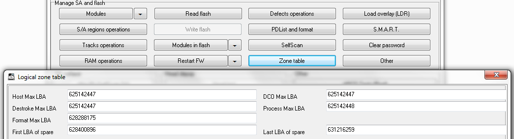

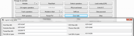

if I set the capacity size to the one on the drive label (shrinking the capacity by 270MB), do I need to do anything so the unused non-defective space goes back into the spare capacity for bad sector replacement?
No, sectors for replacement are taken from spare tracks inside minizones or spare sectors inside a track - it doesn’t really matter. This doesn't affect anything. It is advisable to configure the capacity as on the label just for cases when you have to clone a disk or use it in a raid array - this was a problem in the days of 40 gigabyte hard drives, when due to extra or missing megabytes it was necessary to look for identical drives.

In this case, it's probably easier to perform an internal format first and then adjust the hard drive capacity. Consider the following statement misleading, but as far as I know, to ensure the capacity is set correctly after the ARCO test, you need to edit it in the script before the test. It's best to ask on the WDMarvel forum; people there run self-scans, ARCO tests, and TREX on their hard drives every day; they'll definitely tell you the reason.
By the way, the drive capacity can be adjusted in either direction. In fact, there's much more extra space than 200 MB; you can check the zone list to see how many spare blocks there are.
Another point why you shouldn't rush to adjust the capacity is that all these tests are designed to be run on new, factory-assembled hard drives. They shouldn't be run on drives that have already been used, and especially not on drives that have sustained any damage. When a hard drive is damaged to the point of "trying to revive it or it's time to throw it in the trash," then yes, these tests are used because manually hiding tens of thousands of defects or correcting sector allocation tables is simply impossible. The correct drive repair method in this case would be different: try to preserve the original service area data to avoid losing factory calibrations, defect lists, and so on. Then, manually identify problem areas and enter them into the g-list either as individual sectors, with a few good sectors in reserve, or as entire tracks.
Most often, such drives appear to have no further defects, but if you write data to the drive and then leave it unused for several weeks, new defects may reappear when reading.
