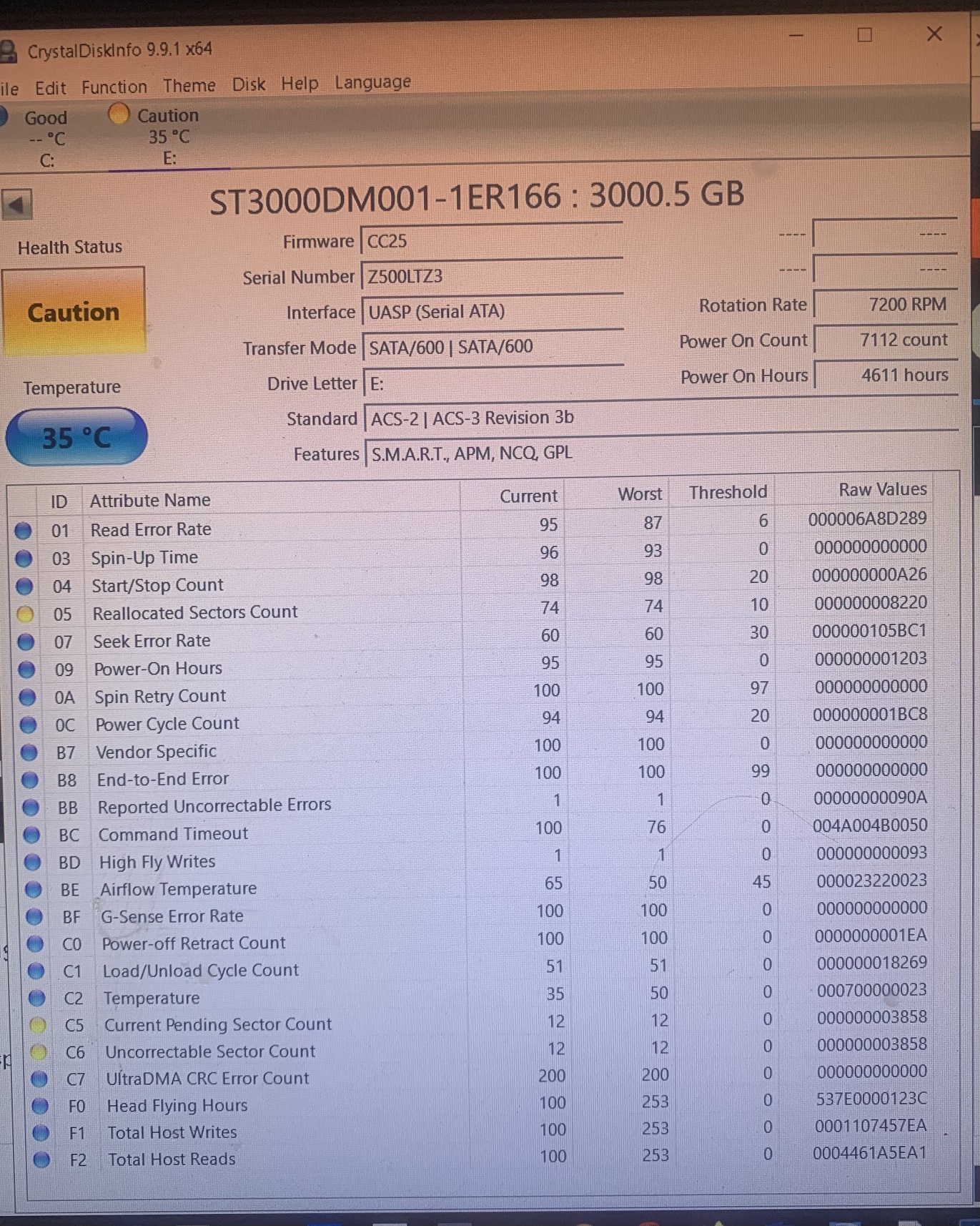

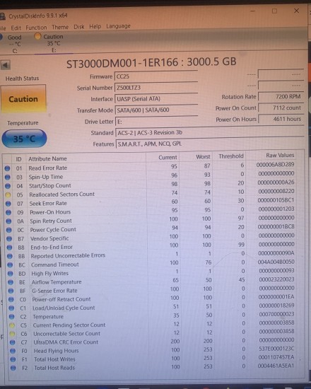

SMART (CrystalDiskInfo)
Health: Caution
Notable attributes:
Reallocated Sectors (05): 2080
Current Pending Sectors (C5): 14168
Uncorrectable Sectors (C6): 14168
Temperature is normal (35°C).

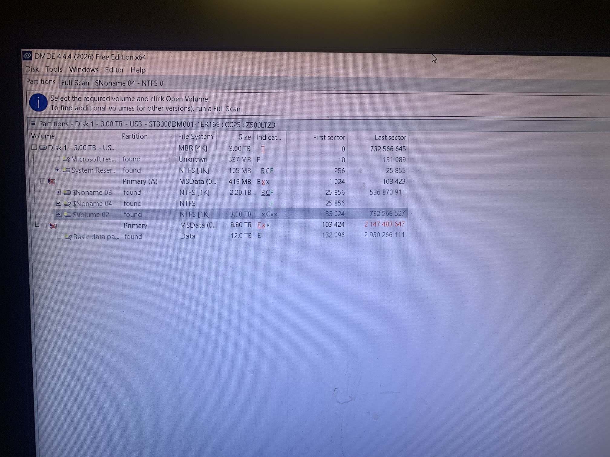

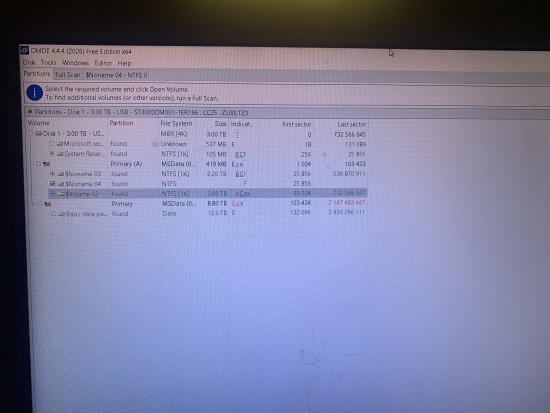

DMDE
Using DMDE 4.4.4.

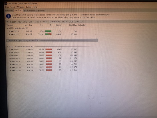

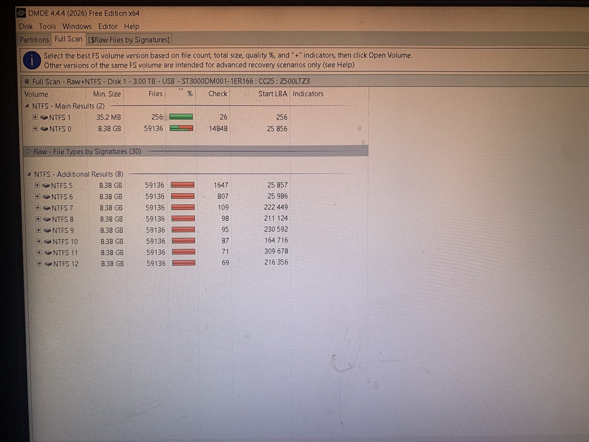

Full scan completed (about two days).

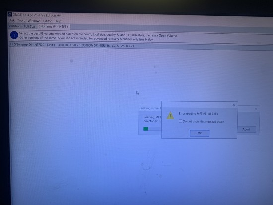

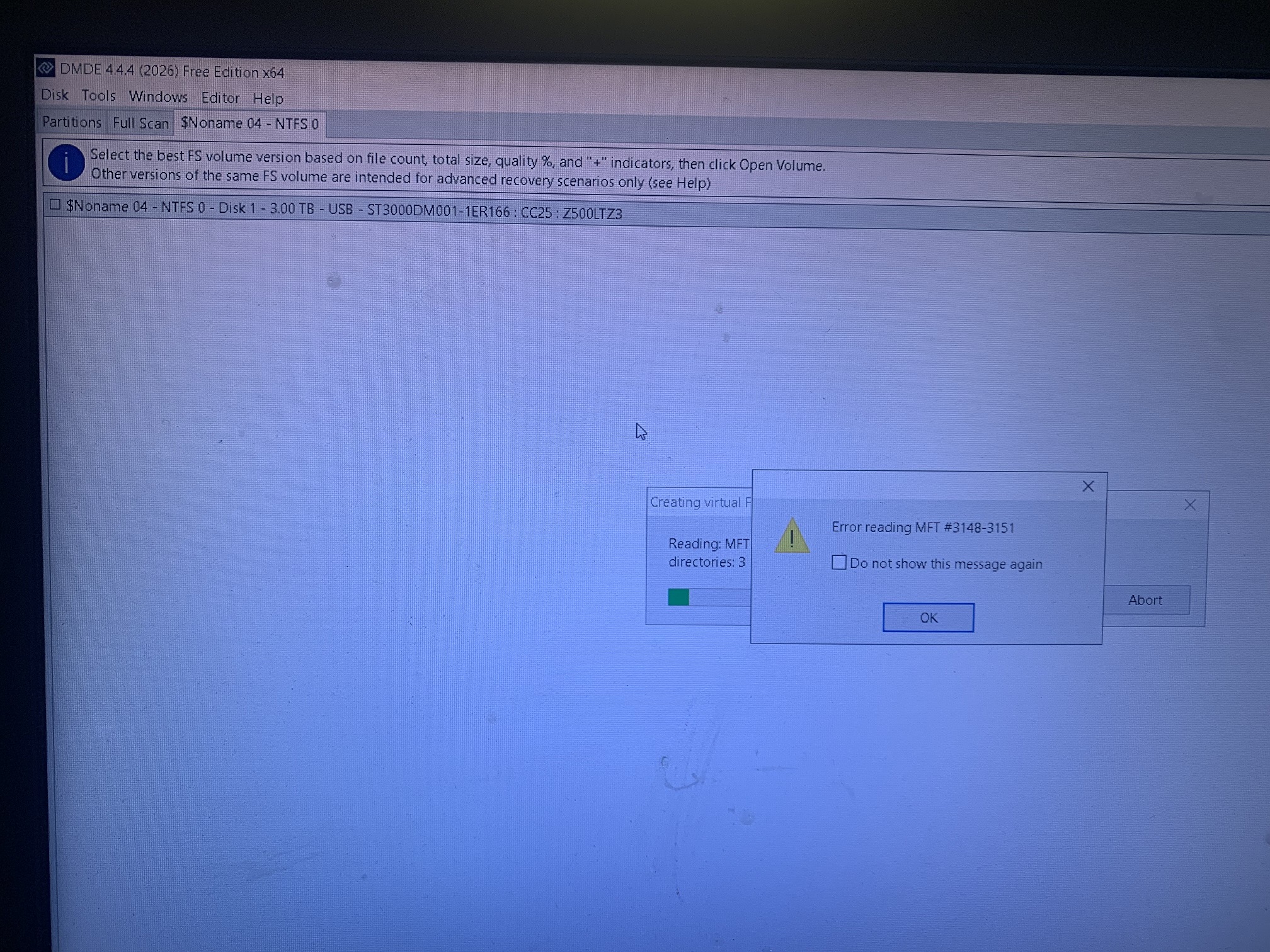

CRC read errors while reading portions of the MFT.
Earlier scans found an approximately 8.38 GB NTFS volume with about 59,000 files.
Current partition display shows several unusual entries, including partitions much larger than the physical drive.
Following advice from another recovery forum, I checked the device parameters.
BPS was already set to 4096, so there was nothing to change.
Current DMDE partition screenshot attached.

Yes, you should first back up your drive with an image, because if it dies during your current operations, you'll be left with nothing.
Looking at the SMART information, you might suspect head/surface degradation, and further scanning of the damaged drive will only worsen the problem.
It would also be best to disable all unnecessary components in module 93. You would need to connect a terminal and check if it's unlocked.
Only after imaging the drive can you begin recovering data from the image/clone.

Yes, please find or buy a new 3TB hard drive and clone the faulty drive first. This model (ST3000DM001) is known to be an extremely unreliable drive (nominee or title of the most unreliable hard drive in the world - check Wikipedia!) - it can fail at any time and data recovery will become extremely expensive.
Also, after cloning, I can recommend using R-Studio; in cases where the file system is severely damaged, this utility does a better job than DMDE. I had a lot of experience with DMDE when entire folders with files were not found and those files that were found were corrupted. I also advise you to try the R.Saver utility - it is free and allows you to restore entire folders, but it also quite often misses a lot of data when the file system is corrupted. Get ready for the fact that restoring photo and video archives will be long and manual work. But again, all this is only after a complete disk cloning.

Attached are photos for reference.
