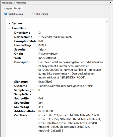

Windows Event Viewer reports:
Event ID 55:
Corruption in:
$R:$INDEX_ROOT
The file reference points to MFT record 26, which DMDE identifies as:
$Extend\$Reparse

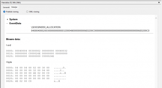

Event ID 50:
Delayed Write Failed for:
$I30:$INDEX_ALLOCATION

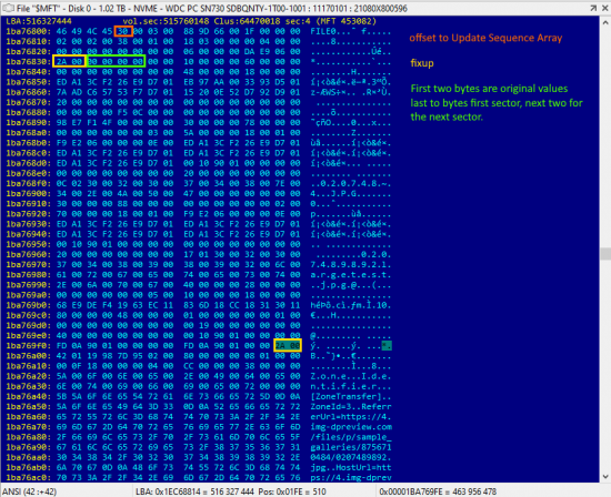

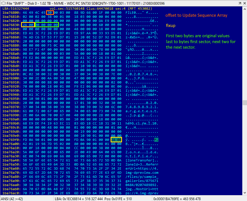

Primary means to detect MFT entry corruption is the fixup value in update sequence array.
So last 2 bytes in each sector should correspond with first 2 bytes you find in update sequence array, in my example 0x2A00
I answered this once on SuperUser, you should be able to read without account:
https://superuser.com/a/1792764/2476335
