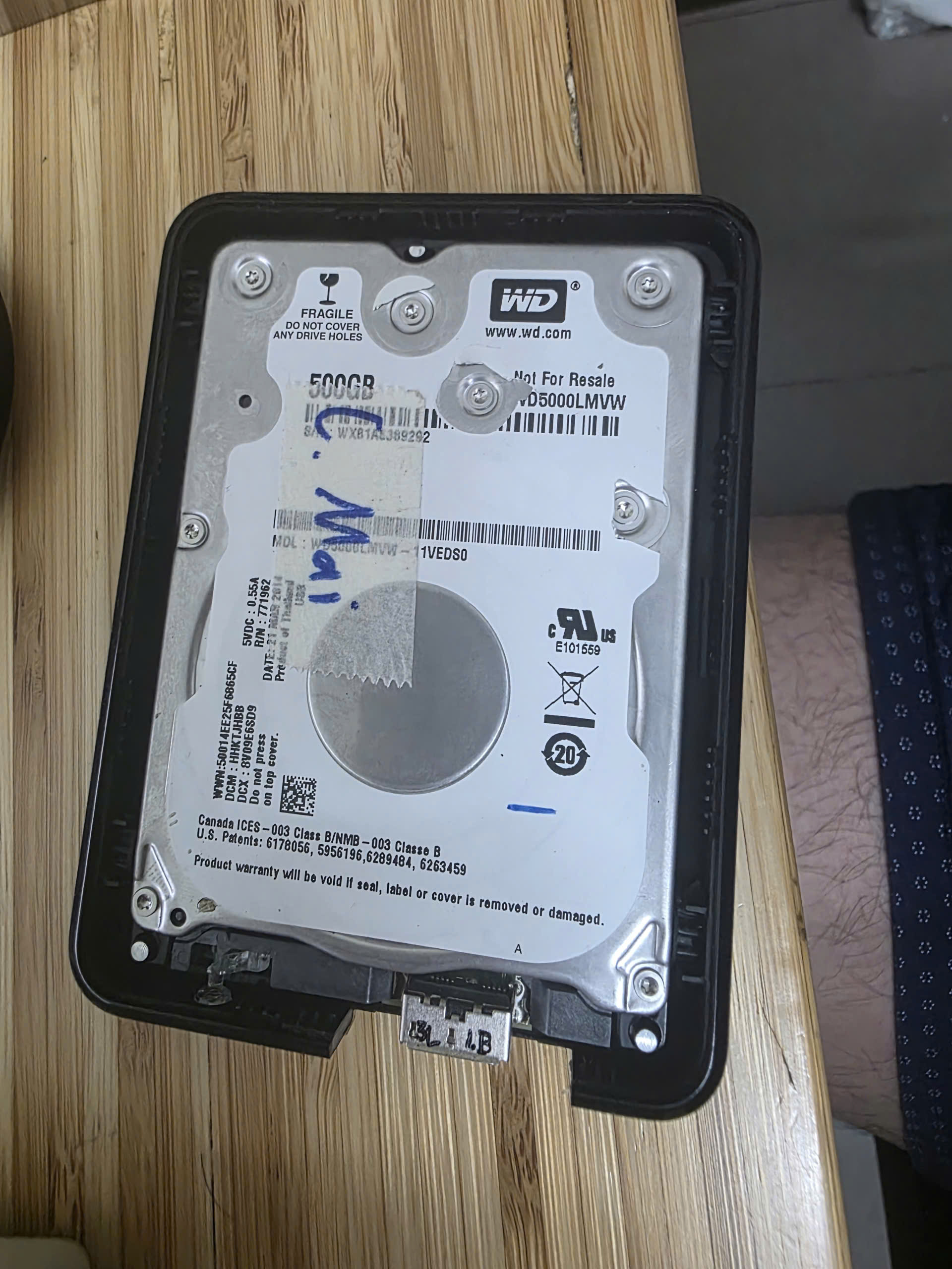

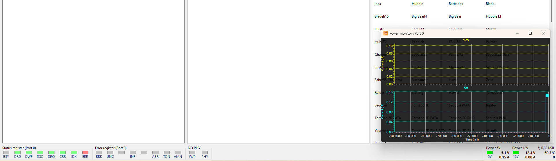

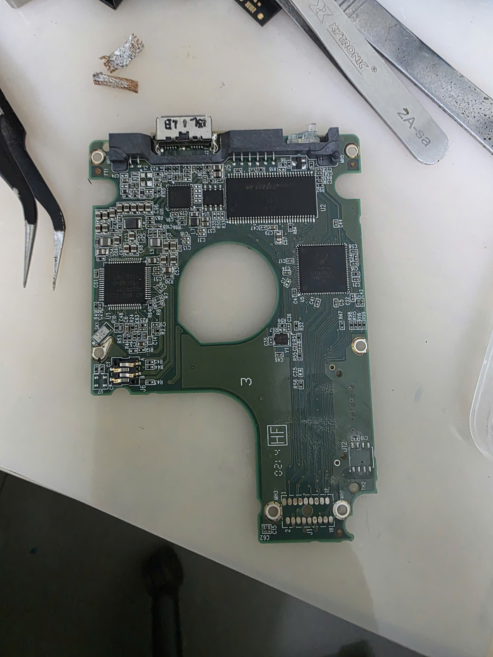

 Post subject: Can anyone check if ROM is Geniune of HDD 500GB WD5000LMVW
PostPosted: Today, 15:14
Posts: 251
Location: Vietnam
Hi everyone. I have this HDD came in with kinda shady summary from both the customer and the repair shop before me
From beginning the customer said that the drive works slowly and stuck when opening folders
Upon recieving the drive. The Drive has already been opened from inside and outside by other repair shop. PCB already have SATA PCB conversion soldering
I confronted the customer and she did said she brought to other repair shops. But after the repair price quote is high she took it back from them
The drive ended up with me
CMAI.jpg [ 651.44 KiB | Viewed 26 times ]
I checked the PCB first. 2060-771692-002 REV A
Soldered SATA conversion and boot it up in PC3000. The PC3000 lights light up like a christmas tree. taking 0.15A on 5V current. The right side Controller getting hot
Screenshot 2026-07-27 015949.png
Screenshot 2026-07-27 015949.png [ 63.74 KiB | Viewed 26 times ]
2aOboQnBdZ5ncKPE6cUc5x4seTV7qfPTid8uOXGS.jpg [ 509.76 KiB | Viewed 26 times ]
1st i thought it was the PCB issue. So i ROM swapped the PCB to the SATA one 2060-771959-000 REV A
But the problem persists. So now i know it is definitelly ROM problem
My thoughts. That the repair shop before me did something to the ROM so it wouldn't be able to boot up anymore
Can anyone check the ROM for me if the other repair shop did something to it?
Many thanks!
https://drive.google.com/file/d/10H-lbVKkTcV0bpFm5vmjkri1sd2CdoEb/view?usp=drive_link
 Post subject: Re: Can anyone check if ROM is Geniune of HDD 500GB WD5000LM
PostPosted: Today, 15:30
Posts: 17090
Firmware Version = 02.01A02
World Wide Name = 50014EE210E7E5D6 <--- does not match label
Model Number = WDC WD10EZEX-08WN4A0 <--- does not match label
Serial Number =
