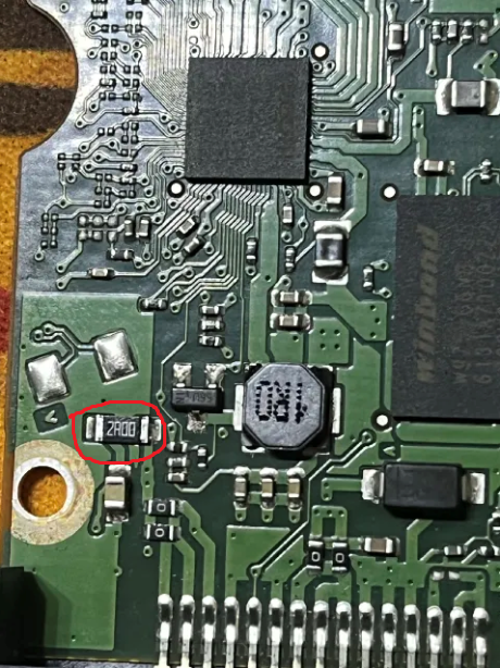

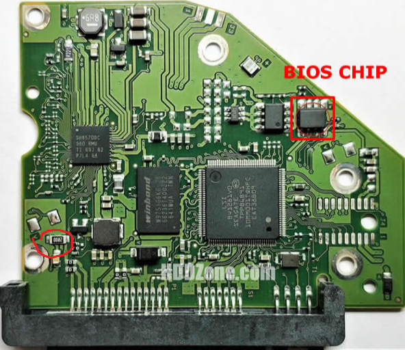

 Post subject: Hey so my hard drive died and im attempting to fix it
PostPosted: August 24th, 2026, 11:26
Joined: August 24th, 2026, 11:13
Location: Egypt
its a seagate hdd 1tb ST1000DM010
and i found this thing that has ZR00 OR 2R00 on it which read different resistances at zero times and it beeps when i use the multimeter for continuity it reads 45,80,70,24 ohms and between and the hard drive died randomly one day and it makes 0 sound when plugged in
any help would be appreciated , pics of the component attached im not sure if thats the TVS Diode or not and ill attach a clear pic i found online of the whole circuit
File comment: whats this ZR00?
Untitled.png [ 687.32 KiB | Viewed 161 times ]
File comment: pic of the whole circuit
whole.png [ 647.49 KiB | Viewed 161 times ]
 Post subject: Re: Hey so my hard drive died and im attempting to fix it
PostPosted: August 24th, 2026, 14:22
Posts: 1308
https://www.digikey.co.uk/en/resources/ ... istor-code
Check the 0 ohm resistors on the 12v and 5v rails near the sata connector for continuity.
 Post subject: Re: Hey so my hard drive died and im attempting to fix it
PostPosted: August 24th, 2026, 23:07
Joined: August 24th, 2026, 11:13
Location: Egypt
Lardman wrote:
https://www.digikey.co.uk/en/resources/conversion-calculators/conversion-calculator-smd-resistor-code
Check the 0 ohm resistors on the 12v and 5v rails near the sata connector for continuity.
they all give me around 1-3 ohms and they beep
 Post subject: Re: Hey so my hard drive died and im attempting to fix it
PostPosted: August 24th, 2026, 23:19
Joined: August 24th, 2026, 11:13
Location: Egypt
Lardman wrote:
https://www.digikey.co.uk/en/resources/conversion-calculators/conversion-calculator-smd-resistor-code
Check the 0 ohm resistors on the 12v and 5v rails near the sata connector for continuity.
oh and the thing that says ZR00 or 2R00 gives me 2 ohms
Users browsing this forum: Google [Bot] and 167 guests
