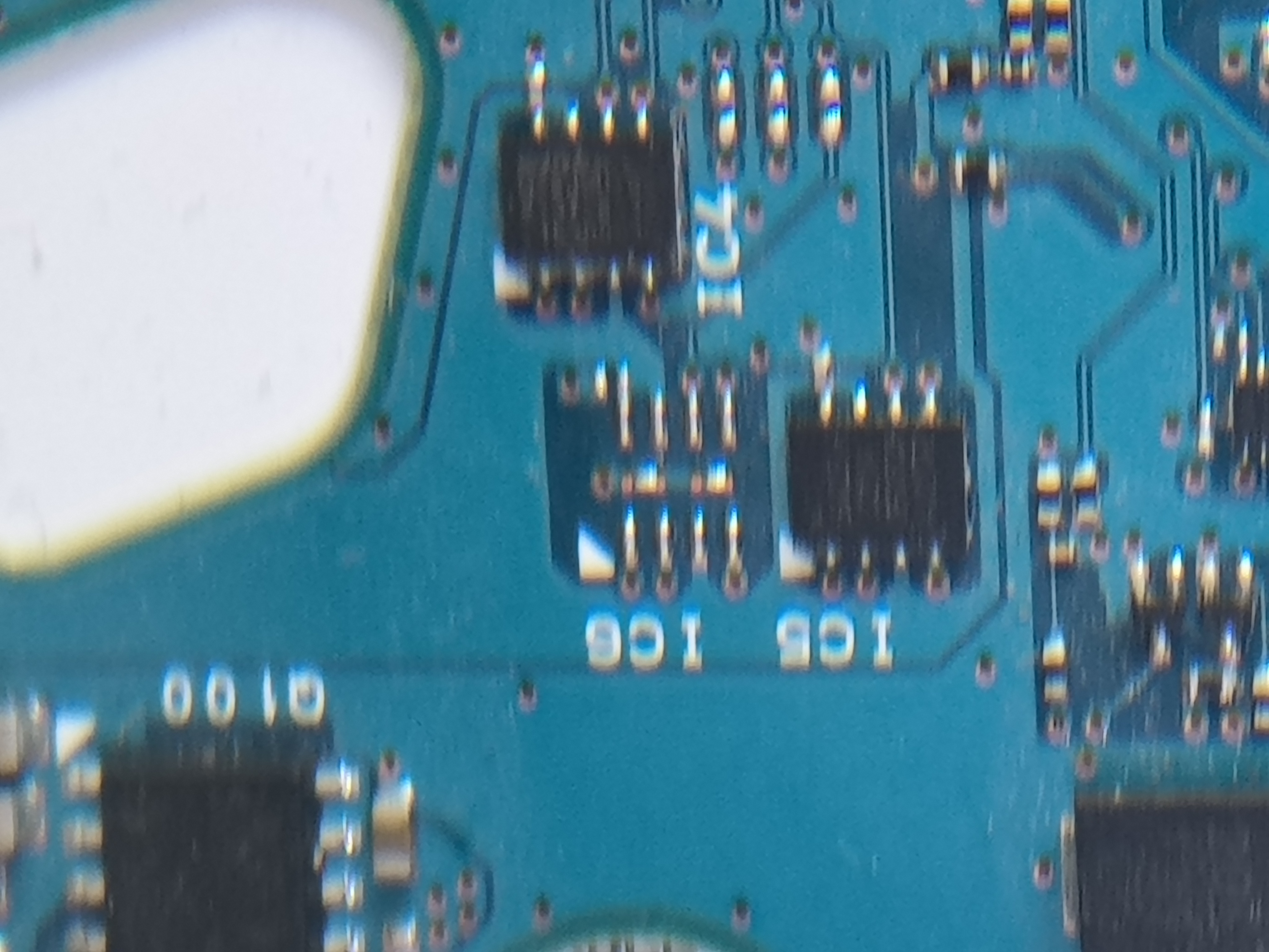

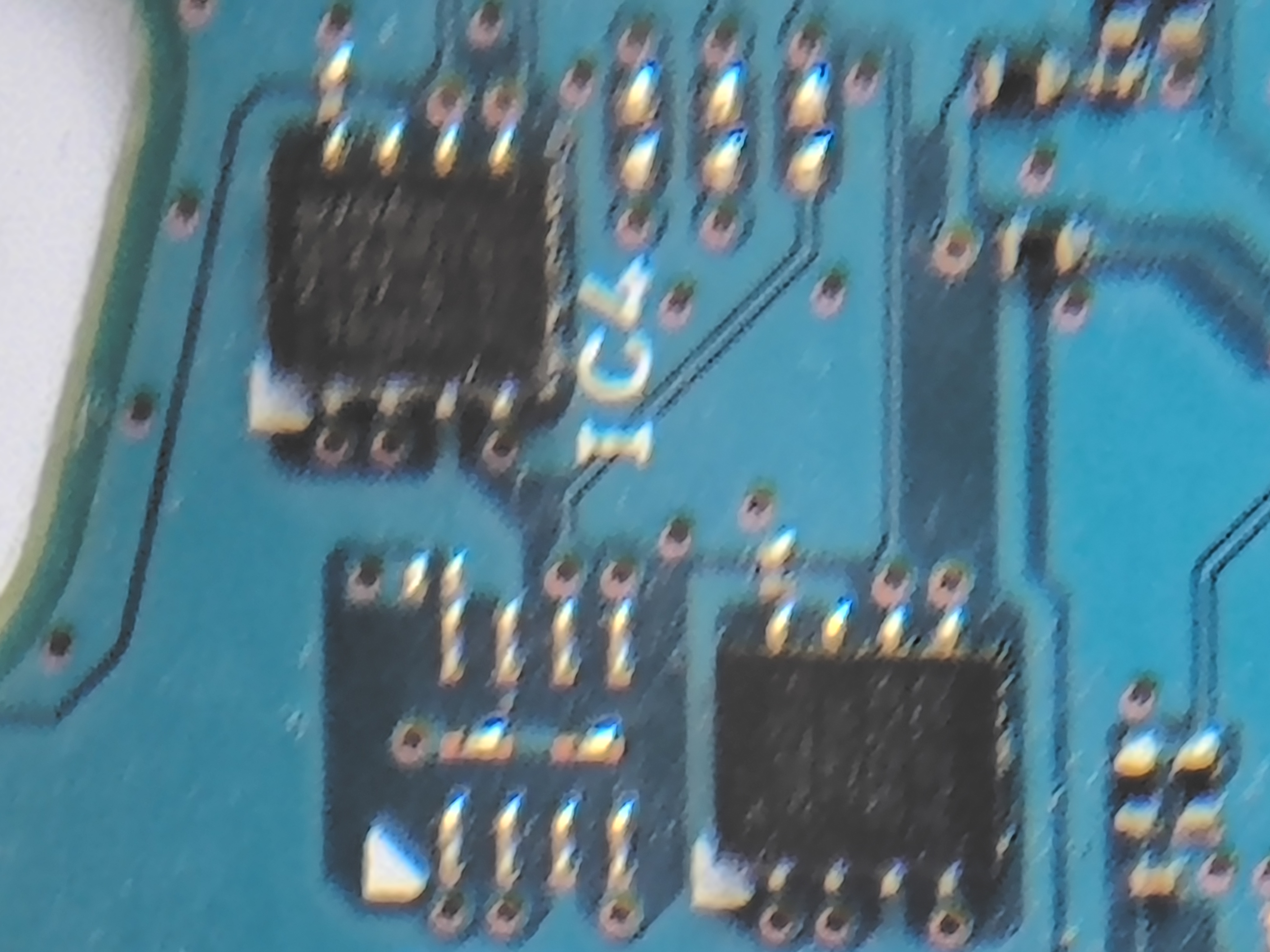

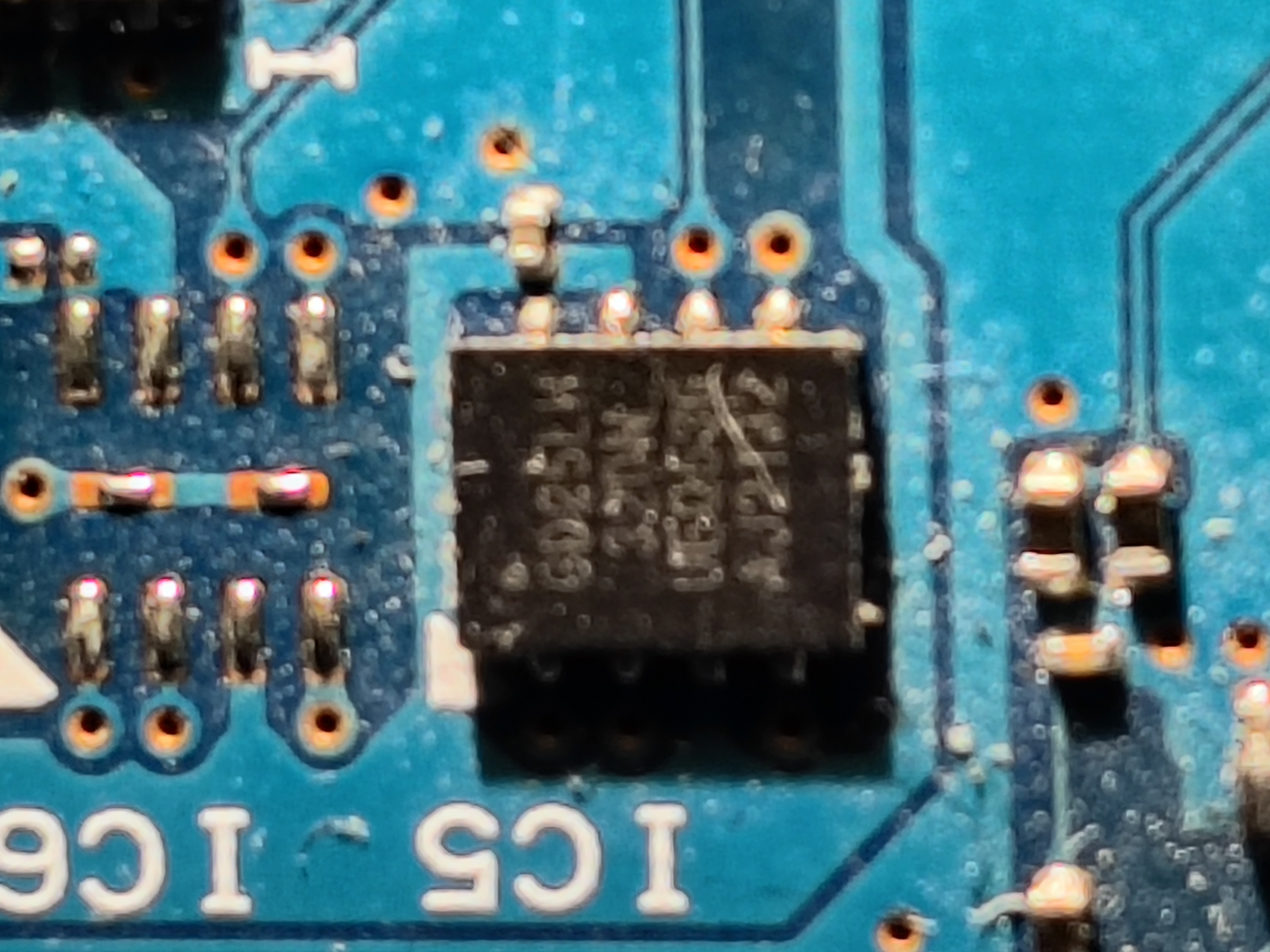

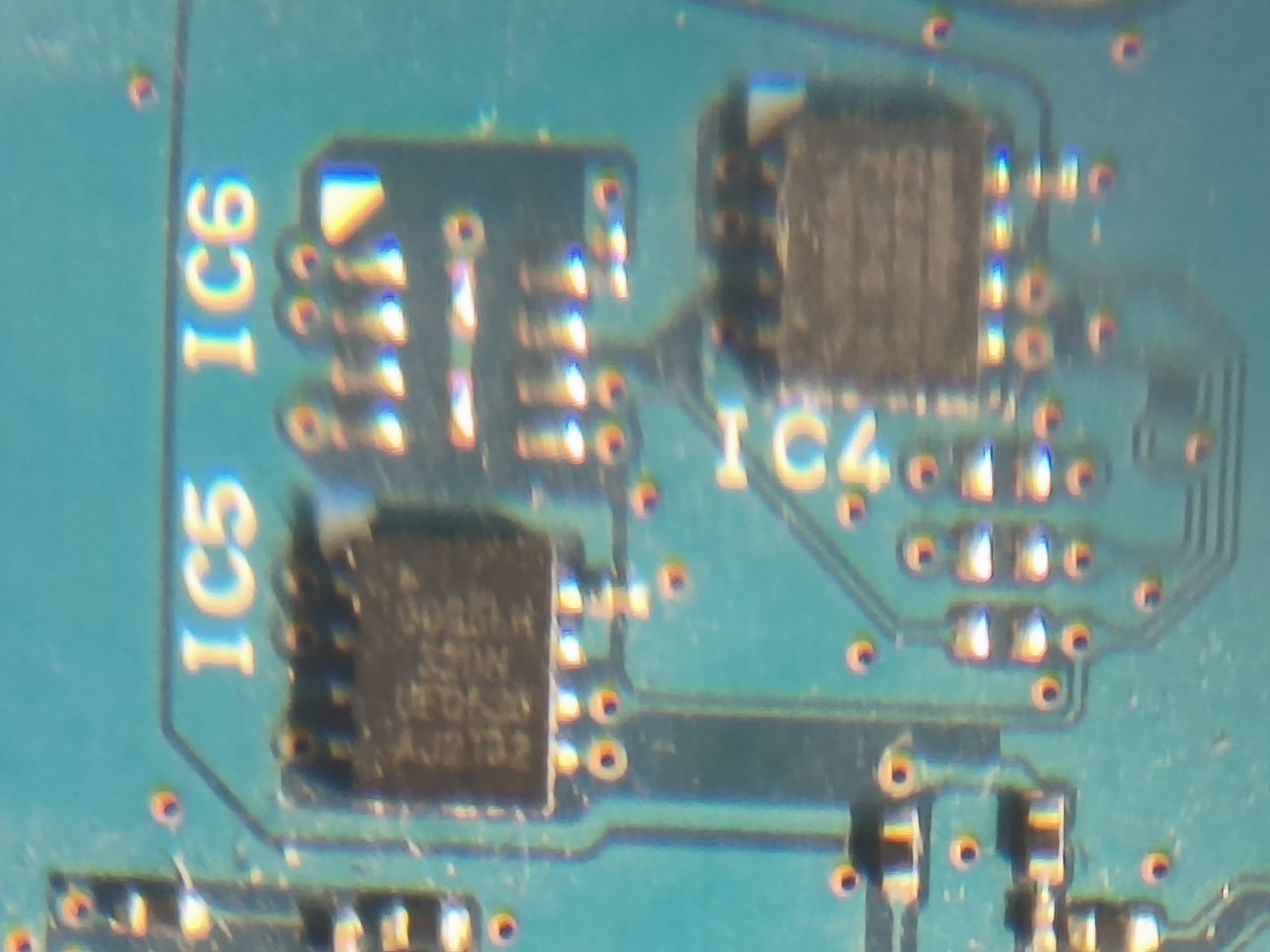

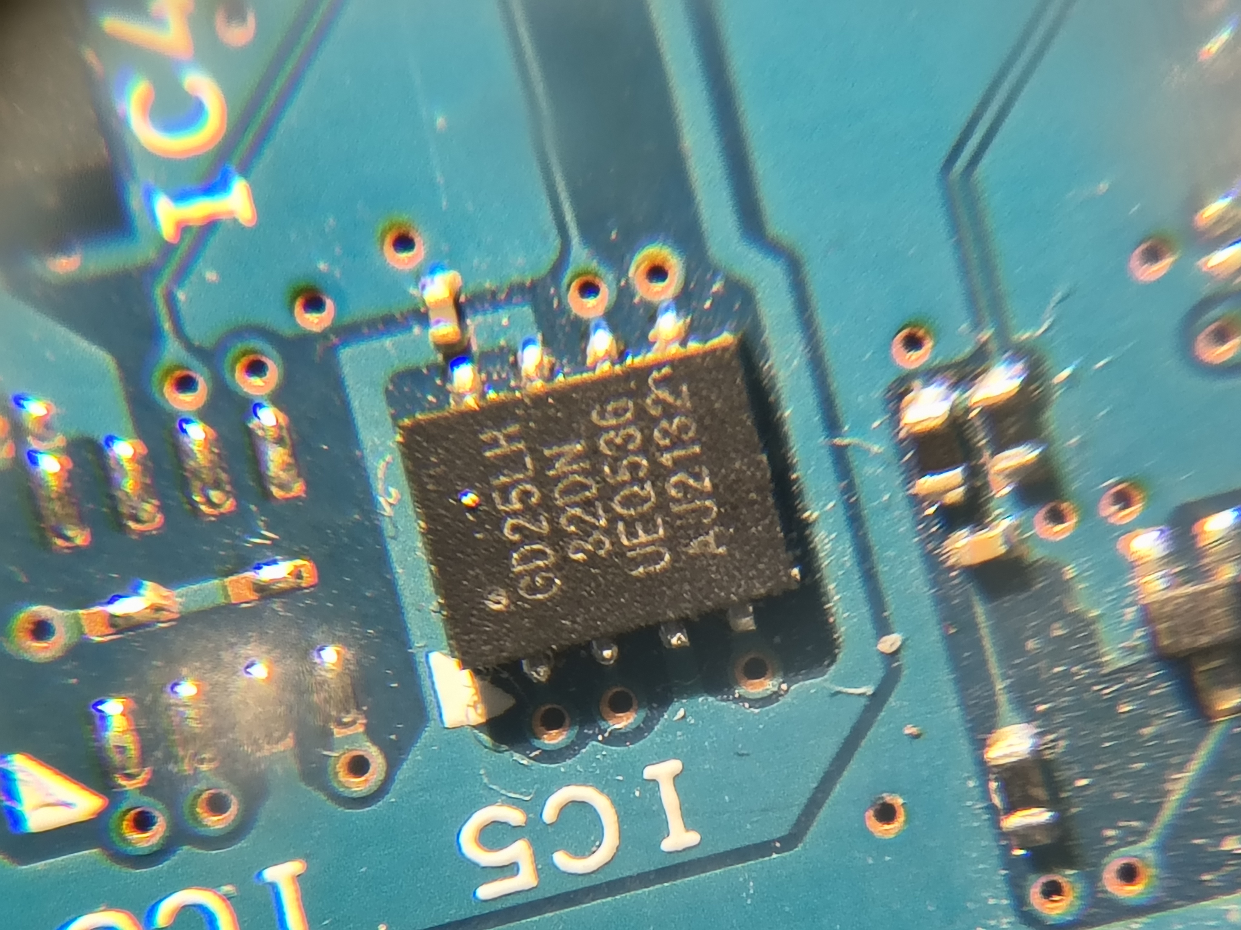

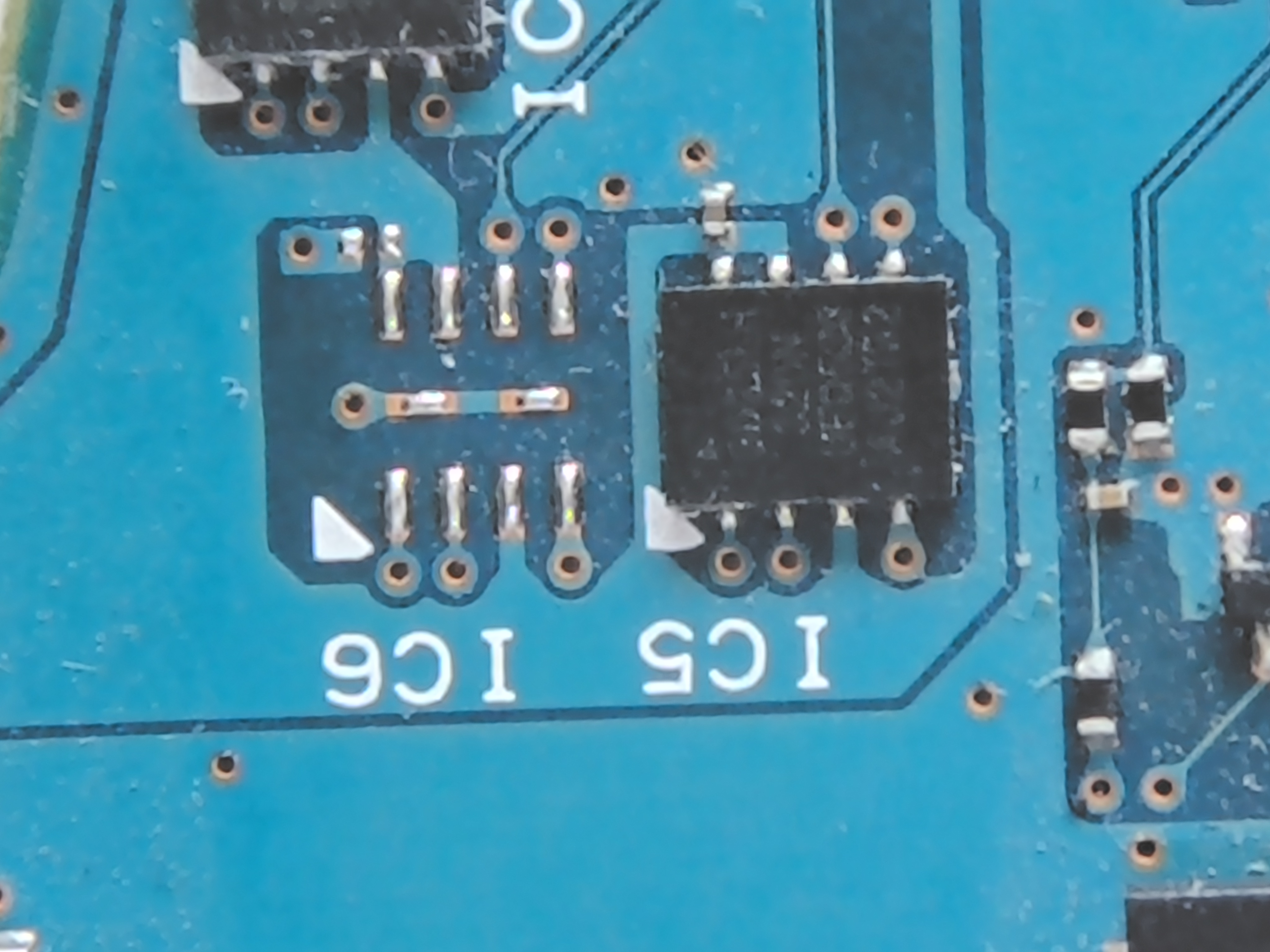

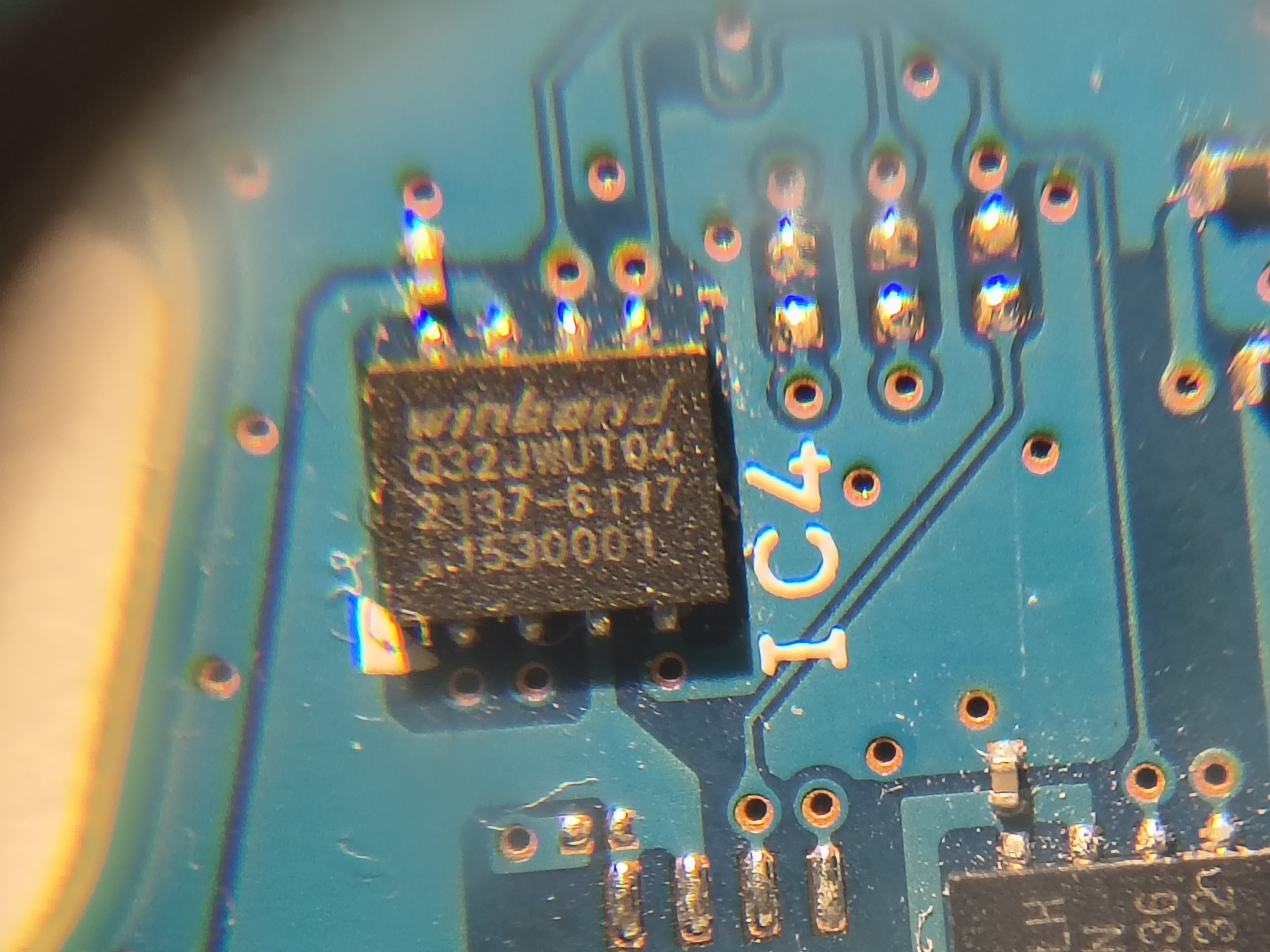

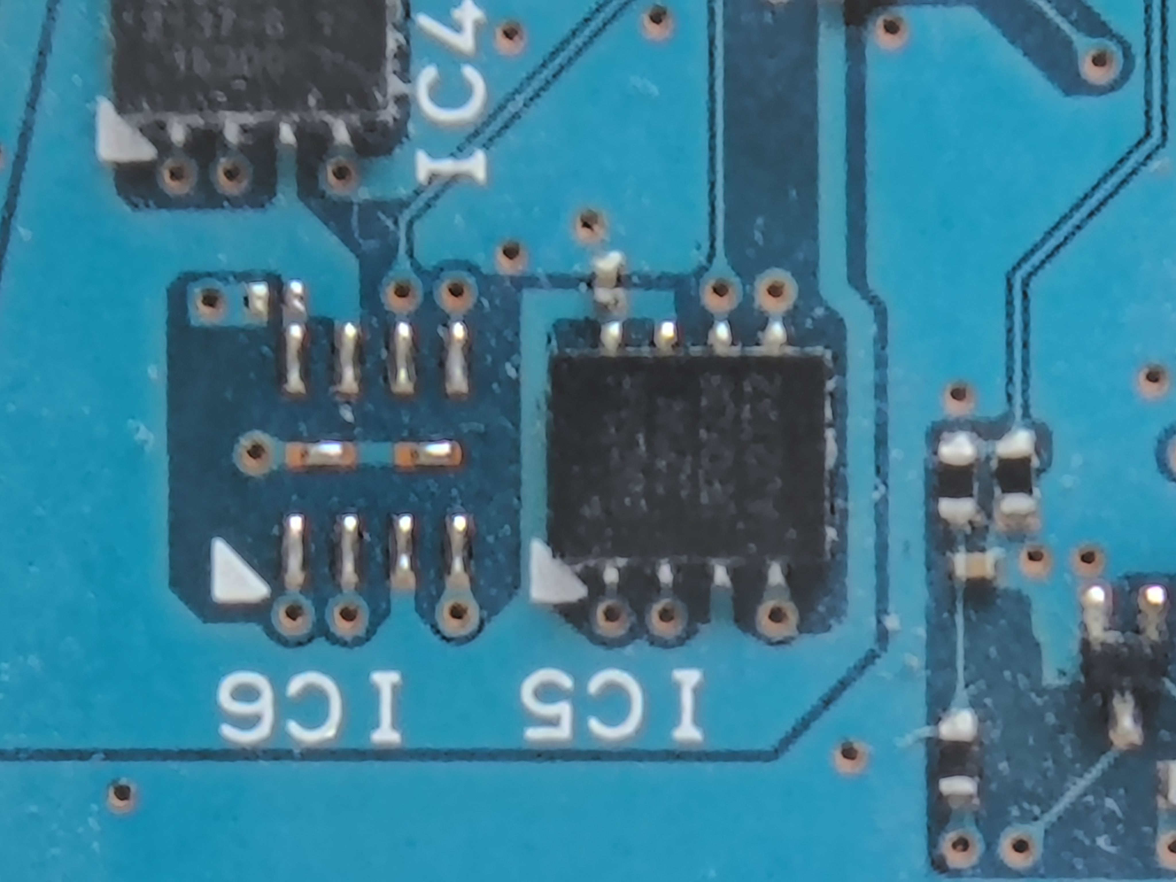

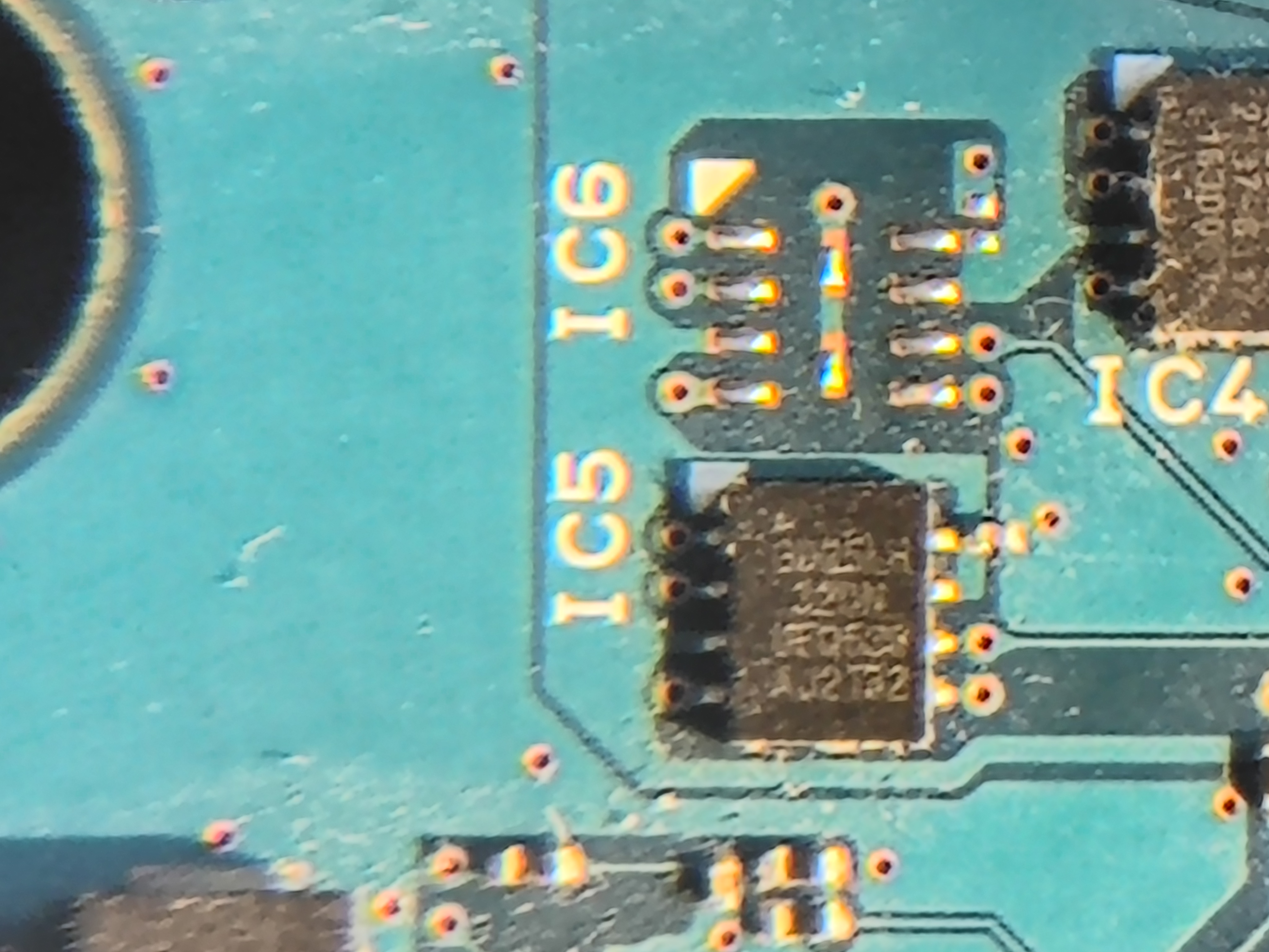

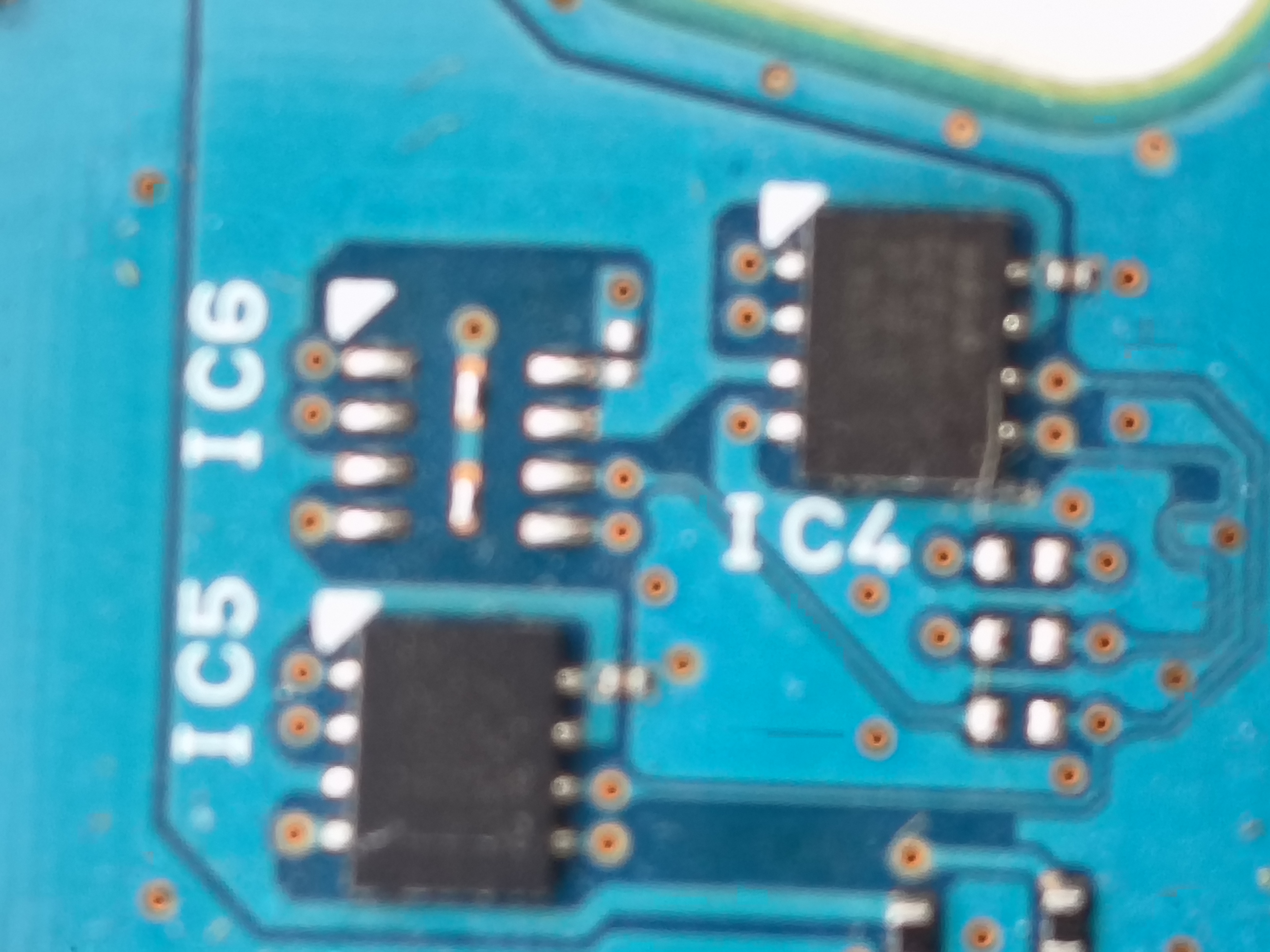

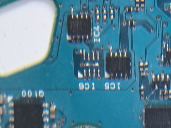

 Post subject: Bios transfer Toshiba MG09
PostPosted: October 14th, 2026, 15:03
Joined: October 14th, 2026, 14:46
Location: Netherlands
Hello, I bought a donor board for the Toshiba MG09ACA18TE (part number G0082A) because broken sata connector. Now I have transfer bios, bevause the drive isn't recognized by the bios of my PC. In this video : https://www.youtube.com/watch?v=QeBnEQvhl84 I see it's is the chip Q100 (0:42), but it's is a TPCA8131, what is a MOSFET: https://www.alldatasheet.com/datasheet- ... A8131.html Does anyone have an idea?
With kind regards,
Rene
 Post subject: Re: Bios transfer Toshiba MG09
PostPosted: October 14th, 2026, 20:52
Posts: 3987
can you take a good photo of your board, and also have you identified other chips that are actually flash memory, maybe IC5?
 Post subject: Re: Bios transfer Toshiba MG09
PostPosted: Yesterday, 2:31
Posts: 17269
Greenman wrote:
In this video : https://www.youtube.com/watch?v=QeBnEQvhl84 I see it's is the chip Q100 (0:42), but it's is a TPCA8131, what is a MOSFET: https://www.alldatasheet.com/datasheet- ... A8131.html
LOL! Yes, that is very stupid. Just another reason not to buy from them.
 Post subject: Re: Bios transfer Toshiba MG09
PostPosted: Yesterday, 7:08
Joined: October 14th, 2026, 14:46
Location: Netherlands
HaQue wrote:
can you take a good photo of your board, and also have you identified other chips that are actually flash memory, maybe IC5?
Thx! I made some pictures, but it was very difficult to make sharp pictures. I upload the here, but I think it's ic4 (it seems to be it's a W25Q32JWBYIM). I will try to do a bios transfer bij onboard flashing with a programmer.
IMG_20261015_123702517_HDR.jpg [ 2.08 MiB | Viewed 275 times ]
IMG_20261015_123702517_HDR.jpg [ 2.08 MiB | Viewed 275 times ]
IMG_20261015_123401079_HDR.jpg [ 1.62 MiB | Viewed 275 times ]
IMG_20261015_123401079_HDR.jpg [ 1.62 MiB | Viewed 275 times ]
IMG_20261015_123327747_HDR.jpg [ 1.6 MiB | Viewed 275 times ]
IMG_20261015_123304397.jpg [ 1.73 MiB | Viewed 275 times ]
IMG_20261015_123227927_HDR.jpg [ 1.6 MiB | Viewed 275 times ]
IMG_20261015_122847838_HDR.jpg [ 1.75 MiB | Viewed 275 times ]
IMG_20261015_122811294.jpg [ 1.69 MiB | Viewed 275 times ]
IMG_20261015_121642355_HDR.jpg [ 1.85 MiB | Viewed 275 times ]
 Post subject: Re: Bios transfer Toshiba MG09
PostPosted: Yesterday, 9:04
Joined: October 14th, 2026, 14:46
Location: Netherlands
Greenman wrote:
HaQue wrote:
can you take a good photo of your board, and also have you identified other chips that are actually flash memory, maybe IC5?
Thx! I made some pictures, but it was very difficult to make sharp pictures. I upload the here, but I think it's ic4 (it seems to be it's a W25Q32JWBYIM). I will try to do a bios transfer bij onboard flashing with a programmer.
I made some better picures.
IMG_20261015_150143664.jpg [ 1.96 MiB | Viewed 261 times ]
IMG_20261015_150115425.jpg [ 2.21 MiB | Viewed 261 times ]
 Post subject: Re: Bios transfer Toshiba MG09
PostPosted: Yesterday, 9:42
Posts: 17269
GD25LH32D, GigaDevice, SPI flash, 32Mbit, 1.65V - 2.0V, SOP-8 / USON-8, WSON-8, WLCSP-8:
https://www.mouser.com/datasheet/2/870/gd25le32d_v2.0_20200612-1668087.pdf
W25Q32JW, Winbond, 1.8V 32M-BIT SERIAL FLASH MEMORY WITH DUAL, QUAD SPI, USON-8:
https://www.mouser.com/datasheet/2/949/w25q32jw_spi_revf_09042018-1489621.pdf
 Post subject: Re: Bios transfer Toshiba MG09
PostPosted: Yesterday, 21:30
Posts: 3987
GD25LH32D, GigaDevice, SPI flash, 32Mbit, 1.65V - 2.0V, SOP-8 / USON-8, WSON-8, WLCSP-8:
https://www.mouser.com/datasheet/2/870/gd25le32d_v2.0_20200612-1668087.pdf
W25Q32JW, Winbond, 1.8V 32M-BIT SERIAL FLASH MEMORY WITH DUAL, QUAD SPI, USON-8:
https://www.mouser.com/datasheet/2/949/w25q32jw_spi_revf_09042018-1489621.pdf
I would have thought this would have been OP's first step. how does one know how to connect a programmer, take dumps, manipulate dumps and reflash if identifying the chip was the hard part?
 Post subject: Re: Bios transfer Toshiba MG09
PostPosted: Today, 6:24
Posts: 17269
I expect that IC4 would be the "ROM" while IC5 and IC6 (unpopulated) could be nonvolatile cache for power loss data protection.
 Post subject: Re: Bios transfer Toshiba MG09
PostPosted: Today, 15:09
Posts: 232
Location: Canada
Winbond typically are writable. The GD25LH32D is likely fixed ROM device. Both look like a standard clip on chip reader can possibly read them both.
The GD25LH32D probably has disk tables when the assembly was made originally. Probably has bad block tables too.
 Post subject: Re: Bios transfer Toshiba MG09
PostPosted: Today, 15:58
Posts: 17269
Hardcore Games wrote:
Winbond typically are writable. The GD25LH32D is likely fixed ROM device. Both look like a standard clip on chip reader can possibly read them both.
The GD25LH32D probably has disk tables when the assembly was made originally. Probably has bad block tables too.
Babblebot.
Users browsing this forum: Google [Bot] and 183 guests
