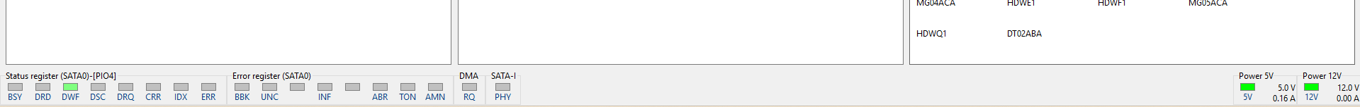

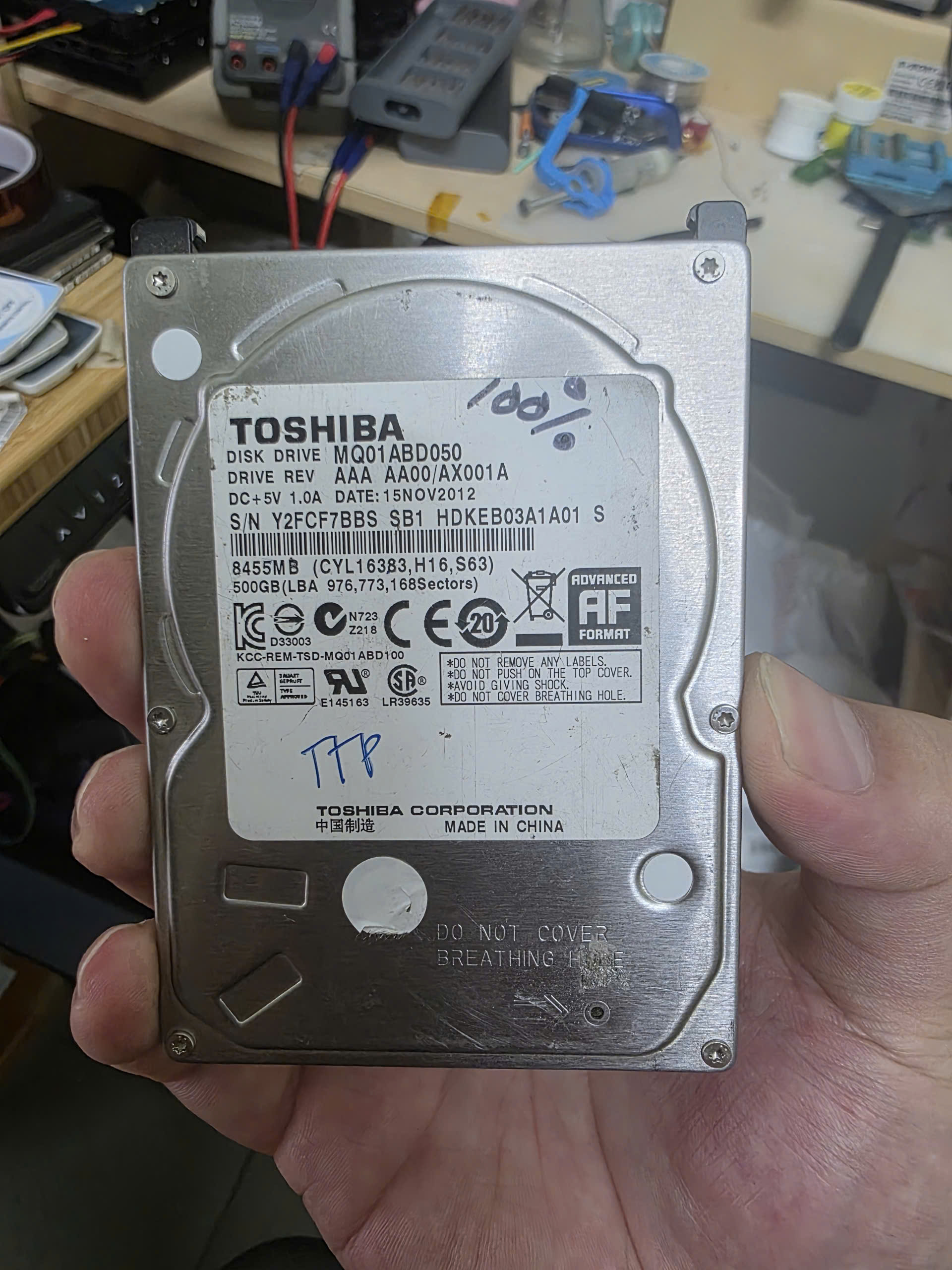

 Post subject: TOSHIBA MQ01ABD050 ROM Problem
PostPosted: Today, 15:20
Posts: 262
Location: Vietnam
Hi everyone!
I have this Toshiba drive
It came in with not original ROM (The drive does spin and gets to Ready status. However the Serial Number and FW are all wrong from the label)
So i got the patient to gimme the original ROM
However when soldering the original ROM on. The drive doesn't even boot up
So i think the ROM must be defective or something
I need some help to check this ROM if there is any problems with it and if can extract the information from it to check if it is the original
Many Thanks!
Screenshot 2026-10-21 021803.png
Screenshot 2026-10-21 021803.png [ 12.83 KiB | Viewed 39 times ]
2aOboR6v0ZPKVf3duA0S5kFIjE3MUpgKzik1bo2K.jpg [ 688.27 KiB | Viewed 39 times ]
 Post subject: Re: TOSHIBA MQ01ABD050 ROM Problem
PostPosted: Today, 15:52
Posts: 17277
How can anyone help you if we can't see your ROM dumps?
