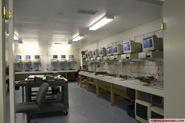

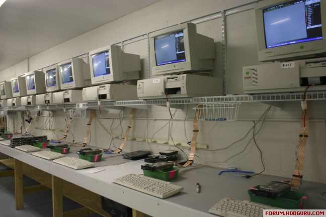

Just got in 750 drives so I thought I would post a picture of our test beds in action with "MHDD". Hope they meet with your approval "Maysoft" :good:

nice setup Reo51st,
750,..sounds like you gonna be busy, lol :wink:

I like green buckets :)
And I see you testing SCSI drives with racks (I think these drives are from servers) is it just regular testing or these drives should be repaired ?

 Post subject: Test and repair.
PostPosted: November 1st, 2006, 11:24
Joined: March 1st, 2006, 14:21
Posts: 44
Location: St. Petersburg Florida
First we test with "MHDD" scan and set aside the ones that fail. After they are all tested we do repairs format,erase,scan with remap etc. With "MHDD" we are at 90%+ success rate of good to bad. We do no internal repairs. The bad ones we just scrap them. Some of the more expensive ones I will do a board swap or component repair. We have not had a single drive returned that has been test or repaired with "MHDD" This is the only test we do now. It is that good and reliable. The drives are IBM E Server X/I/P Series. We also do Compaq, Dell, TravelStar, Fujitsu, Toshiba etc. 50/68/80 pin SCSI. Laptop and desktop IDE drives.
