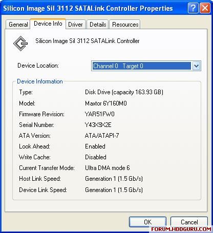

Anyone know how to enable write caching on my drive? (please see attached picture for info)
Thank you in advance.

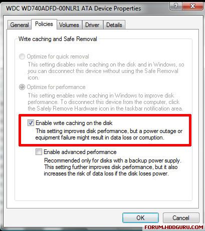

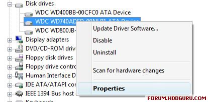

Try going into the drive properties within the device manager, not the controller card.

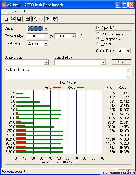

rameez Write caching will enable my hard disk to use its 8MB cache which is currently disabled.

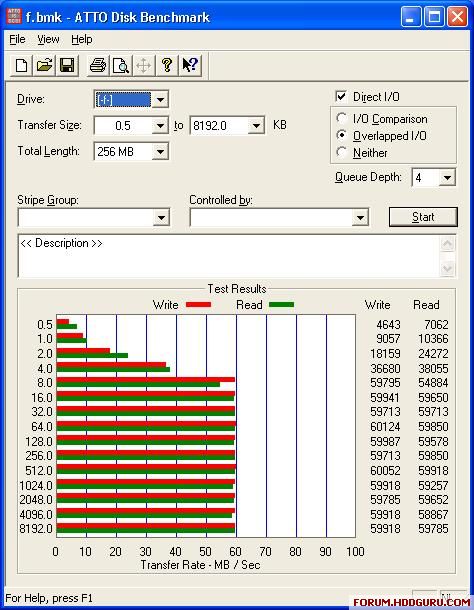

I have a Seagate drive on the same computer with its cache enabled and run ATTO drive benchmark.
Maxtor is unusable (~10MB/s max write)

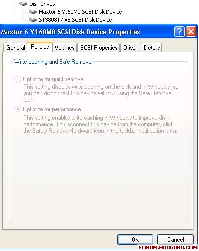

bsnyder that works for ATA drives not SATA take a look below:
Write cache disabled is not a windows issue as when I boot with Hitachi Ftool it reports the Maxtor as Write Cache: Disabled. I can enable the cache exit the program re-enter the program and it still reads enabled. As soon as I restart it is disabled again. The same goes for Read Ahead although that is Enabled on my drive.
Ftool had some use though, I could enable AAM for the maxtor which made it whisper quiet but seek time went through the roof, from 13ms to 19ms, according to HDTach Benchmark so I disabled AAM.

It does work for SATA drives but not, if they are handled through a proprietary driver that interprets SATA drives as SCSI (as in your case).
