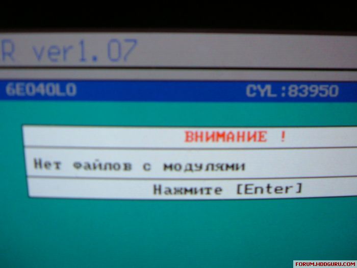

I get this error when I try to write modules or module groups. Anyone know what it means?

u have not modules that u want to write....
they must be in exact subfolder....

Ok, I just had them in the same folder as I run pcmx_pkr from.

If ur using poker drive then u should put all ur rpm and smb file in Mxpkrmod directory . i think the error u have posted means There are no modules in the directory . Dont write the structure modules if they are not bad they might destroy ur hdd .

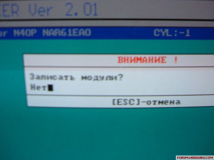

I feel im very close to fixing this but I got 1 more error. I put the modules in the right directory, when I choose to write them I get a list of which ones I want, I select the one I want to replace and press enter then get this message

Yes....the program ask you if u want to write the module....The HET means NO in russian and , if u want to continue, u must press SPACE to change to DA witch means YES in russian and then u can press ENTER to write the module to hdd.

Yes, thankyou, I figured it out by accident. Now im on to a new problem but im not gonna bother anyone with it. I think I give up ( -_-)
