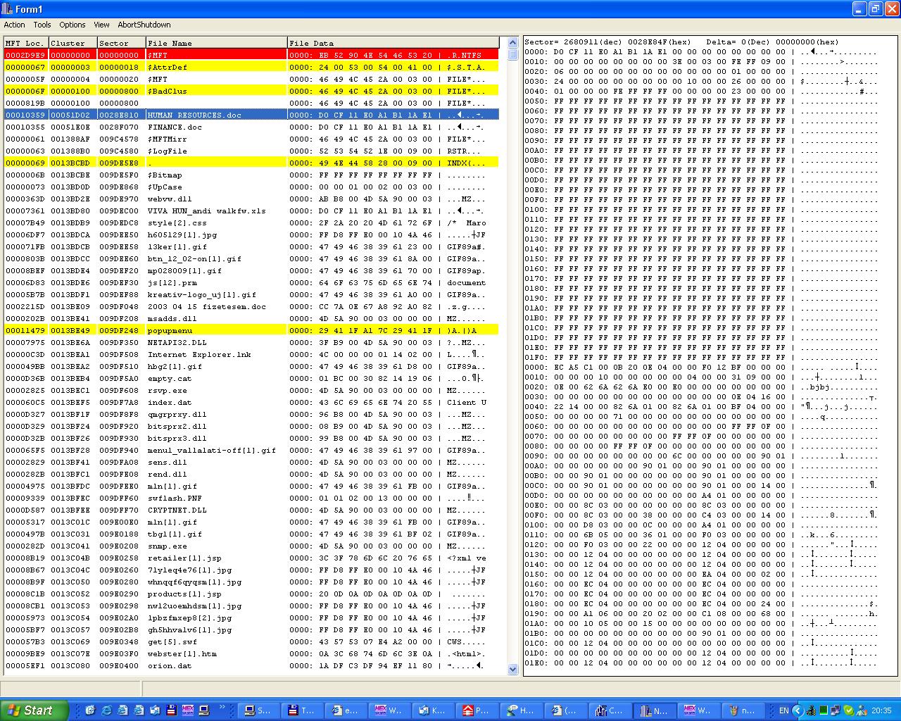

If the PCB is replaced with one with similar adaptives, that the disk will work with many shifts, is there a more convenient way to find the shifts? Is there a way to manually find the location a file should be at, and the location it is actually at and recover it correctly with file names? In many cases customers will require specific and unique files for in-house applications which do not have identifiable headers for RAW data recovery. :(
 Post subject: Re: Toshiba MK6032GSX SATA with burnt CPU
PostPosted: August 21st, 2007, 11:38
Posts: 4806
Of course there is way to find shift points and locate the files, I have written some code to do that. To do this U need to clone the drive, then U have to define partition starts, scan the partition for important file system objects (MFT records, directory entries, inode tables, etc, depending on the FS), then U can locate the files and find shifts from the beginning to the end.

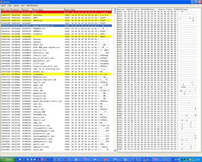

PostPosted: August 22nd, 2007, 17:08
Hi Pepe,
This is custom Software You Have Written For Self Use .Can You share a Snapshot Of the Same .Its Interesting .
PostPosted: August 23rd, 2007, 13:54
Posts: 4806
That's it. :)
File comment: That's it
