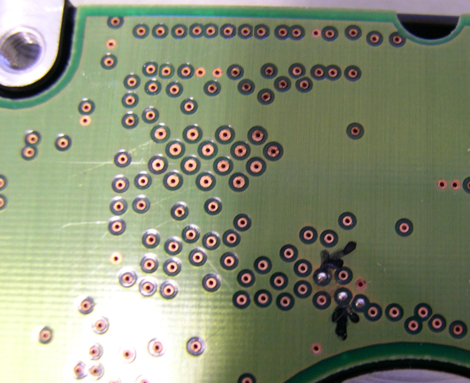

Hi gurus
Where are the pins to remove password on HTS726060M9AT00? is it the same as HTS548 ? i can't seems to get it working....anyone got photo for HTS726060M9AT00 pins?

Did as shown on photo, jumpered pins with arrows, and follow instructions on screen but still does not unlock. :cry:

Hi there,
It's the right place, and you should use your probe not a jumper.
What version do have of your pc3000? Real ACE or chinese crap?

got it working thanks all, one of the probe component is not connected properly.
