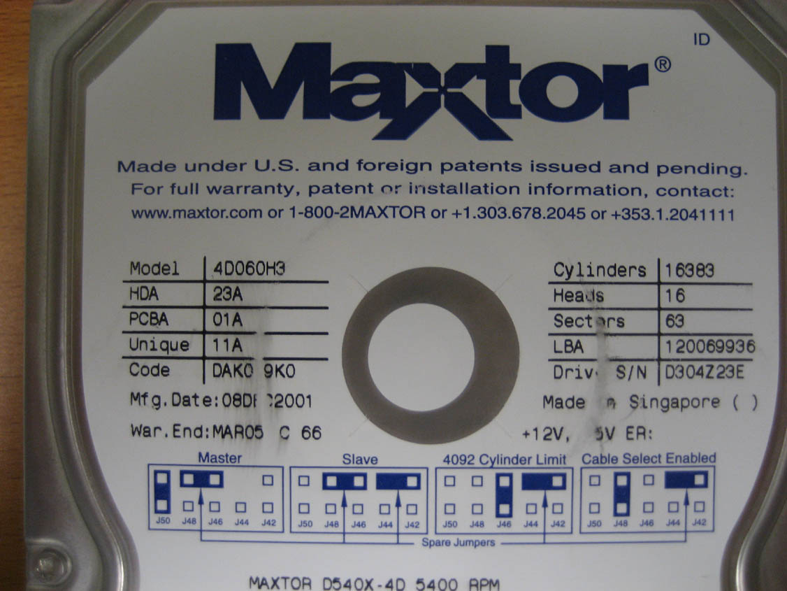

I've got this drive with a bad Pcb.
What criteria is it for change those Pcb's, it's not obvious in the manual.
Shall I just match the cpu chip on the Pcb, or the full model?...or both.
It's an Maxtor D540X-4D060H3, with a Poker C1 chip.
Bosse

Thanks guy's,
So for for replacing Pcb on this one I need the same model and code...is that correct?
Or are there different models with the same FW revision Code?
Unfortunatly one of the numbers for the Code is gone :( ...see picture.
[img]
[/img]
Bosse
http://www.rescue-it.se
 Post subject: Re: Maxtor D540X bad Pcb
PostPosted: October 11th, 2007, 3:37
Posts: 4840
I did not mention the same model, it is ovious.. :)
Your FW code is probably DAK019K0 - this is Poker chipset.
the other frequent version is DAH017K0 - this is DSP.
since they are pretty hard to find these days, U should concert repairing the original PCB.
what is the problem with it?

I've got a DAK019K0, model 4D060H3. However, the LBAs are 117231408 and the HDA, PCBA, etc. don't match. The S/N on the PCB is C5FDB. Poker chipset.
I've also got a 4D060H3 with DAK017K0 - the logic is D2FDA. DSP chipset.
Hi jono-ats,
Since I just need the Pcb for replacement I don't think the LBA and HDA numbers matter...could someone confirm this!
