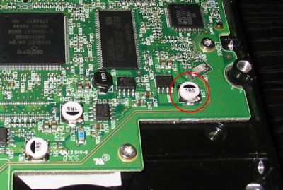

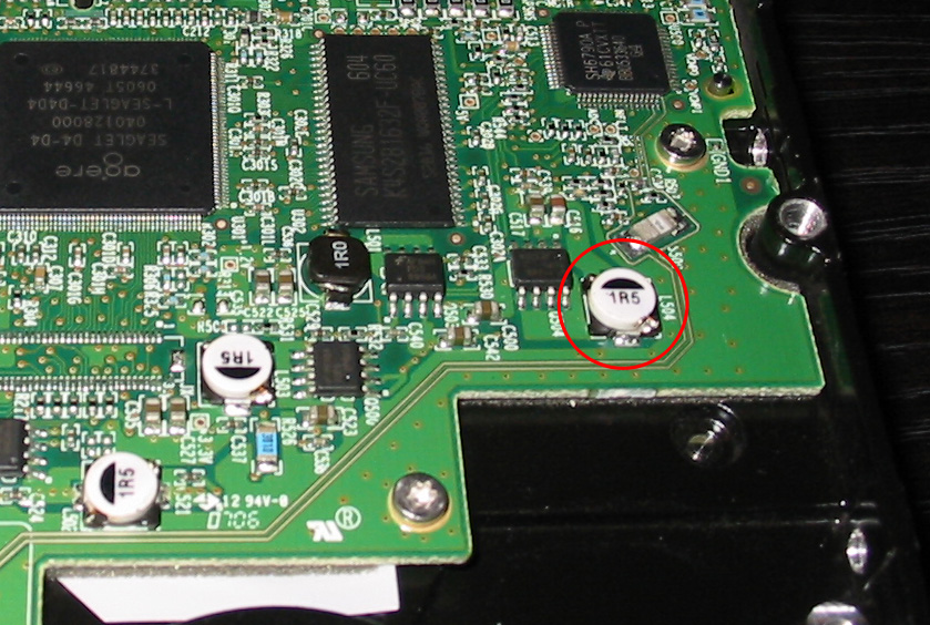

It looks like I'll have to find a board. It appears that no one in the area stocks Maxtor disks anymore(did they get acquired and dissolved or something?). For what it's worth, I took a closer look at the board and discovered that one of the pieces is loose. For the curious-minded out there, I'll toss in a picture. I know you've given me all the practical advice you can at this point, so the picture is just for the heck of it. I'd be curious to know what that part is though.
Cheers
File comment: The white cap and part of the black surrounding bracket has come loose

Hi Mauser,
Thats a small self-induction used to make an aditional power-supply on the board.
