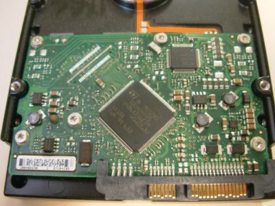

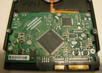

I usually leave Windows running, but when I logged on this time, the monitor, keyboard, and everything froze. I had to use the button to shut down the computer. When I turned it back on, the BIOS couldn't recognize the SATA drive. It also told me that the floppy couldn't be detected. I had another SATA drive attached, but it's still working. The other one won't power up anymore. Seems like something shorted the one drive and the floppy? Could replacing the PCB fix it? It's a Seagate. Thanks for any input.

Have you tried another SATA and power cable? Have you tried the drive in another machine?
Inspect the PCB, is there any visible damage? Any burning smell when powered on? Replacing the PCB can be tricky as Seagate drives need FW code to match, but it can be done.

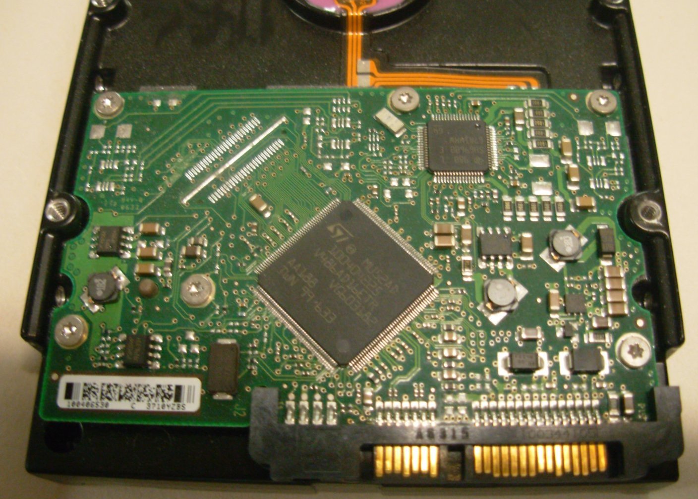

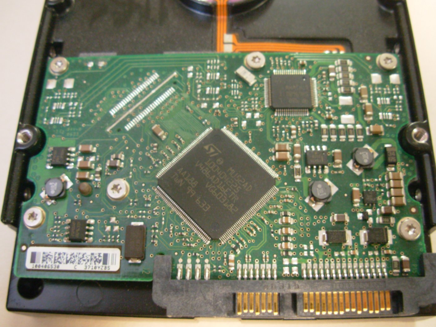

CK and rchadwick, thanks for responding. Yes, I tried the power cable and the SATA cable from the working drive and it's still the same. I also tried putting it in a USB enclosure and Windows could not see it. My untrained eyes doesn't see any spots that look burnt and there is no burning smell. I have attached pictures, maybe you can spot something?

Looks like a good pcb but i think it is master chip problem or something else in
your pcb ( diode, coil .... etc ) I agree with rameez try to check it with a
working pcb
