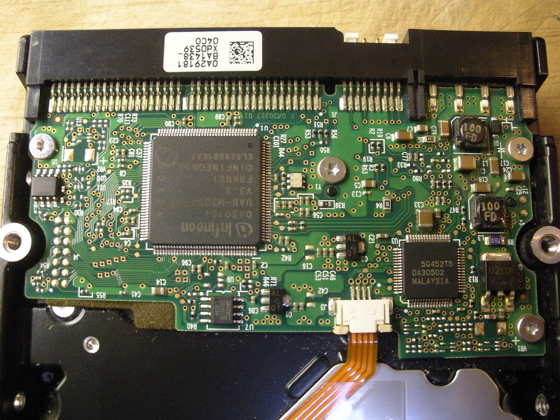

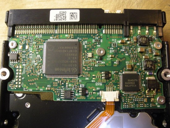

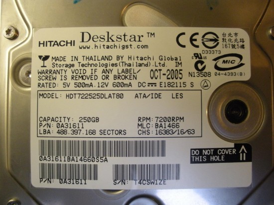

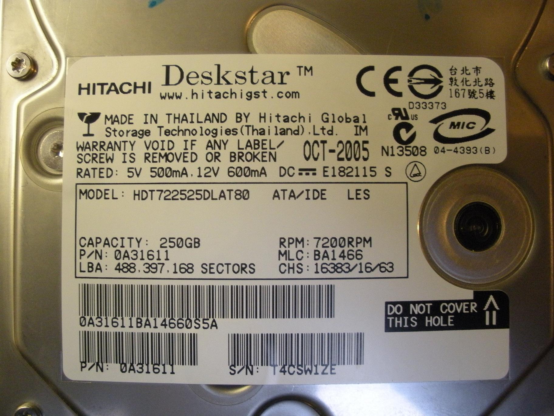

Hi all, new poster to this forum.
I would like some advice on possible recovery methods for my 250GB Hitachi deskstar that is no longer recognised in bios.
The drive spins up and when holding it in my hand (connected) its making a kind of "heartbeat" type vibration.
I have tried on another PC and same results IDE controller cannot detect the drive.
I was considering a pcb replacement, but am having trouble finding an exact match, and after reading some of the threads here and realising its not a simple as all that, thought I would ask first :)
The HDD details
P/N 0A31611
MLC BA1466
Any help or advice would be greatly appreciated.

Sounds like the heads are trying to find sync mark/SA and failing, a pcb swap is not likely to help, you need to ship the disk to a tech if you value the data on it.
 Post subject: Re: HDT722525DLAT80
PostPosted: July 24th, 2009, 14:09
99% certain the PCB is not the problem.
This needs to be properly diagnosed.
By all means send it up to me in Peterborough and I'll tell you what's up with it and give you the option of a discounted recovery if it's possible.
PM me if interested.

Nay, nay and thrice nay! DO NOT freeze your drive, this is a myth and maybe used to work on REALLY old drives with certain issues. But is very likely to kill your drive.
The PCB swap is not worth trying because in these drives the PCB has NVRAM information programmed into it which is more-or-less unique to the drive. In other words it's 99.9% likely a PCB swap would not work, even if it WAS the problem, which with noise the drive is making is frankly unlikely.
If your drive was not spinning up then a PCB swap with a NVRAM transfer would be plausible but not in this case.

"Magic" has been performed :-)
Bad PCB, had to be replaced with ROM and NVRAM transfer.
The drive also had media damage toward the end of surface 3, so a head-by-head image had to be made using PC3000 UDMA/DE.
An image in excess of 99% accuracy was made and data is on it's way back to SD as we speak.
