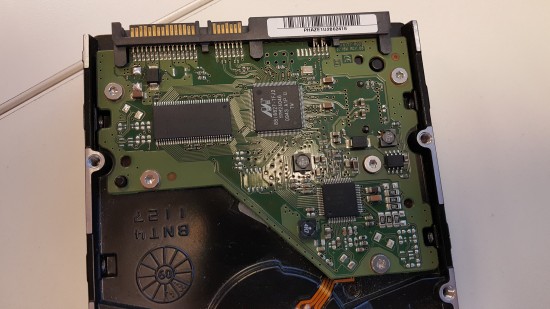

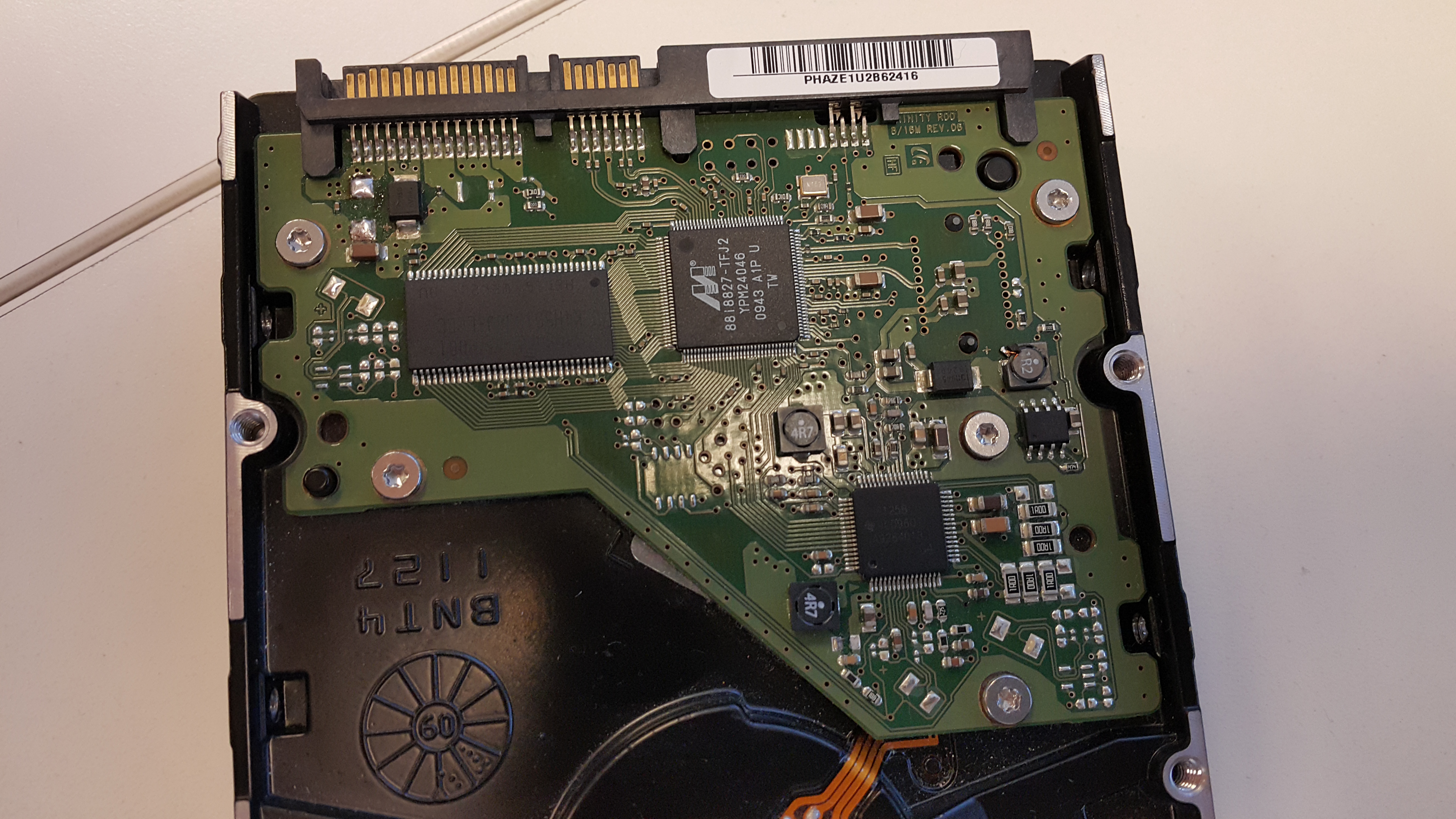

Joined: March 1st, 2015, 18:51
Posts: 5
Location: Turkey
My PCB photo is here.

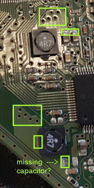

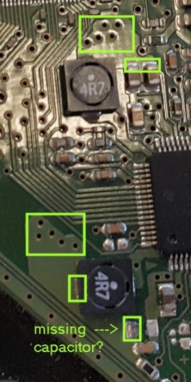

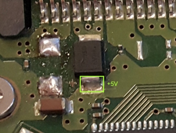

Can you measure the voltages at the indicated points? You can use any screw as your ground reference.
There appears to be a missing capacitor, but the photo isn't clear. Can you confirm if this is the case, and if so, did you remove it?
