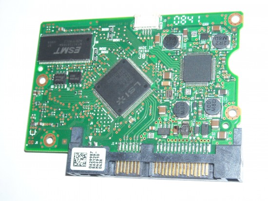

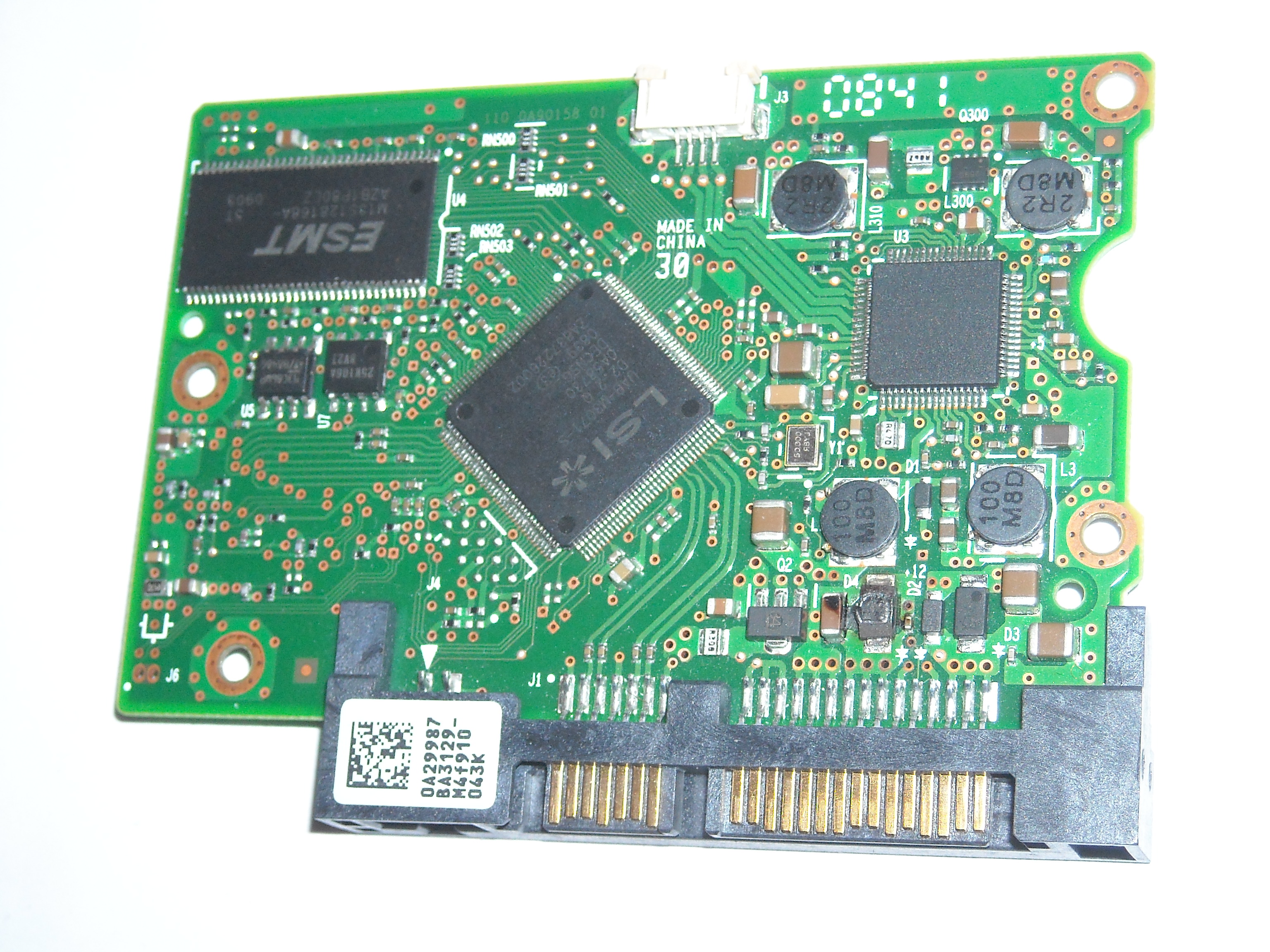

 Post subject: Need PCB Hitachi 1TB HDD HDT721010SLA360 P/N:0A38016
PostPosted: March 18th, 2011, 4:04
Joined: March 18th, 2011, 3:49
Location: Republic of Korea

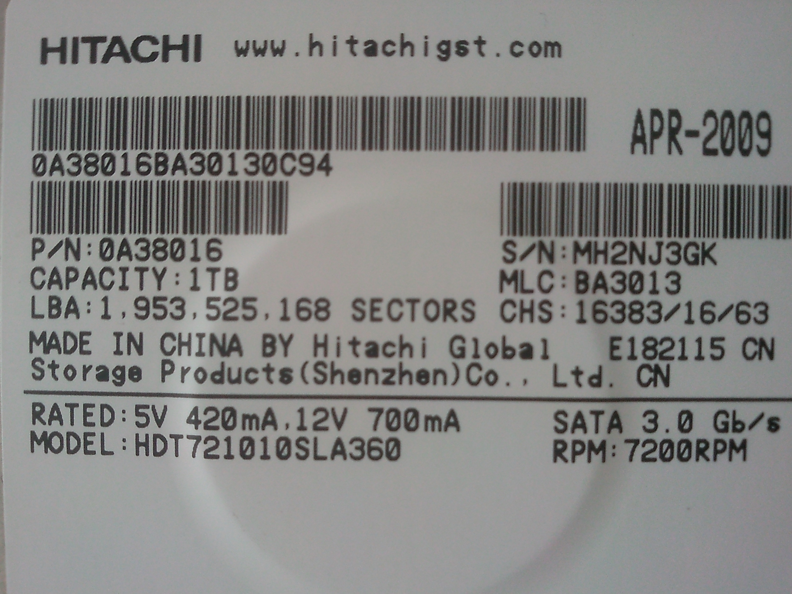

I need hitachi 1TB HDD PCB
Model: HTD721010SLA360
P/N: 0A38016
S/N: MH2NJ3GK
MLC:BA3013
APR-2009
If you have above mentioned PCB in your stock, plz feel free to contact me at kdhyun@hdec.co.kr
 Post subject: Re: Need PCB Hitachi 1TB HDD HDT721010SLA360 P/N:0A38016
PostPosted: March 18th, 2011, 18:47
Posts: 17352
Can you describe the failure symptom?
If you have a digital multimeter, one of us may be able to help you repair your board, or at least confirm that the problem isn't elsewhere. Many times the problem is only a shorted TVS diode, in which case it can simply be removed.

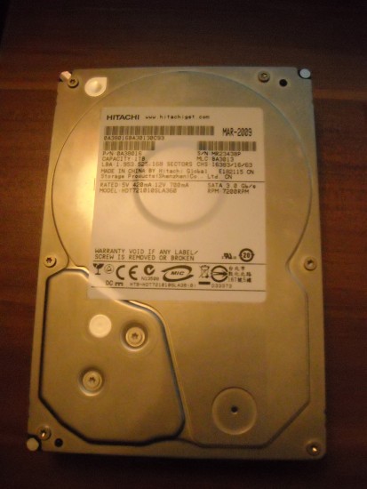

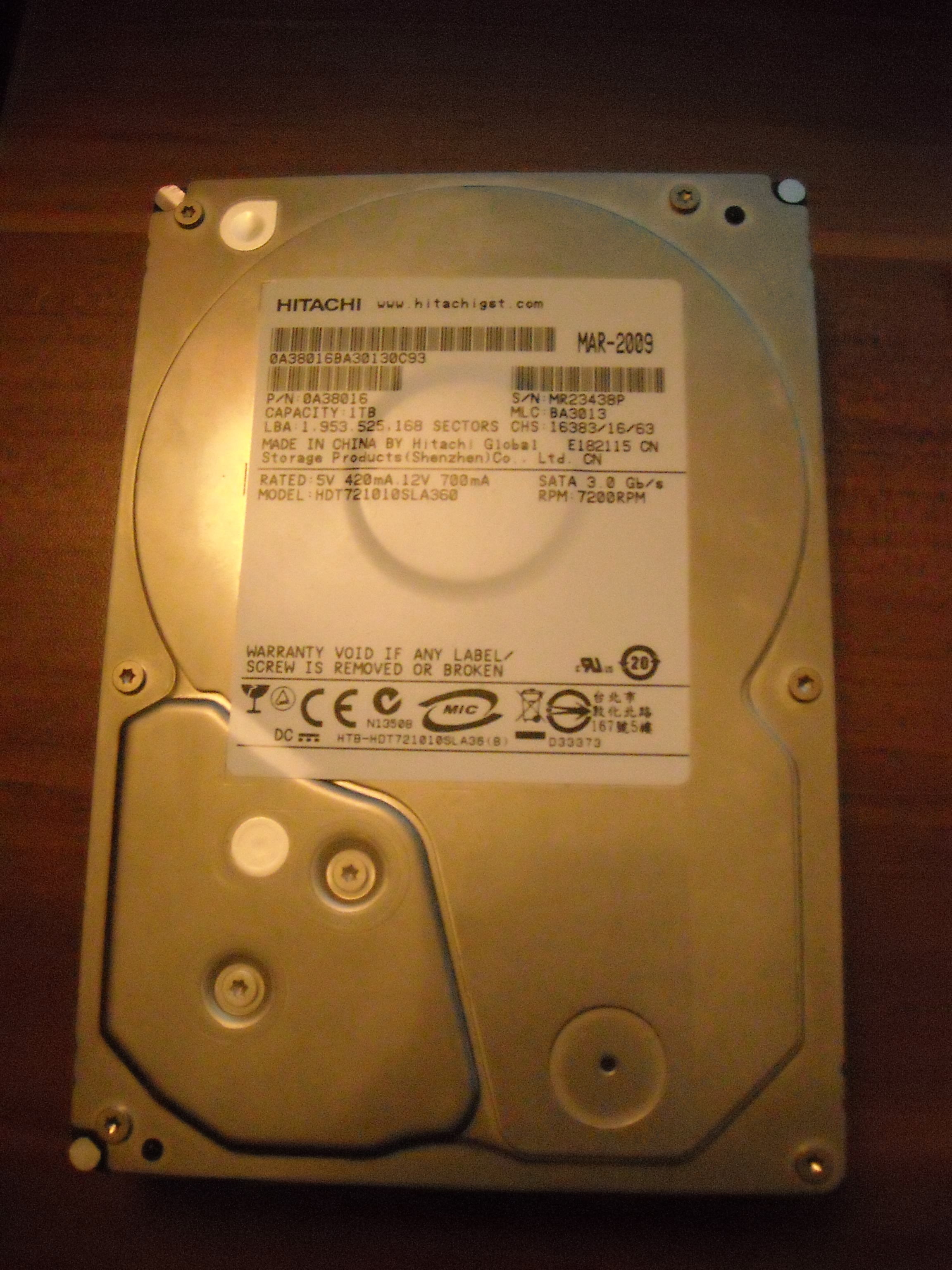

i need a controller card for my hitachi 1 tb hdt721010sla360
P/N 0138016
S/N mr23438p
MLC ba3013
MAR-2009
can anyone help me out, i'm new to this, i don't know exactly what to look for
thanks!

hi fzabkar! well there was actually a problem with the power cable, and one chip (i think its the TVS) on the PCB was burned. smoke came out from the cable and the pc rebooted. i read somewhere that i should find a PCB that has the same first two digits with mine and then replace it. is this true? thanks a million!
PostPosted: March 28th, 2011, 1:09
Posts: 17352
I believe you will need to find a compatible board and then also transfer the NVRAM chip from patient to donor. However, if the problem is restricted to a shorted TVS diode, then just remove it with flush cutters.
The usual culprit (12V TVS diode) is identified in this photo:
http://www.media-itservices.com/burned1.jpg
The drive will work without the diode, but it will no longer have overvoltage protection on the +12V supply. The other large diode is the 5V TVS diode. You can replace the 12V TVS with an SMBJ12A, and the 5V TVS with an SMAJ5.0A. Both are available from Farnell, Mouser, Digikey.

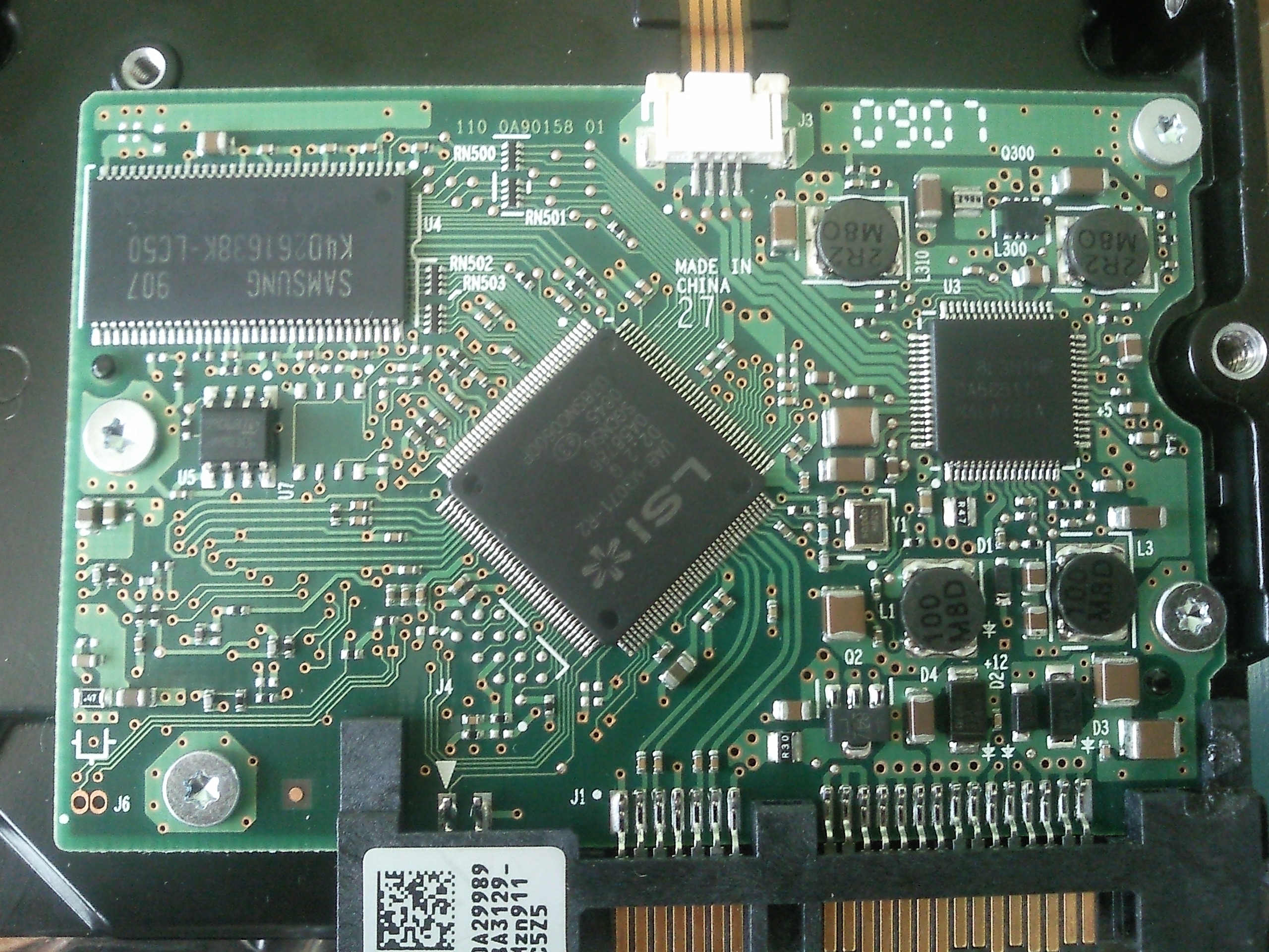

ok, here's a picture of the PCB. i just noticed that another chip is a bit burnt by the other.
i'm not exactly sure what these two are.

and here's the hdd
PostPosted: March 28th, 2011, 12:53
Posts: 17352
I suspect that you swapped the 5V and 12V inputs. The burnt component is the 5V TVS diode. You can remove it, but be absolutely sure of your power supply.
Good luck.
