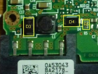

Hi
Sorry for delayed response - I've been away for w/e.
Picture of board is below - hope that allows you to answer your Qs

The NVRAM chip is the 8-legged chip, bottom right in your pic.

Check D4, D3, and R5 near the Molex power connector.

Sorry guys - now I am struggling
D4 is the black thingy above and left of the label D4? That reads open circuit both directions
R5 is just a couple of holes which appear to be connected (< 1 ohm in both directions)
But I cant see a D3 anywhere

See attachment.

See attachment.
D3 - Label half under screw so I missed it. Sorry
Open Circuit in one direction
155 ohms in the other
So TVS all OK?
