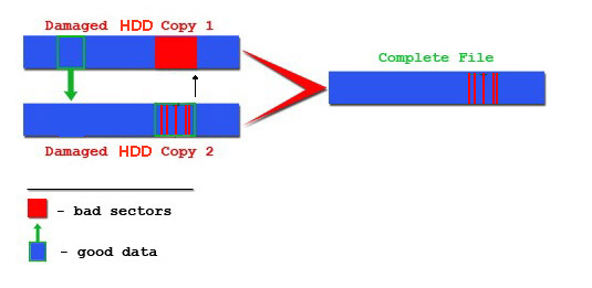

Hi there,
I have created 2 disk images of my HDD with different cloning settings in each one.
In the first HDD Image: I have set the the program cloning the HDD to a "skip factor of 100", which means every time it encounters a bad sector while imaging, it should skip 100 sectors ahead.
In the second HDD Image: I have set the program cloning the HDD to a "skip factor of 10", which means every time it encounters a bad sector while imaging, it should skip 10 sectors ahead.
My question, is there a way to merge those 2 HDD Images together?
So that maximum data is extracted from a HDD with many bad sectors.
What HDD image extensions can I merge, VHD RAW IMG IMA DD .....?
Please Help,
Thank you

Which tool(s) did you use, and did these tools maintain a log?
How do bad sectors appear in the image? Are they filled with zeros, or do they contain some other identifying characters (eg "BAD" or "DEAD")?

Although I would have just made one clone using professional data recovery tools, here is how I'd deal with your situation.
Step 1 - Clone or copy first image to a new location (this copy will be the first part of the merge)
Step 2 - use ddrescue to generate a log file against the this copy (assuming that the skipped sectors contain zeroes)
Step 3 - use ddrescue with the log file to copy the second image clone to the image copy created in step 1 (this should only copy the sectors that contain zeros on the first copy
If you need to ask for more details about how to do this, I suggest that you are over your head and might want to seek the assistance of a pro.

 Post subject: Re: Combining/Merging HDD Images
PostPosted: March 10th, 2014, 20:26
Posts: 293
Hi crytoy,
just to note your diagram is not a great representation although i get your idea.
If image 1 got so far, say 70%, without discovering bad sectors, image 2 would also get to that stage.
The 100 is not a granularity. its a skip size at an error.
So, image 1 would skip forward 100 only when it happens upon an error, and image 2 would crawl along by 10s from that point.
see reworked image.
Any overlap where image 1 would have data and image 2 would not, would surely be a matter of a few single sectors on the boundary of one to the other only.
Further, the skipped areas of size 10 sectors would remain unless you drop down to a skip of 1 (in reverse) without going into details of disabling look-ahead caching.
You should then be left with the smallest of errors which should be the bad blocks themselves.
PostPosted: March 11th, 2014, 8:01
Assuming that bad sectors are zero-filled, I would try to find some way to OR both images before writing them to a new destination.
OR function works as long as the zero filled assumption is true.

crytoy, thanks for clarifications but to ask:
when you say you have taken 2 images, are you meaning 2 images one laid over the other on the same target drive
or
2 images written on 2 separate disks?
If it's the first, then ddrescue, with a log will be doing the merge for you.
If it's that latter, just use ddrescue as it was designed: 1 source drive, one target drive and it will lay multiple images over each other on the same target drive as intended.
It will image the disk using a pass with the large skip first and lay the second pass using smaller skips down on top of that using its own log system. read the link page for detailed description.
It isn't necessary to make 2 separate target images in fact it actually makes the process more difficult.
Despite that if now you have 2 distinct separate images you can also use ddrescue as folows:
read this
https://www.gnu.org/software/ddrescue/m ... anual.html
and also scroll down to
Example 5: Merge the partially recovered images of 3 identical DVDs using their logfiles as domain logfiles.
ddrescue -m logfile1 dvdimage1 dvdimage logfile
ddrescue -m logfile2 dvdimage2 dvdimage logfile
ddrescue -m logfile3 dvdimage3 dvdimage logfile
(if errsize is zero, dvdimage now contains a complete image of the DVD
and you can write it to a blank DVD)
PostPosted: March 11th, 2014, 12:54
How will ddrescue be able to differentiate between those sectors in the image which contain recovered data from those that contain zero-fills?
It doesn't know if the zero file is read vs unread. But, it shouldn't matter because if it is zeros that were read, overwriting it zeros from the other drive won't matter and if the other drive can't read those sectors, they will still be zeros.

@lcoughey, in the absence of a log file, and in the absence of a file system analysis, there would be no way for you or any tool to determine whether a particular sector in an image file contained recovered data or otherwise. Assuming the image file were written to a good drive, then it would contain no unreadable sectors, in which case ddrescue would make a perfect copy of it on a third destination. Without a log file, ddrescue would have no way of knowing if sector X in the image file were zero filled, or contained a "BAD" signature, or if it simply contained the stale data that existed on the drive before the image file was written. All readable sectors in the file would be imaged to the third destination as is, regardless of their contents. Therefore the new log file would register 100% success, ie it would be a pointless exercise.
My suggestion would be to compare the two image files and examine the differences. This may help to identify the fill patterns, if any. If neither image contains fill patterns, and if unrecovered sectors simply contain the stale data that existed on the destination, then there would be no simple way to merge the two images.
I've used the auto generate to create a log file many times over...it has always worked. But, I always write to a blank drive and don't write any patterns to the unread sectors. If you wrote a pattern to the unread sectors (ie, unread), you would need to add another step of searching those sectors our and overwriting them with zeros....then generate the log.
I think the whole point of the exercise is to automate the process, rather than manually do it.
This is true.
