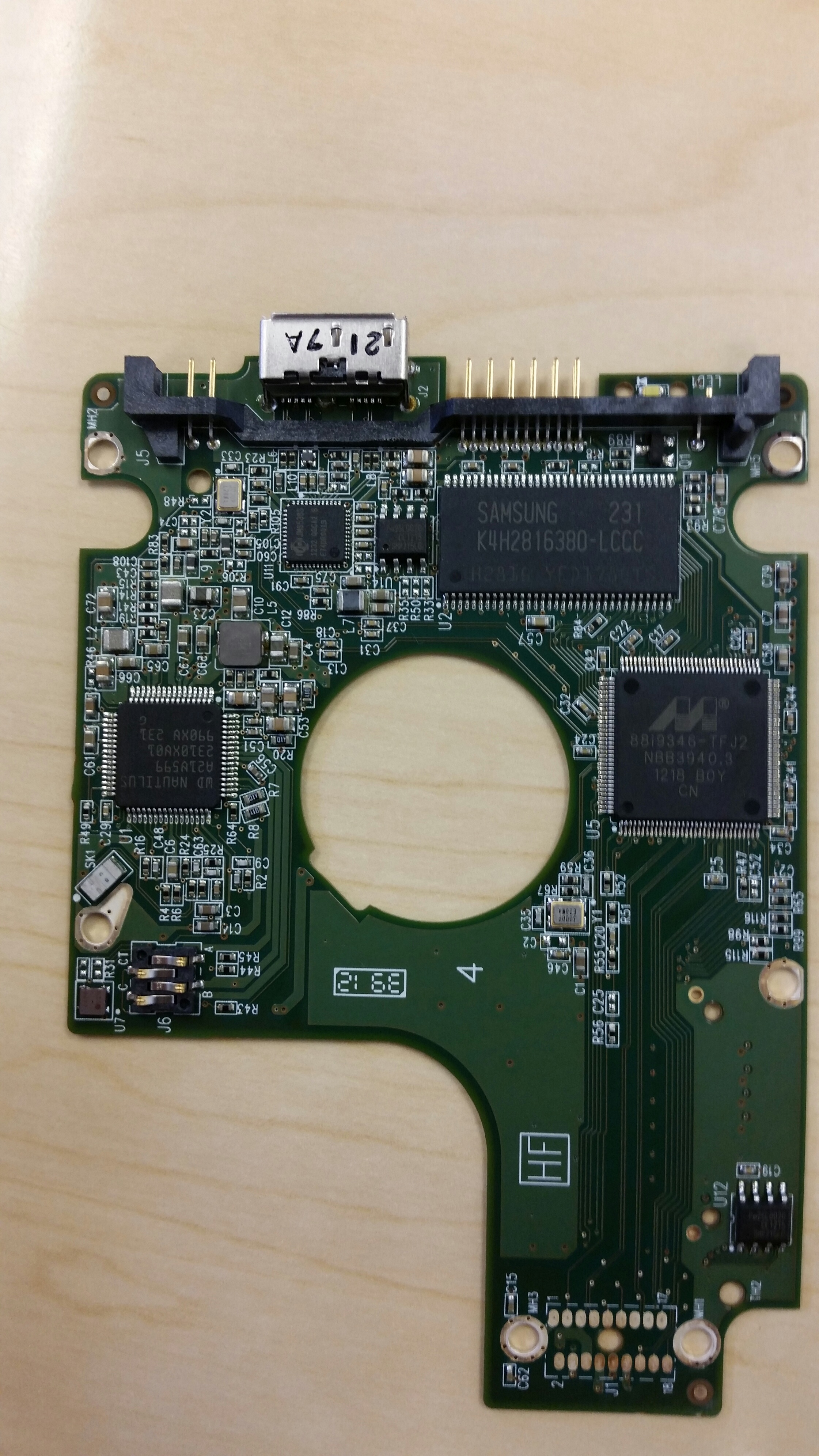

The above drive is not being recognized. I have a matching USB board (rather than a SATA donor). Original board is 2060-771801-002-REV A. The donor is identical but from a 2TB WD drive. Swapped the U12 chip. Drive name up in R-Studio, but as write protected. The drive is seen in Device Manager but as unallocated space. I presume this is an encryption issue? I also swapped U14 as a test but the drive clicked. Any help would be appreciated.

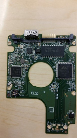

Further to this. I must have done a bad soldering job on the first swap of the U14. I can now get into Hex and can see the drive however it is still encrypted. If the encryption is stored in the U14 chip, then a new donor will not make a difference. Or is it stored on the Controller chip and an exact matching board in terms of model number etc should work (with U12 & U14 chip swaps)?

The chip to the left of U14 is a JM does that match the other pcb?
The first numbers are the same, the rest are not:-
Patient: JMS538S 1216 QGCA2 B E73T10019
Donor: JMS538S 1232 QGCA2 B F74DR0019
I have also been told buying WD Smartware Pro software might help?

ddrecovery wrote:
"1216" and "1232" appear to be YYWW (Year / Week) date codes. The last two markings could be batch codes. In short, I don't see any significant difference.
