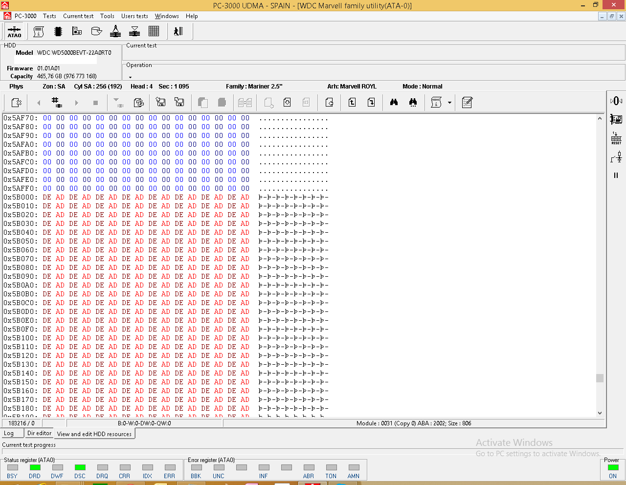

Model : WDC WD5000BEVT-22A0RT0
Firmware : 01.01A01
Capacity : 465,76 GB (976 773 168)

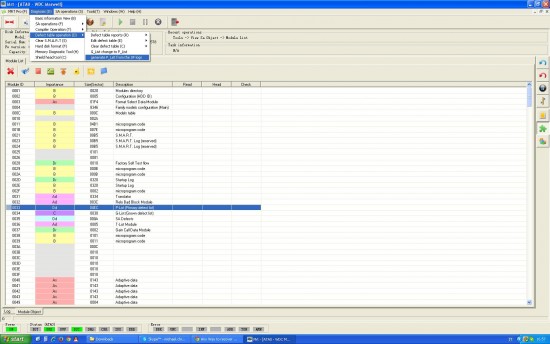

i think the problem is bad sec on media
if y try to recover translator bu i get fail, i tryed to write module but i get fail too.
any other way?

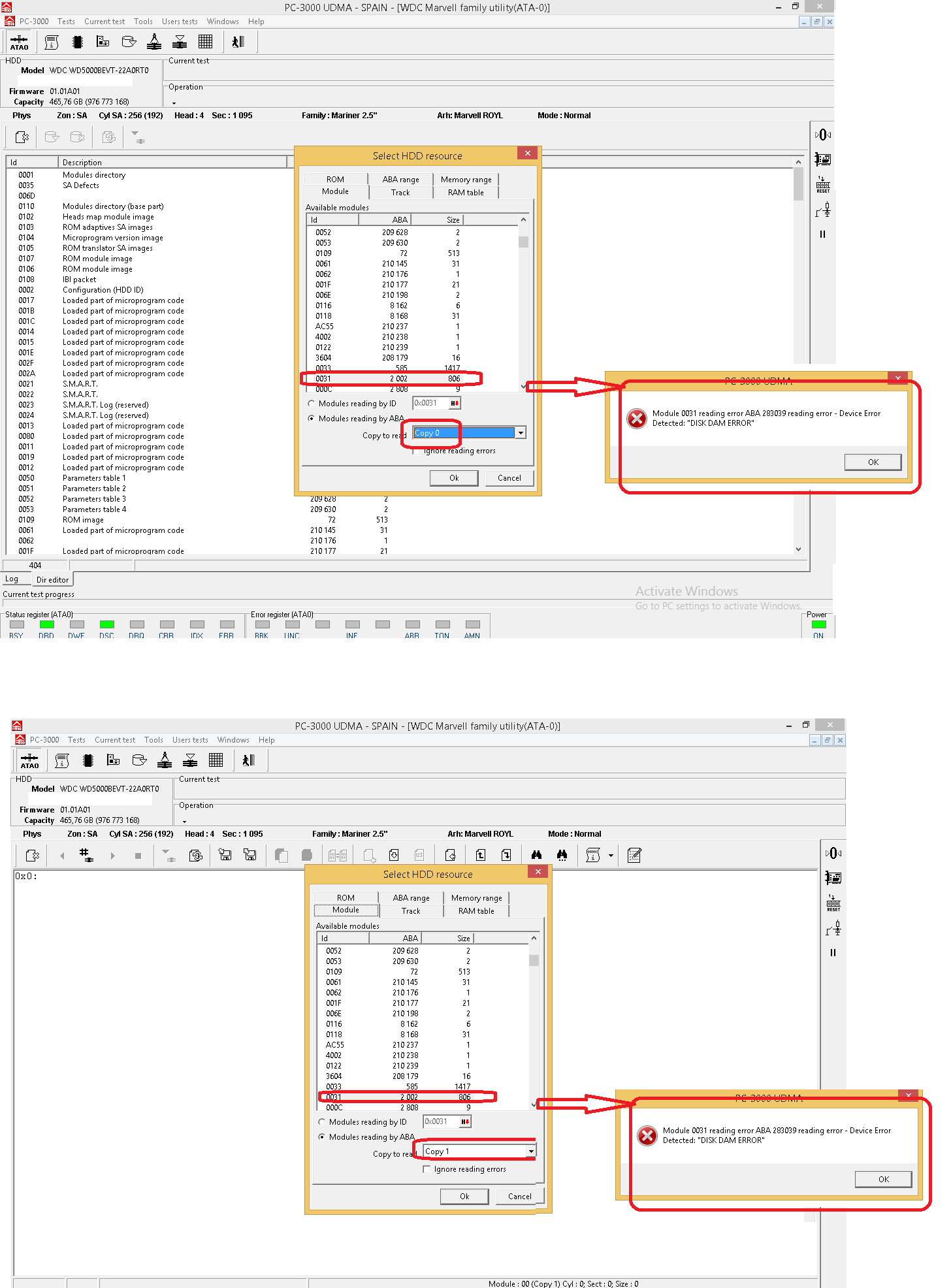

Have you try to backup SA mods?
Do you get CRC errors on some mod reading?
My firmware database:
 Post subject: Re: Any Way to recover Translator on WDC WD5000BEVT-22A0RT0?
PostPosted: September 10th, 2014, 9:35
Posts: 811
Location: World
Hi Michael, thanks for your help
yes; i tryed and i got errs
any idea?

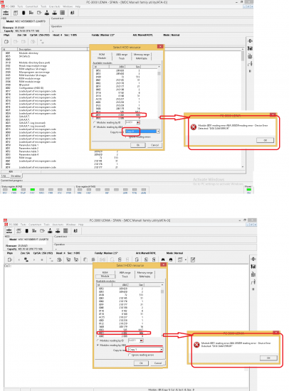

About saving modules i get this log:
Module : 31............................. : Module 0031 reading error ABA 2730 reading error - Device Error Detected: "DISK ECU UNSAFE ERROR"
Module : 31............................. : Module 0031 reading error ABA 283038 reading error - Device Error Detected: "DISK ECU UNSAFE ERROR"

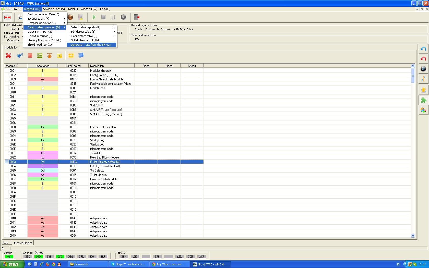

Mod 33 is p-list, i don't think hotswap would work without it. :?
Maybe you can rebuild p-list from SF LOG, but wait for some other pro advice because i never used this function (i don't know if would kill customer data).
In MRT i can show you where is option for p-list generation from SF:

same error on both modules MOD31 from copy0 and copy1.
I tryed to MOD31 manually repair (copy0 and copy1) and write it but can not write it.
