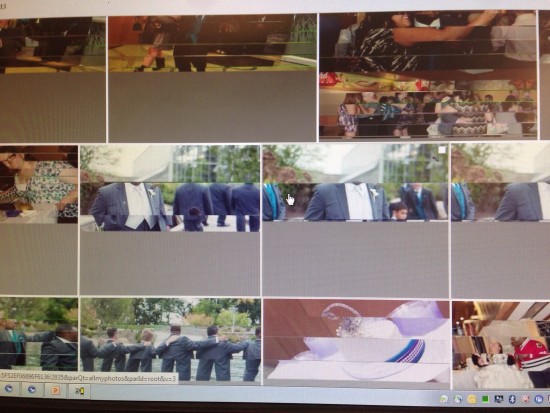

I'm having some issues that are really starting to bug me. A few months ago, I was transferring some photos from our iMac to our Buffalo NAS. Halfway through the transfer (only about 1GB of data) the process stopped, and I began getting an error on the NAS.

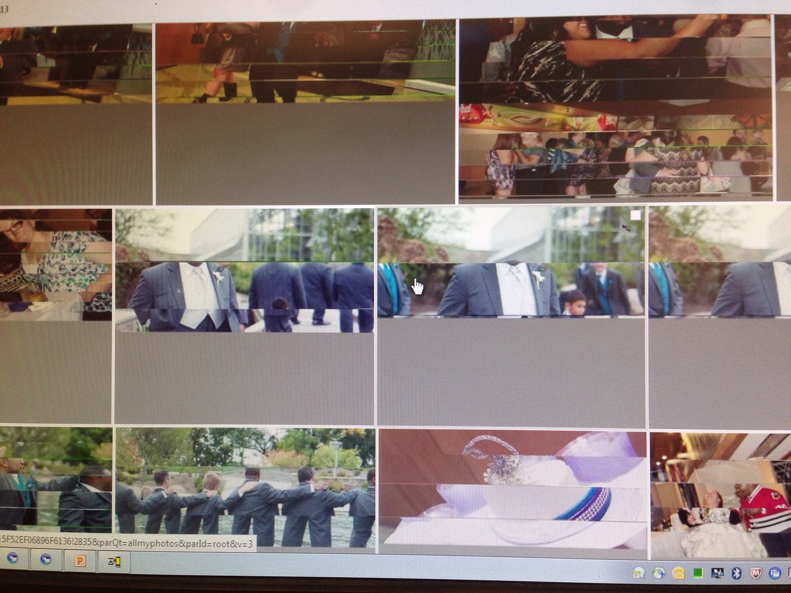

The NAS is a 2TB (2x1TB) configured in RAID 1. The error had me thinking a firmware issue, so I began investigating that, but I had a heck of a time getting Mac OS to mount the NAS. Only when plugged directly into the computer can I get any access to the firmware, but it would only last a second before the NAS would default back into "limp" mode, or whatever you want to call it. This made me think I had an issue with the drives. So, I removed one of the drives, same issue, then swapped drives, same issue. Next, I took the drives to a friend who is a hobbyist when it comes to data recovery. He was able to tell that it was mostly photos, which it is. He was able to see .jpeg, but not the .nef (Nikon raw format). His recovery work showed almost 900GB of data, which is impossible, and the majority of the recovery was not usable anyway(see attachment). He did find that the drives passed physical diagnostics. He ran the drives through another program later and found 120gb of data, much more in line with what I would expect.
So, I have a few questions. 1) What could have happened to have both of these drives freak out? 2) is there anything that I can do to try my own recovery? (trial software that I've downloaded do recognize the drive, even though OS X gives an error) 3) I only have macs, which I'm guessing limits my options. Is a PC something that would essentially be required for this task?
It seems as though the data should be able to be recovered to a degree. He said he found a few bad sectors on the drives, but nothing catastrophic. I just want to recover the data, don't necessarily need it right now, and then I'd like to get the NAS up and running again.
Any thoughts?

It was Raid0 not raid1
Pictures which you showed to us, were recovered from one drive in raw mode, of course they should be corrupted in this case.
Need to recreate array as raid0 with proper stripe size and correct order, using proper software.

Theoretically, if have recovered the data from both of these drives separately, would the stripes from Image 001 on Disk 1 be the same as the stripes on Image 001 on Disk 2?
Reason I ask is because my friend who took a shot at recovering the data hosted all of the data online and the data from Disk 1 is the exact same as Disk 2. All of the striped photos look the same.

I shouldn't have said the data is the exact same, the photos I was comparing are the same. He has the data he pulled in 2 places, one for each drive. There are 32xx items (photos and documents) recovered from drive 1 and there are 35xx recovered from drive 2. Now I'm not saying that this means they aren't the same because he could have used two separate methods and one method pulled slightly more data. I'm not sure.
I configured as a RAID 1 when I originally set everything up. I suppose it might be possible that during the freak out while the disks were still in the buffalo, it wrote files from disk 1 to disk 2.
I can't imagine he mirrored from disk 1 to 2. the fact that you say you've seen this before from buffalo NAS kinda pisses me off, but life goes on.
One thing I did notice is that the images that look to be striped are all .nef (Nikon raw format) and the ones that recovered fine are all JPEG. However, not all jpegs recovered.
I'm going to clone them both tonight and work with UFSExplorer.

Figured I would come back and post what happened. Ended up dumping both .img files into UFS Explorer. It built the raid and I was able to recover the data. I'm not sure if anything was lost, but more than 95% of the data was recovered. It was about 250gb of data in total that recovered.
