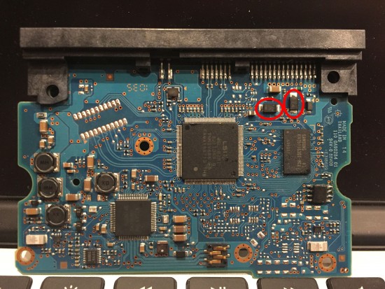

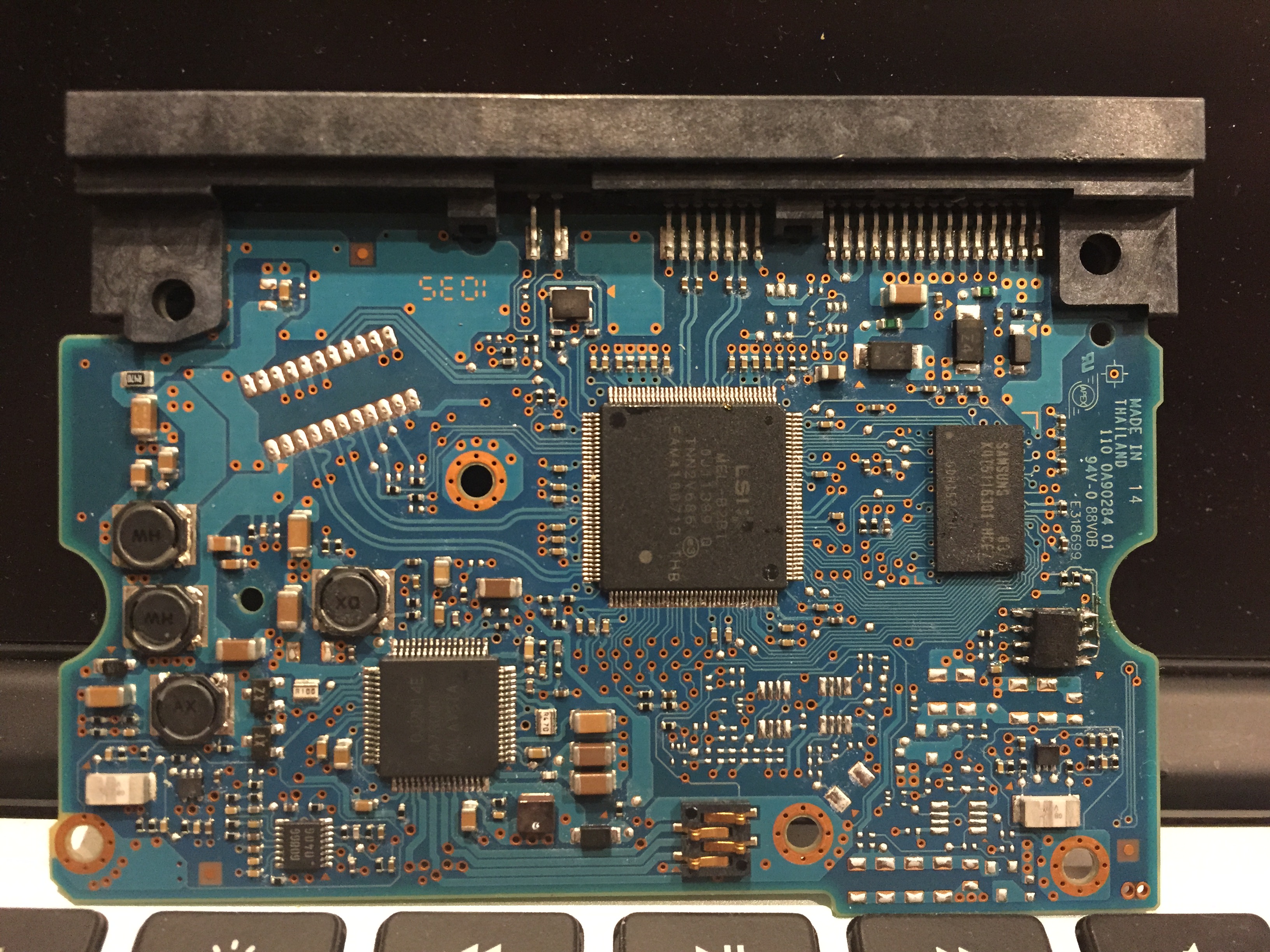

Here's the PCB pic for reference.

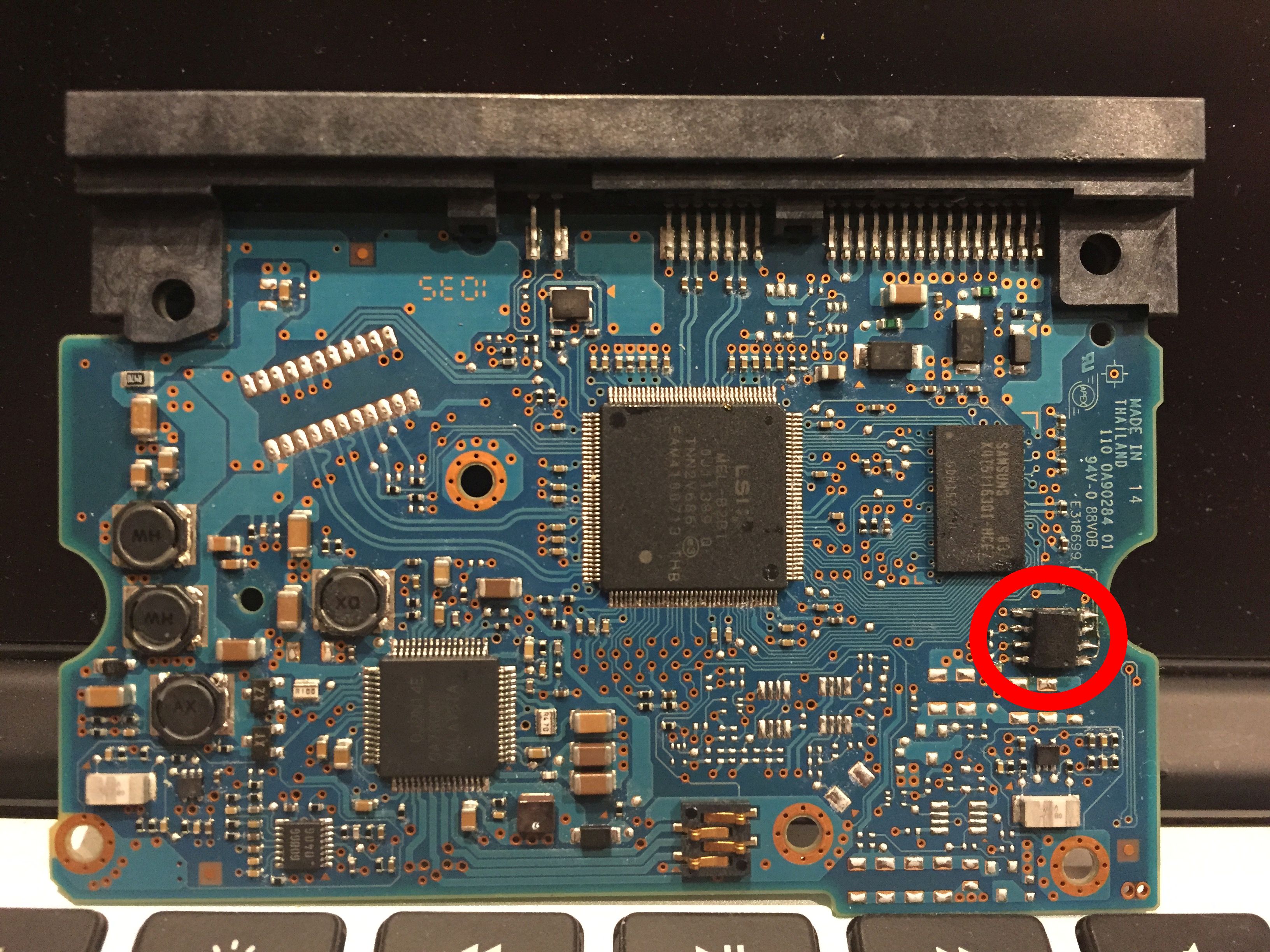

Here's the NVRAM on your board:
Move it to another PCB with the same first two lines of the white sticker.

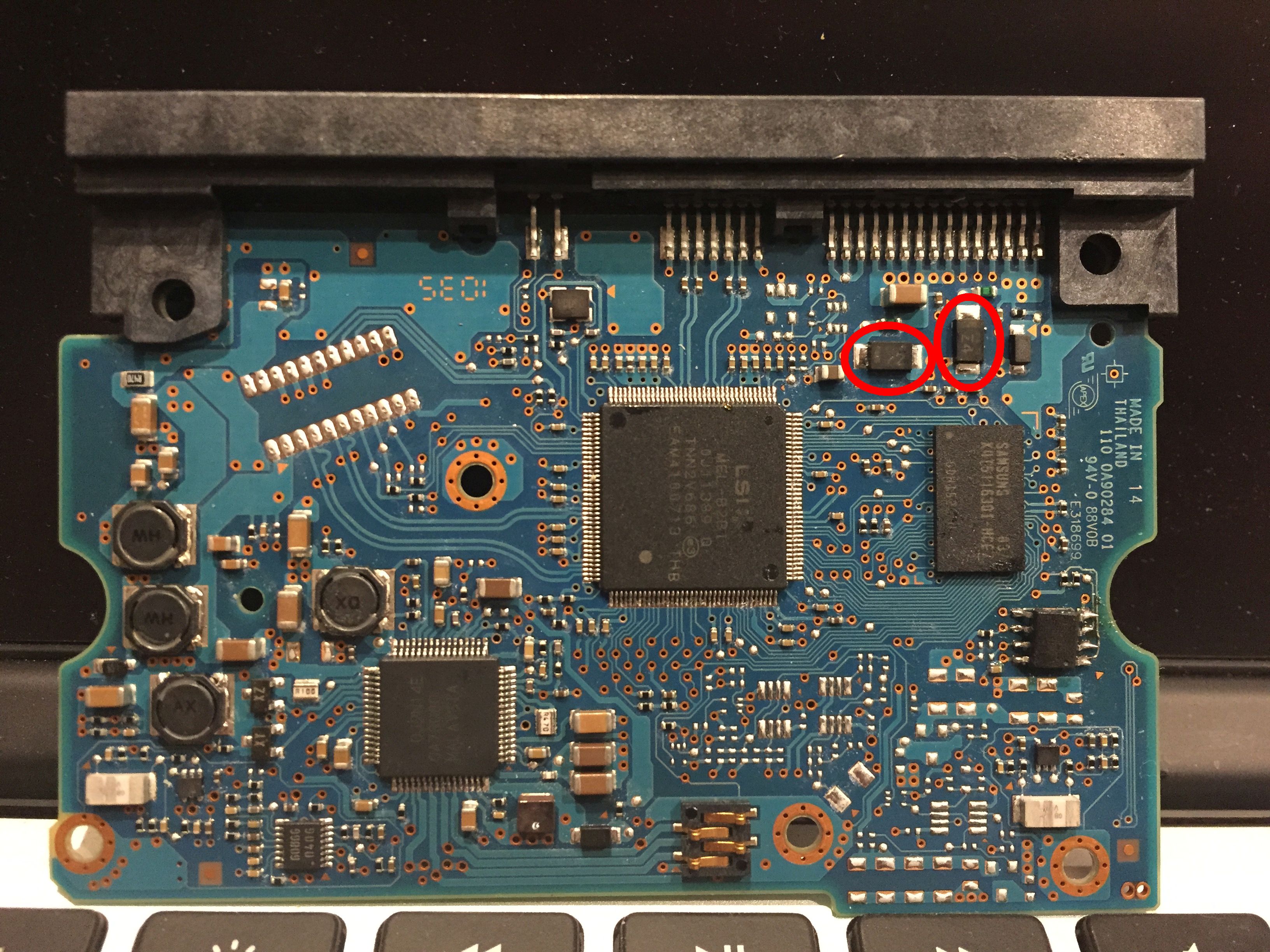

But first you may want to test these two diodes:
If they are short circuited, you can just remove them and it might still work.
If you have the dump of the NVRAM you can post it and I'll check it for you.

I have tested the diodes (in circuit) and they are not shorted. Guess my best course of action is to hunt down the correct board and swap the chip. Is there any more tests that I can try?
