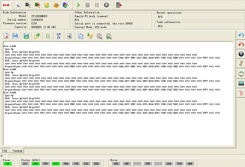

i have problem with drive
st1000dm003 1Tb
no more recognizable from bios
no strange sound, motor spin regualrly
if connect via serial i receive the same failure
Boot 0x40M
Spin Up
FAIL Servo Op=0100 Resp=0003
0100 0000 0000 0000 0000 0000 0000 0000 0000 0000 0000 0000 0000 0000 0000 0000 0000 0000 0000 0000 0000 0000 0000 0000 0000 0000 0000 0000 0000 0000 0000 0000
ResponseFrame 20C0 0000 0000 7FC0 0008 0000 0000 0000 FBE7 0000 0000 0000 0000 0000 0000 0000 594A 6DC5 5EB7 0681 9CF1 B044 BCF6 35DB 851B 7E6E 0000 0029 0000 0000 FFF7 0002 0010
ResponseFrame 2100 0000 0000 7FC0 0008 0000 0000 0000 FBE7 0000 0000 0000 0000 0000 0000 0000 594A 6DC5 5EB7 0681 9CF1 B044 BCF6 35DB 851B 7E6E 0000 0029 0000 0000 FFF7 0002 0000
what could i do?
thanks

I don't know what "easy fix" these HPW guys are talking about, but the problem with this drive is bad heads. Plain and simple.

+1 bad heads
Check heads and surface in lab, with Grenada drive this will be fun.

+1.
It is bad heads with >95% probability. Actually, drive has two heads, and it is easy to check them.

I have a short circuit on the PCB making no contact with PCB and HDD above error message. so not bad head spins up the engine does not sound strange

If you take good drive and remove PCB out of HDA - you'll get the same message. Because drive, generally, make no difference between operating without heads and operating with heads that reads nothing from surface.
