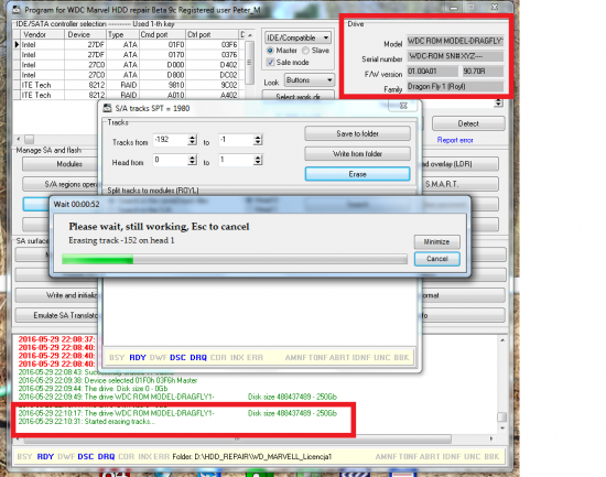

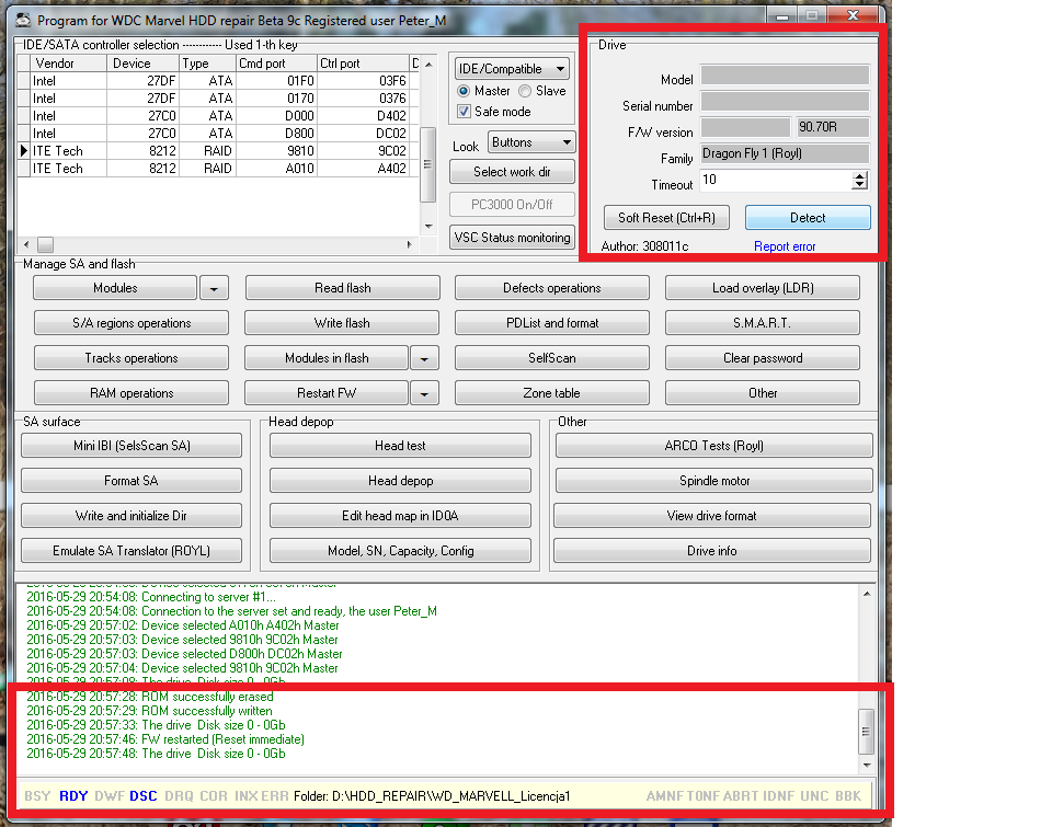

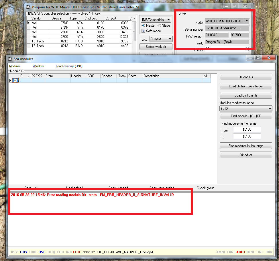

Hello everybody, today have a intresting issue with my WD5000AVDS-63U7B0(native PCB 2060-701640-001 internal ROM). So pcb I borrowed from the disk wd10evds-63u8b0 (pcb: 2060-701640-001 rev A) dragfly2 (both were identical) that I think borrow. So I have uploaded Rom native did it go ok, then I loaded the loader and started to upload the original modules. Went ok. I click restart ..... And hear the sequence 5 clicks then second off 5 seconds of silence clicks 5 clicks and the motor stops. I conclude that the head is not in SA. Moreover, I ruled out Bad in SA, because the scan SA Area is not found any Bad sectors, further blocking loading FW, makes it sees MOD 01 and a list of modules and module check did not show any irregularities. I was thinking almost the same situation as with wd Black. You had maybe a similar situation to mine? Any suggestion?
I Used Full WD Marvell 9C, Sediv at this time not work(licence bye bye).
Standard, Head test in SA suggest :arrow: all head good.

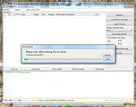

Spildit wrote:
If you have "original modules" then i guess you were playing with firmware tools on the drive when the drive "died"....
Did you run ARCO or SS on it to "kill it" ? Did you use something like calibrators or format SA or whatever ?
NO, any calibrators, Self tests, and ARCO. Only Write Oryginal SA modules, and ROM.

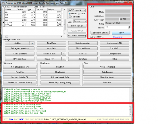

Spildit wrote:
Is the native PCB still functional or did you kill it or it's ROM ?
5x write Native PCB is dead, patient PCB from WD10EVDS-63U8B0, when fully work perfect.

I try, but your method nothing changem because problem is the same. seqence 5 clicks, and motor spin down.

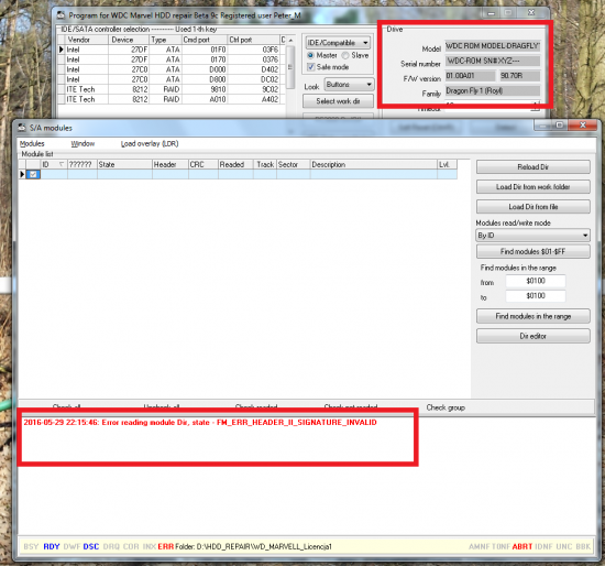

Are you saying that you can READ ALL MODULES OK with the new PCB ?
Yup, provided that Block Loading FW, click check all mods, and WD marvel Check all good in both copies of modules.

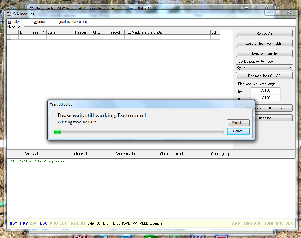

Check modules. If all ok can't you SS the drive ? Are ROM compatible with overlay ?
I checked mods and all mods OK, contains OK, CRC and header OK, provided that block loading FW, Yes, no problem, I can take pictures, work with this disk. if only I the PC with this disk.

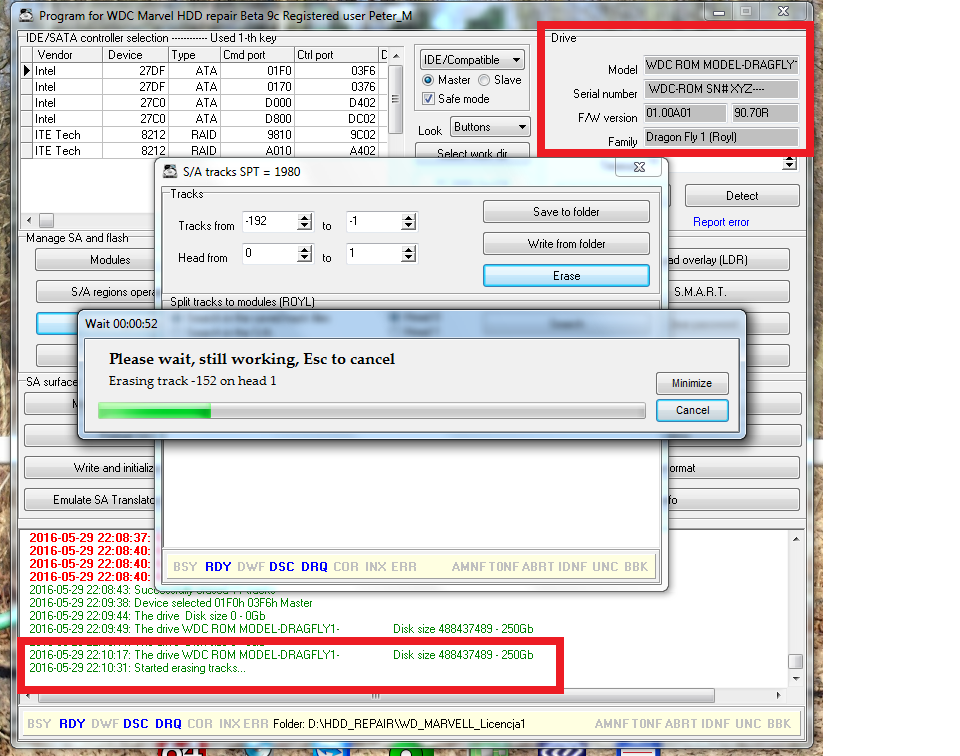

Spildit wrote:
Do a full internal format with P and G list ? :iknow: :iknow: :iknow: :iknow:
No, Because Drive can't read SA.

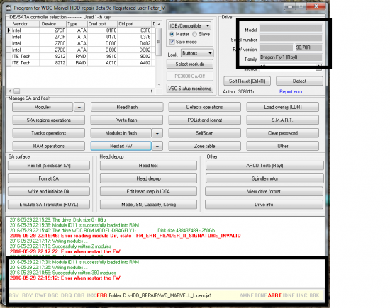

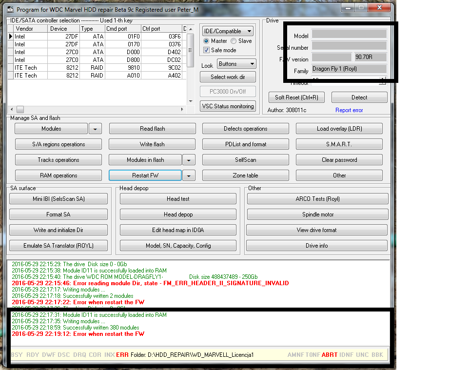

Because, Drive read modules when Block loading Firmware. When restart FW to normal state then begins seqence 5 clicks, pause 5 clicks pause 5 clicks, and spin down.
Do you understand me?

Interesting to take a look on the registers, usually drive shows error codes according to it's faults correctly.
Actually, here is an answer..
Additionally, you sad, that drive doesn't spin down after changing 0 region on 1 region.

So back to my theard. So I prepared screen shoot, how does this look:
File comment: Write ROM ver: 00900070R
Everything is OK

File comment: Load Overlays, and Start erasing Tracks. And again everything is OK
File comment: Load Overlays, and Clean SA Area
File comment: Writing Oryginal Modules
File comment: And Now begins Seqence 5clicks, and Drive is not detect, not work everything.
Succesfully 380 modules Write.

Spildit wrote:
I don't know why you did ERASE TRACKS of SA.
Do all again but this time as soon as you LOAD OVERLAYS and you get correct drive detection with S# XYZ go to RAM and EDIT DIR in RAM. Load DIR from you file (mod 01). Save to RAM !!! No go to S/A operations and write all modules. Done.
OK, because erase track I treat as a full-format areas SA. DFL company, and ACE lab recommend Erase Track
before writing Sa mods,Btw, your method not work, sitation the same.
Spildit wrote:
And STOP USING that Restart FW thing. Just power off/on the drive !!!
Ok.
Spildit wrote:
Oh ... and of course ... did you block SA access by editing FW zones on ROM ??? If so go to RAM and edit it back on RAM !!!!
You will want to have correct zones + correct DIR on RAM first and only then you should write modules from backup !!!
Otherwise it will not write or will write to incorrect place !!!!
Ok, I write modules in original correct place, and Click, Click, click, click, click :(
something seems to me that the PCB is damaged after these hits :roll:
