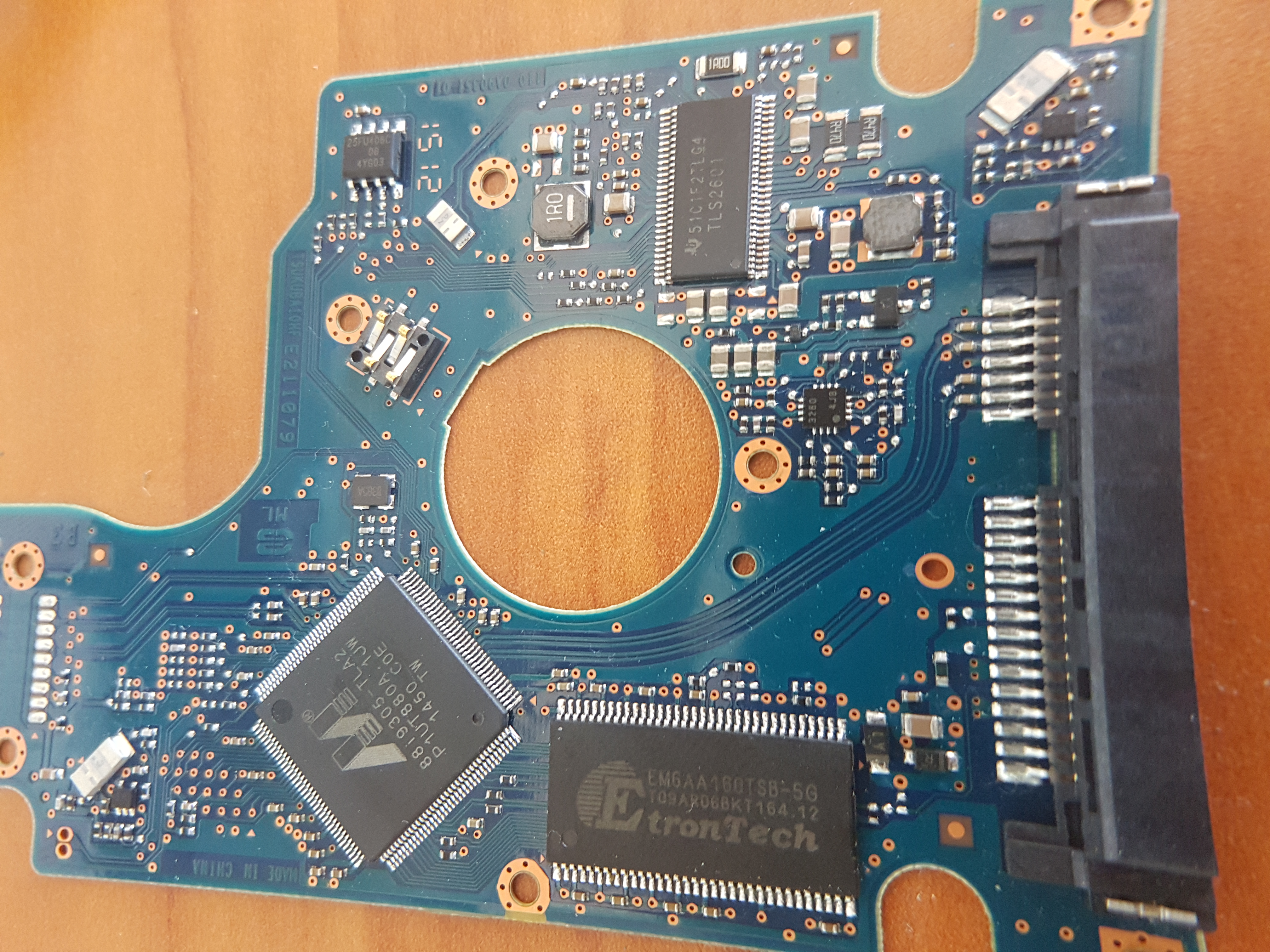

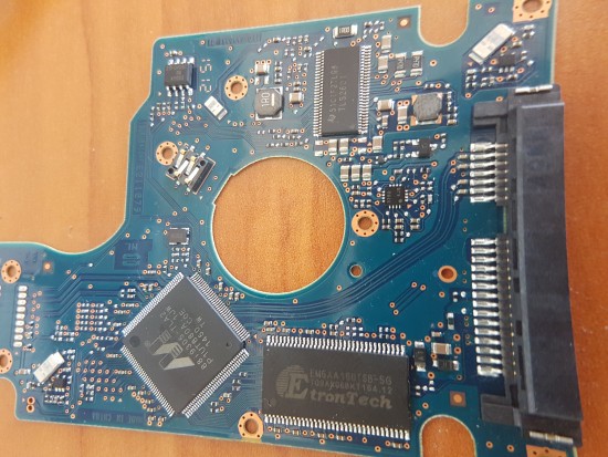

Hey guys

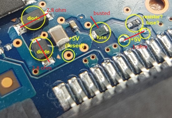

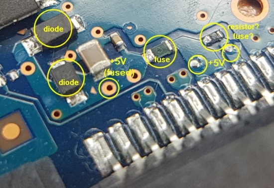

So I wired up a China HDD docking station with the incorrect voltage.. wahoooo
can you guys please see attached and give me a direction on where to test the pcb and how to dodgey it up
I go alright with a soldering iron and a multi meter
Thanks smart people

So even if I get a donor pcb I still have to move a chip? which chip is the rom chip?

The photo identifies the "BIOS" IC (aka "ROM").
https://www.hdd-parts.com/13022903.html
https://sep.yimg.com/ay/yhst-14437584971410/91711095-6.gif

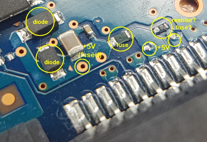

Measure the voltages at the +5V and +5V(fused) test points. Also measure the resistances of the circled components.

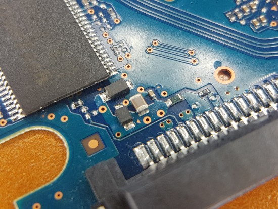

looks like we found a busted fuse
jump it ? can i just solder over the top?
Thanks so much

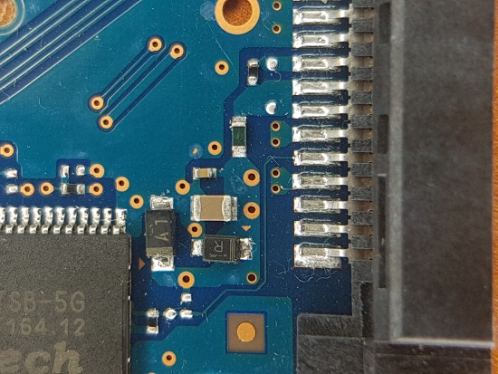

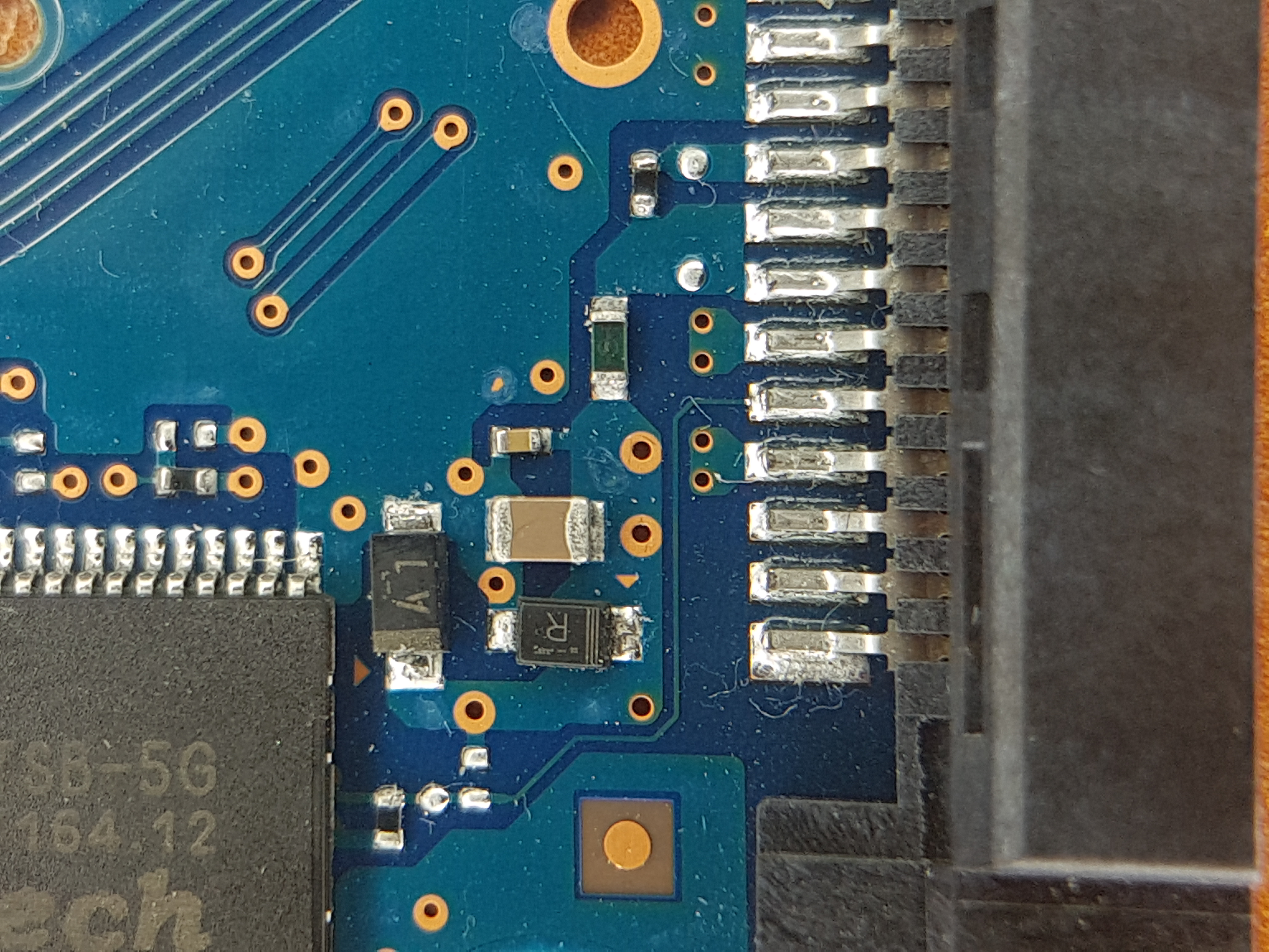

One of the diodes is shorted. You'll have to remove the TVS diode (the other would a Schottky rectifier). Can you tell us the part markings on each diode? I can see an "R" but nothing else.
Edit: I see that the other is an "A1".

r and a1

RSA5M, Rohm, TVS diode, 200W, 5V, marking A1:
http://www.rohm.com/web/global/datasheet/RSA5M
http://www.1688eric.com/upload/pdf/2012 ... RSA5MG.pdf
Try removing A1. If the short goes away, then replace the fuse (or bridge it if you feel lucky).

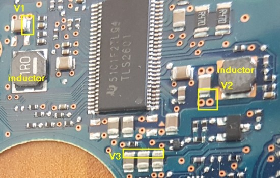

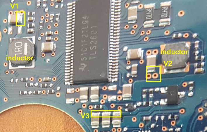

I would test the PCB off the drive. Measure the voltages (V1 - 3) at each of the two inductors (near the TLS2601 motor controller, and the transistor.

Dear friend! I accidentally found this topic on the forum, it's been quite a while...
i hope you answer me.
Topic-starter never answered your instruction - measure the voltage at points v1-v3.
I have exactly the same controller and I want to ask you:
What should be the voltage at points b1-b3?
Sincerely, I look forward to your reply.

v1- 0,89v
v2- 2,49v
v3 - 5,04v
 Post subject: Re: over powerd my board, help a numpty out
PostPosted: May 21st, 2023, 10:26
Joined: May 20th, 2023, 1:34
Posts: 8
Location: Kiev, UA
measurements were made without a hermetic block, on only a pcb
PostPosted: May 21st, 2023, 12:02
Posts: 17341
V1 and V2 appear to be consistent with a modern ARM Vcore and Vio.

It seems to me that I found the reason - this is a combi spindle driver and a magnetic head unit. (also this chip generates a voltage of 2.5 and 0.9 V?)
Chip output to the spindle motor - continuity - 0.78 ohm!
both among themselves and on a common ... Apparently, the output power switches burned out ...
I found a donor board, (all required numbers match)
I ask for advice:
Is it better for me to replace R2A30027 (TLS2601), or is it better to solder the BIOS chip (sop8)?
thanks

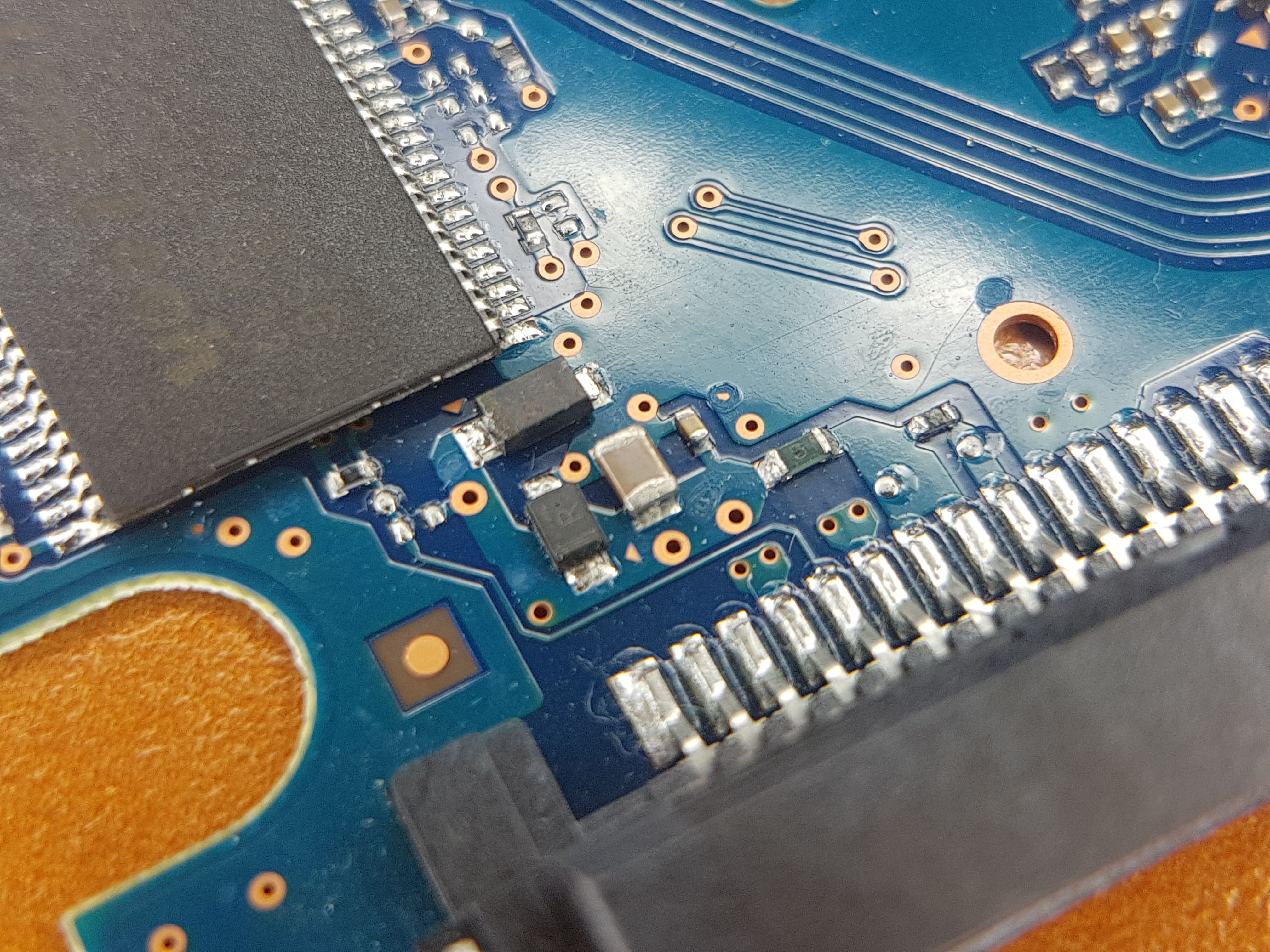

And I also have a question, for my general development :) :
what kind of chip marked 3260 qfn16?
I couldn't find a datasheet anywhere...

I think most people would recommend transferring the ROM ("BIOS chip"), but be aware that you must not damage this IC.
I don't recognise the "3260" IC, but sometimes these PCBs have a tri-axis accelerometer in that area. That said, your drive has a shock sensor and two rotational vibration sensors, so it would be unusual for it to have an additional accelerometer. But I could be wrong ...
In this PCB that location is unpopulated, which would be consistent with an optional accelerometer:
https://sep.turbifycdn.com/ay/yhst-14437584971410/91711095-6.gif
Also, the presence of all those passive components would suggest the IC has an an analogue section.
Digital accelerometers in 2.5" HDDs:
http://www.hddoracle.com/viewtopic.php?p=19497#p19497
