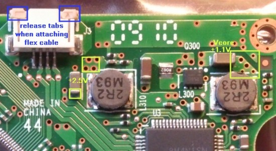

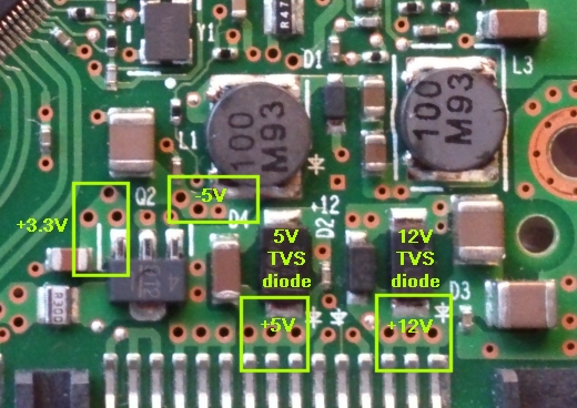

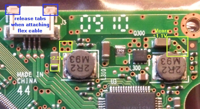

I have HDT721010SLA360 that is not identified by computer.
I have the same( I think correct) voltages like those on the pictures below. What should I check next?
Thank you for help

why do you think the problem is pcb related? Are you using the original pcb?

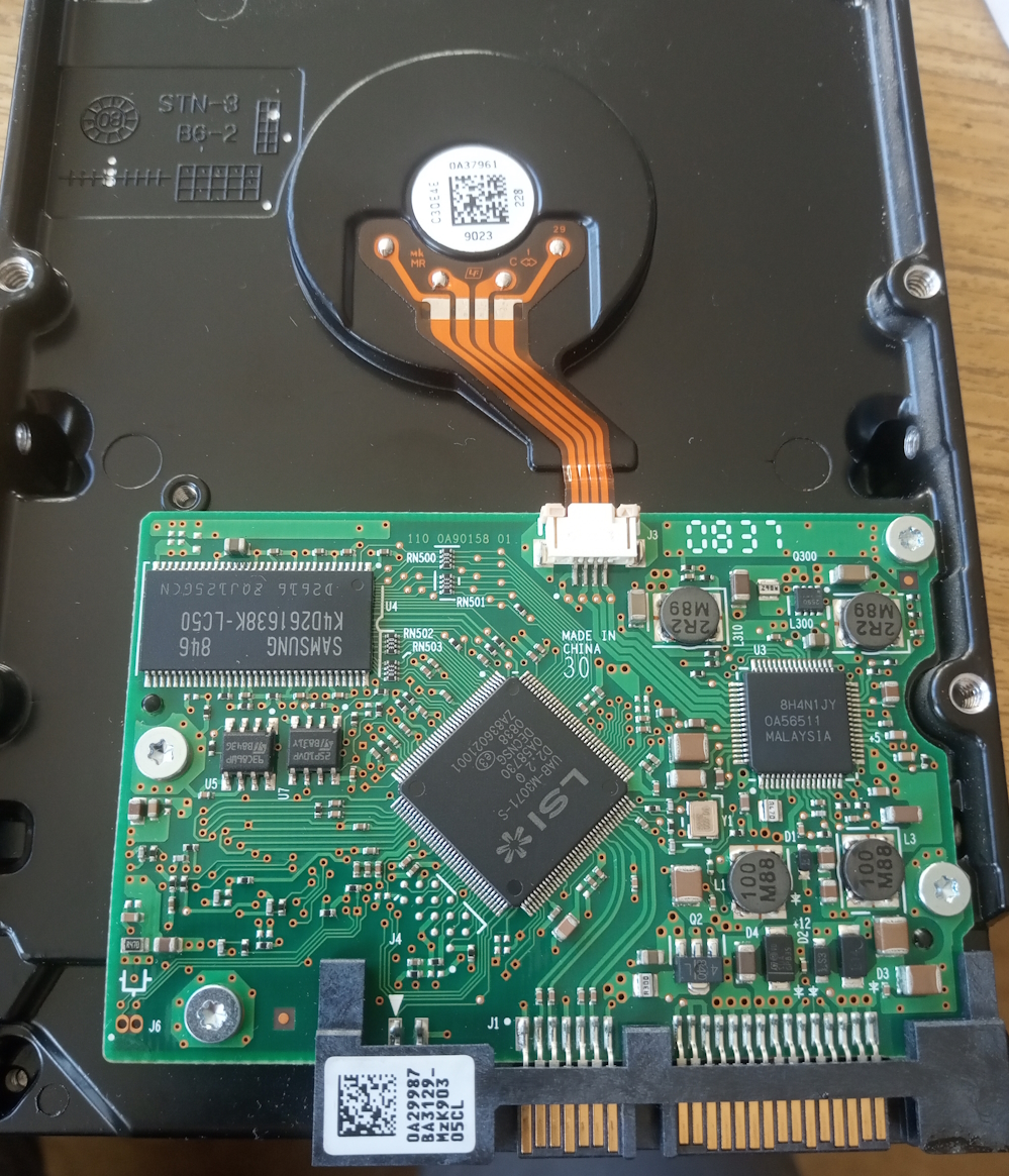

There are 4 traces( on the flex cable between PCB and motor). On which trace/path should I measure activity? And only during detection in BIOS should be there activity?
 Post subject: Re: HDT721010SLA360 - where a problem might be
PostPosted: October 23rd, 2023, 5:30
Posts: 4854
right after power on. If pcb is ok, there should be activity on all four pins at least for a few seconds after powerup. You should hear some buzzing sound as well.

I checked voltages on motor terminals but there was any voltage present (neither any sound hearing ).
Is it time for PCB replacement, eventhough the core voltages are present?
Or maybe there is an ENABLE pin somewhere which is missing or......
Any further idea?
Thank you

Can you dump the contents of U5 (93C86WP) and U7 (M25P10VP)?

I also find out there is about 3.3V Vcc on both U5 (93C86WP) and U7 (M25P10VP).
According to datasheet ,however, U5 (93C86WP) should have 5V as Vcc, not 3.3V.
Do you think it maybe the culprit? How to find out from where Vcc is coming to U5 (93C86WP)?
Thank you for help
